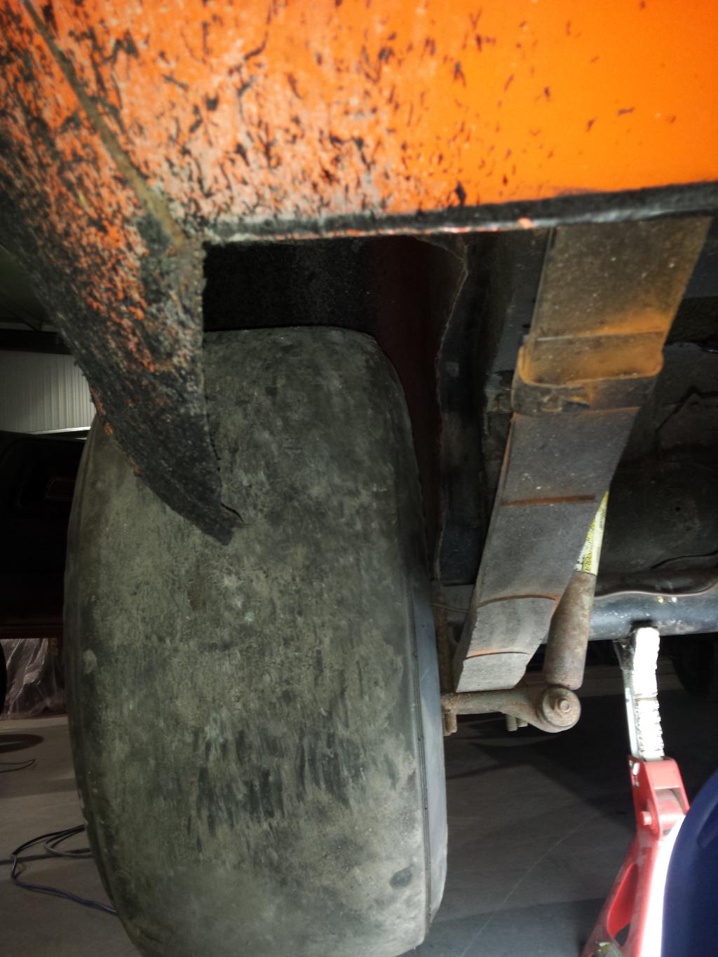

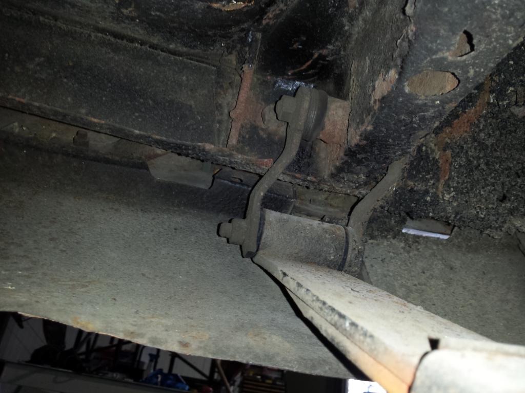

Bit more of a "Challenge" at the back as it already has wheel tubs full of rubber, so not got any firm ideas on what to do here.....
....answers on a post card, please..........
Offset Hangers.jpg (93.82 KiB) Viewed 1513 times
Challenger Tight Rubber 1.jpg (136.58 KiB) Viewed 1513 times
Challenger Rubber 1.jpg (124.69 KiB) Viewed 1513 times

Whats the challenge?.........buy new 29.5x10.5 slicks and some good double adjustable shocks and either run the SS springs or Caltracs. Duncan was only 2/10ths off on ET for the MPH with that set up, you wanna keep the car together as much as you can don't you?
Posts: 22109
The challenge is 7800 rpm and no space to put taller tyres on, so have to think a bit more creatively..............
