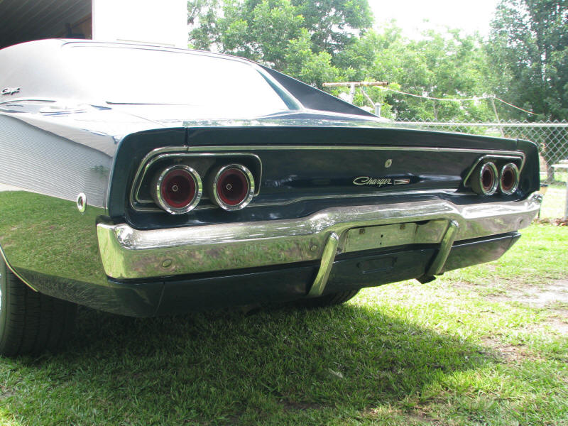

Back to the original subject, on my 68 Charger I used these lamps on the front without having to modify the side lights or wiring and they work really well.
Also use the same lamps on the rear in the reverse light position, just bought some new lamp holders with dual contacts, added the two extra wires through from the turn signal indicator, disabled the turn feed to the break lights and all works well. So I still have working reverse lights and turn indicators all in one.
When these lamps get feeds to both the white and the amber, they just flash alternately between the two. on indication they just flash amber of course.
The LED are of the new type, so very bright, seems like a nice solution, that involves the least amount of modification from original.
But I have not had the car out in the sunshine yet to see if the rear ones are bright enough, still rebuilding front suspension :(

Glen63 wrote:Back to the original subject, on my 68 Charger I used these lamps on the front without having to modify the side lights or wiring and they work really well.
http://www.ebay.co.uk/itm/White-Yellow- ... 5d50e550ba
Do your indicators still flash ok? There's a thread on DC.com regarding the same thing, it states that the indicator flashing relay had to be changed for a no load flashing module for use with led's, to allow them to flash correctly.

Yes I changed the flasher unit to one compatible with LED lamps as well.
Changed it to this one http://www.ebay.com/itm/ELECTRONIC-FLAS ... 1282905870

I used the reversing lights for indicators on my Dart, but the reversing lights are very close together on the Charger ?

Not sure what you mean, on a 68 Charger they are either side just above the stop lights.
