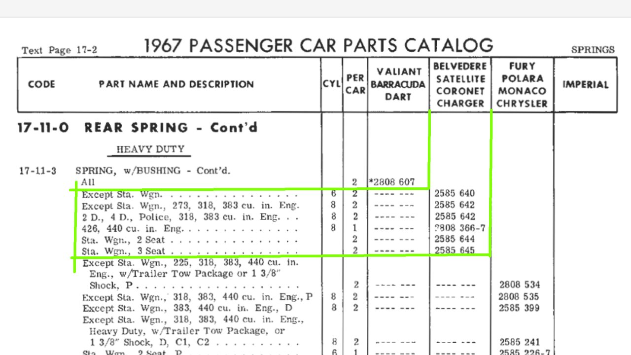

Does anyone know if the 66/67 Charger/Coronet uses the same spring as the 68-70? Classic industries have an ok price on the clip and shims set

XP29 wrote:Does anyone know if the 66/67 Charger/Coronet uses the same spring as the 68-70? Classic industries have an ok price on the clip and shims set
http://www.classicindustries.com/produc ... n7007.html
I would have thought so , but looking at the parts manual , they are not
see below ,
ive had a look at a few parts places in the US & none seem list the clamp & inter liner kit for 67 & earlier cars , :?
no offence , don't know much about this year , maybe measure your originals & if someone can measure their second generation 383 springs so compare ,

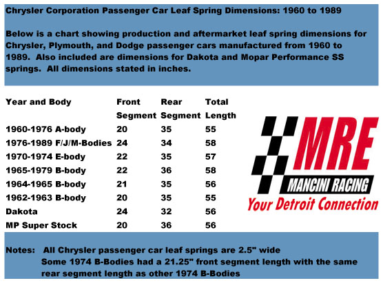

something else I come across the other day ,
http://www.manciniracing.com/chlespdi.html
Thank you guys for your help, it's always appreciated :)
This is where I have been getting confused. When I looked at Summit, springs for 66, 67, 68, 69, 70 (I didn't look any further) Charger all have the same part number. But to rebuild a spring they only sell 68-70 kits!
Anyway, the more I looked at my springs, the more I'd been thinking the main leaf is maybe too far gone for re tempering. The way they are bending over the 2nd leaf has me questioning how good they would hold up. So I found a place called Epso and ordered a pair of heavy duty springs with 1" lift. My thought with this is they are bound to settle in time so I'm hoping I'll end up at the height I want. Failing that it's going to look like a 70's Hotwheels toy. If they end up no good I can always have my originals re done later on. I've not found any negative comments on the company or the springs. They say they match a pair up rather than just pull them off the shelf. They were $553 for pair, Ubolts/nuts, front eye bolts/nuts. Front bush is already fitted, including delivery. They were here in a week!
