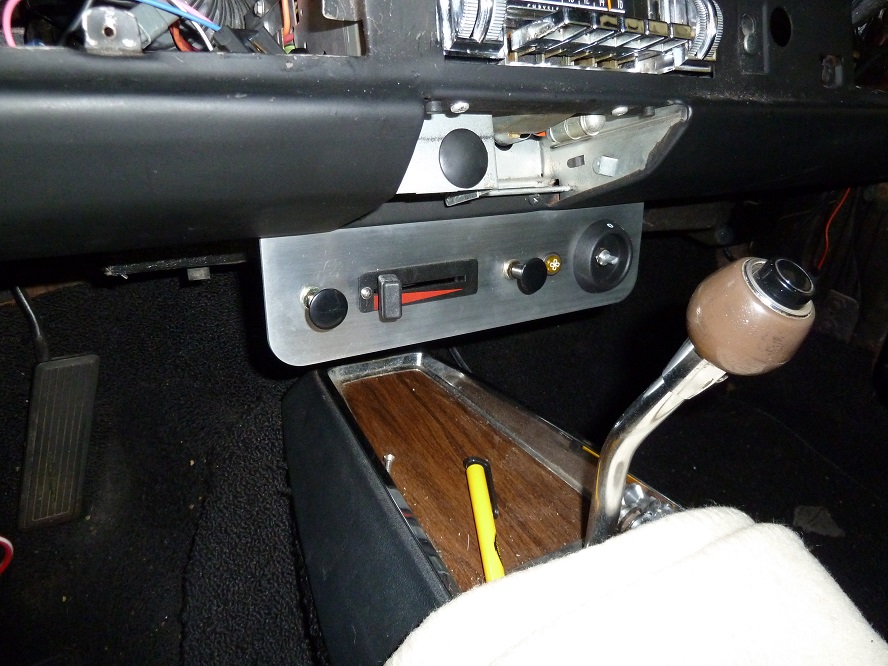

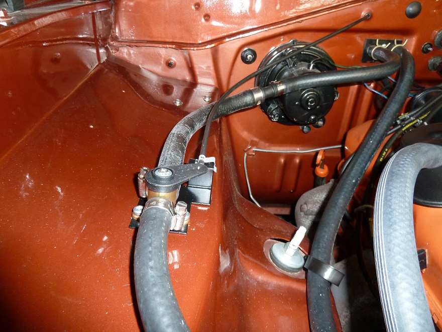

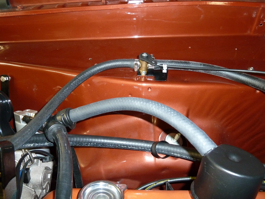

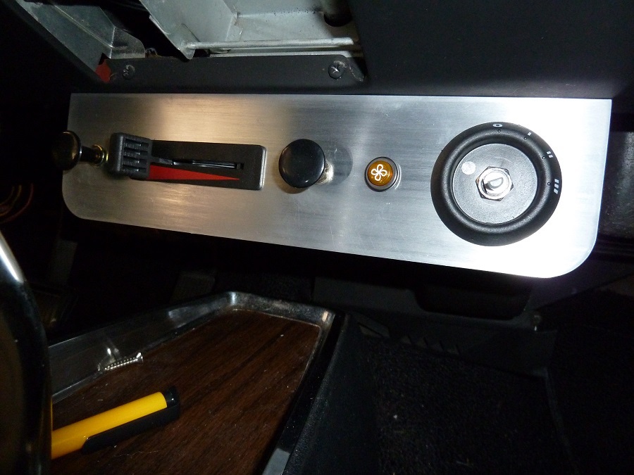

Originally my 70 Duster 340 was also an air-con car and the air con pump was removed during the resto meaning a non-functioning heater system.
I have discarded the vacuum pipes and built a manual heater system, yet to be fully tested!!
I fitted a manual slide control to a heater valve in the engine bay so that the water could be turned off the summer, fitted a rotary fan switch that has the various coils mounted on the back of the switch and used push-pull cables to activate the heater door within the heater/aircon box and to regulate the heat to screen or interior.
The photos give an idea on the set up:
