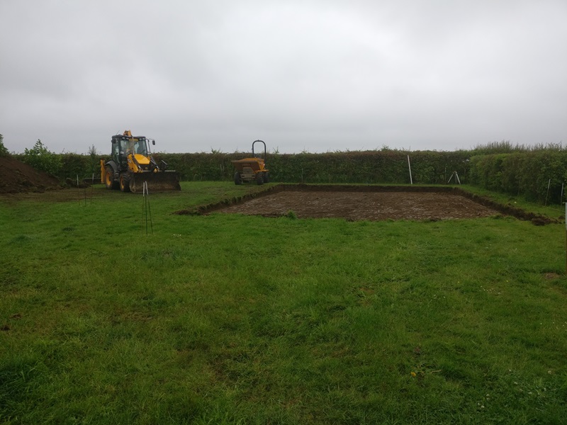

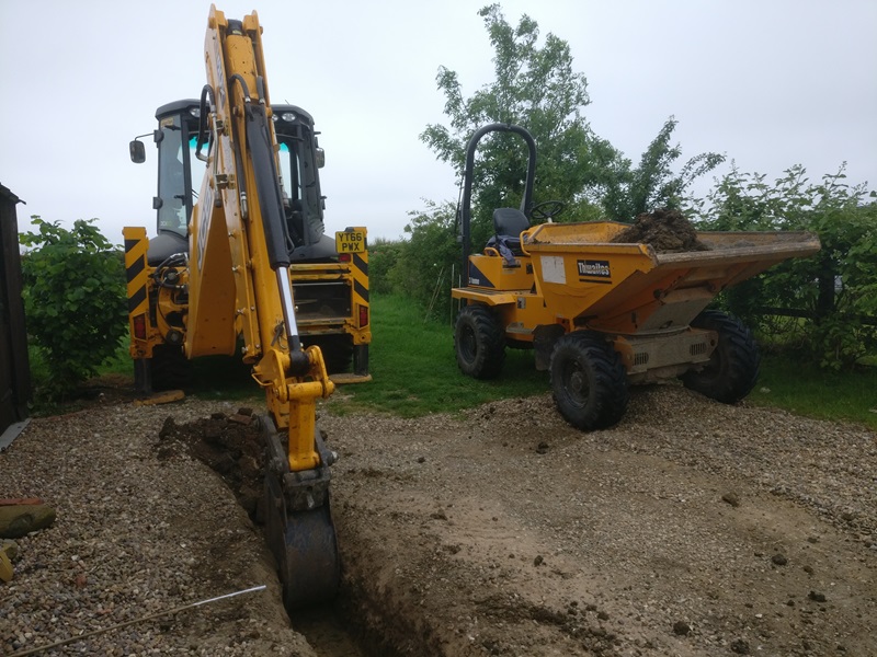

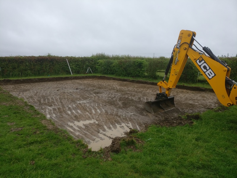

Work started today.
Moved the soakaway which was under where the new drive will be.

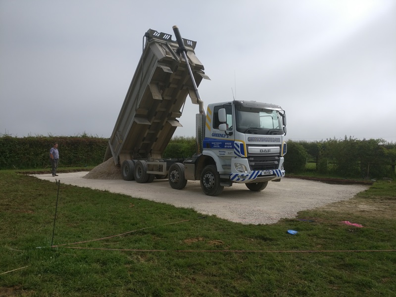

Plans from my engineer show 850 mm of type 1 required (eek).
That's 240 tonnes, or to help those like me who like to quantify things, twelve mostly full 8 wheel fixed 21 tonne dumper trucks.
in other words a s*it tonne of hardcore.
Tomorrow this continues.

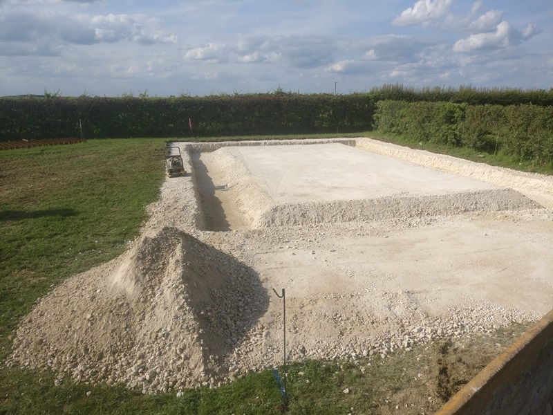

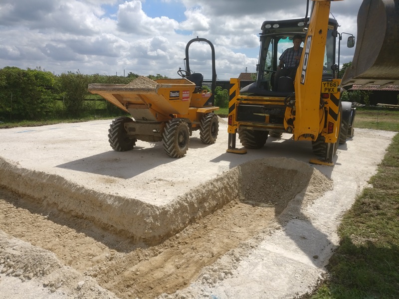

We needed 260 tonnes in the end.
All ready for DPM and then shuttering then 35m cubed of concrete.

Can you explain what the cream gravel does and why you've dug a moat around the perimeter?
Genuinely interested - I just have no idea how a building goes together! :oops:
-Jon.
andyrob
Posts: 4145
Location: northumberland
Post by andyrob »
I guess the 'moet' is for the foundations and the cream gravel is dolamite
