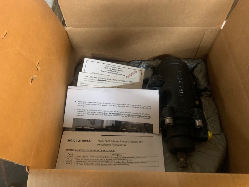

My review is good
The unit does what it says on the tin and really happy.
It’s lighter than I was expecting which is great as I love my PS
With no play I now feel I have more confidence to drive it quicker.
Great upgrade should have done it in the beginning

Re: Firmfeel steering ?
I cant believe you managed that 'in situ' ! Well done.
My rebuilt steering box is super light now but I wouldnt say the feel is any better. Good move i think.
