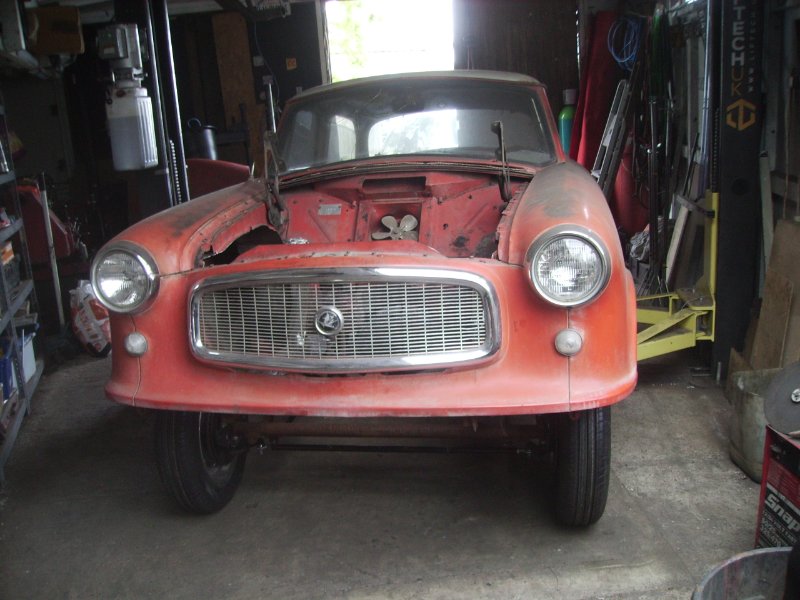

both sides are now done and the wheels fitted so it could be lowered to the ground for pics. it'll be lower once the engine and box etc are in but i'm happy with it.
neil.

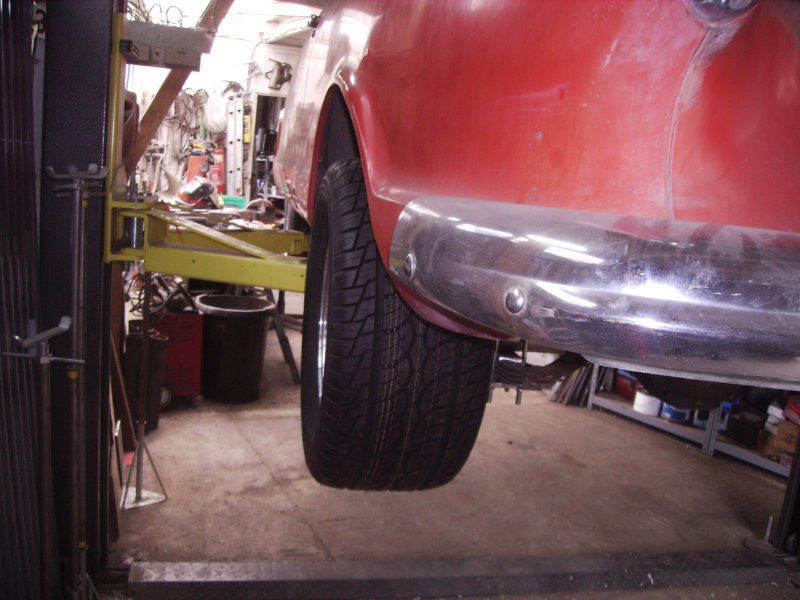

i forgot to mockup a rear wheel yesterday so......
looks like the arches may be clear with a bit of luck.
neil.

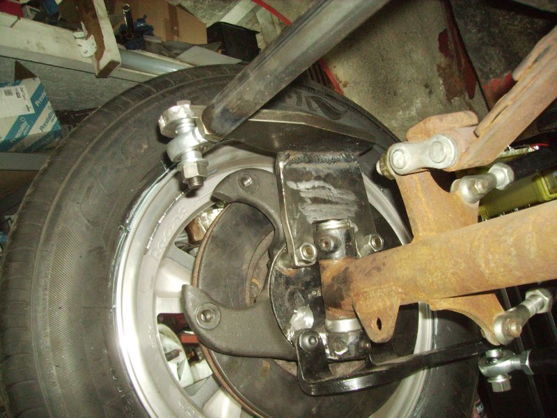

today we started to figure out where the steering box was going to go along with it's 'paired' steering arm on the other side upright. the box is now about where it needs to be and the cad steering arm is mocked up so it clears the brake caliper.
neil.

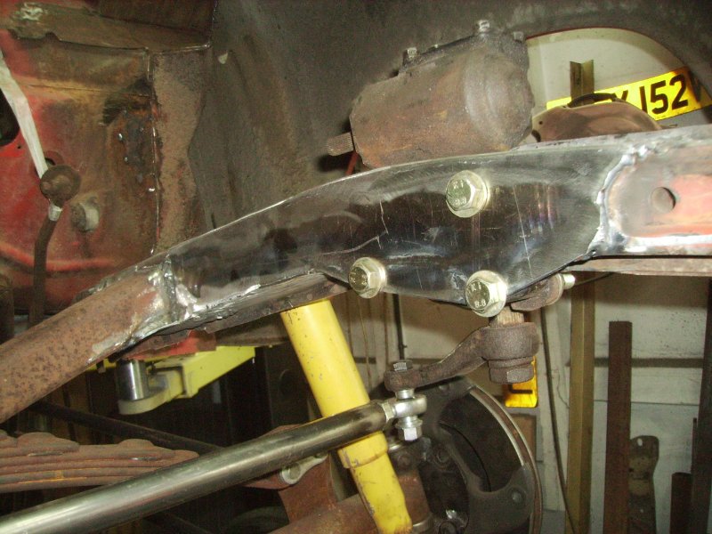

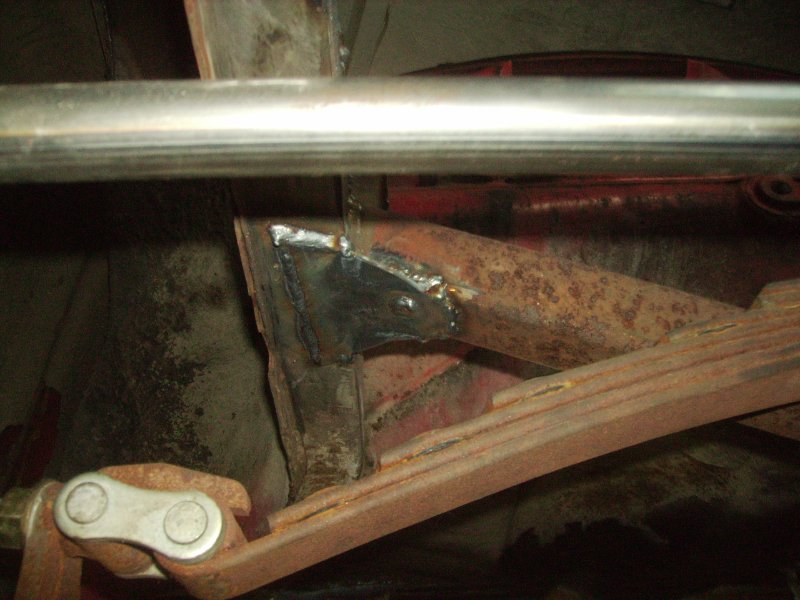

the steering box is now fitted and the drag link adjusted to give even lock left and right. we also seam welded the top of the chassis rails and added the bracing plates from under the chassis to under the front crossmember.
rear axle is next so it's on all 4 wheels then engine and box mockup. it's coming along.
neil.

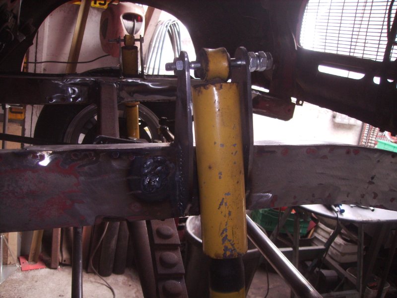

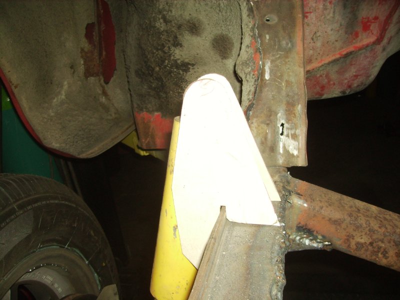

it occurred to me last night that it'd handle much better and be lots less 'uncle buck' if it had shock absorbers on the front. so with a pair of new-ish cortina rear shocks from a kit car offered up it was time for more cad work. oh, and the steering arm needing a little trim to clear on full lock, lol.
neil.

before making the shock brackets (although they're marked out on the steel sheet, lol) i decided the chassis where the steering box mounted wasn't as strong as i'd like. there was a slight twist if you pushed the wheels lock to lock as they stopped each way, not good enough. so we did yet more cad work (we're getting good at this techy stuff) and cut 3mm thick over plates on top from behind the now crossmember all the way to the bumper bolt holes and on the inner sides from the crossmember agin forward to the bumper bolt holes. the drivers side we shaped the side plate to include the 2 tubes that are under the chassis. bit of a grind up and refit the box and what a difference. i'd considered adding another crossmember in front of the box but it's not needed now. shock mounts next, honest.
neil.
nearly forgot we cut the last bit of inner wings out too so the steering column can route neatly.

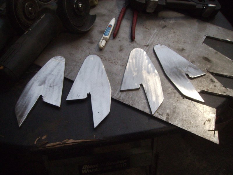

the shock brackets are all cut and ground. we clemp them all together for grinding so they're all the same. they're now ready to weld in place once their bolt holes are drilled.
neil.

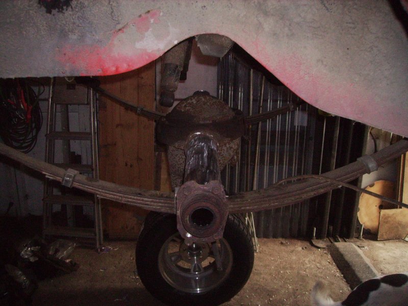

the axle is now bolted to the springs, after we made the lower u bolt plates. it's just clamped tight at the moment, we'll leave setting the pinion angle until the engine and box are mounted. the halfshaf6ts are just slid in for now too as they'll come out to fit the now oils seals in the casing ends. couldn't resist a look how far (if at all) they stick out. well shock horror, if the arch lips are rolled they'll go under...... just.
neil.
