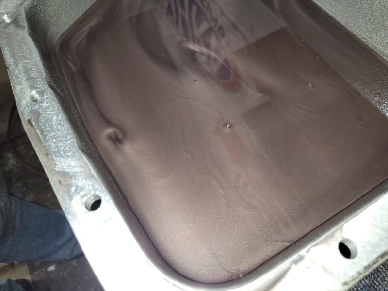

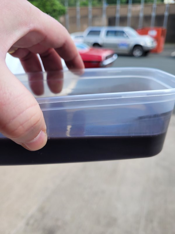

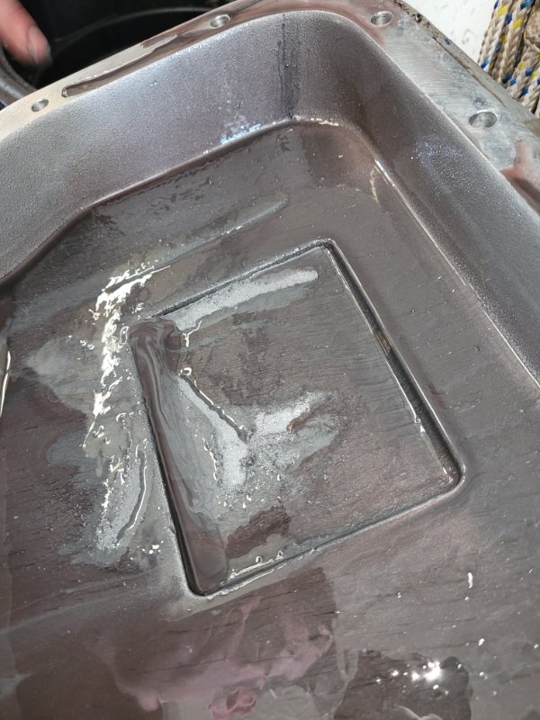

Out in the sunlight, we had a look at the trans oil........oh, not good.
Redy/Purple in colour and full on metal flake.

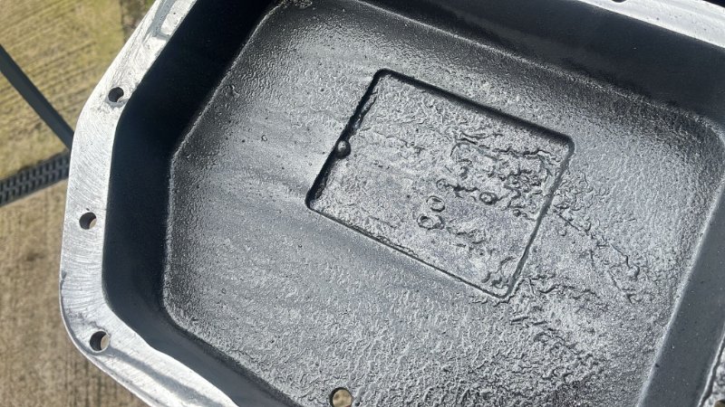

On the lift and off comes the sump.
Checked everything over and drove the car to the pub.
No drama thankfully and a decent pint to boot.
On the way back, gave it some up a local bypass, cue the smoke show. Only 10 miles left, so limped it home using light throttle and slow cruise.
Sack of Bananarama!, hate the bloody thing. Back it goes for another 4 months in solitary confinement.
It's gotta go back to Jims to investigate.
Well that happened three weeks ago, via trailer.

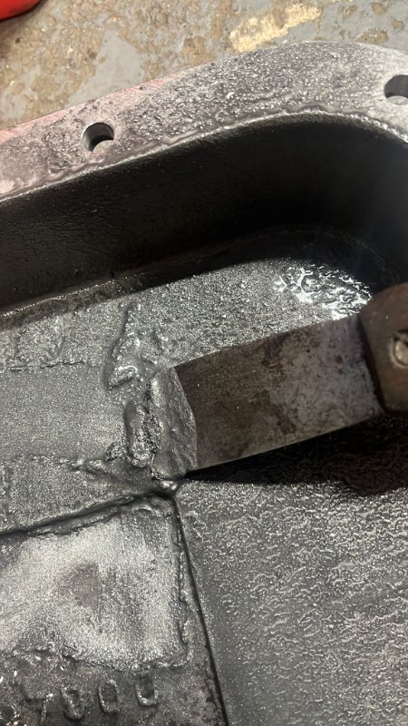

Re: Dave's 72 Dart
At this point, my suspected front seal leak, had now grown arms, legs and heads.
- 20240525_134727.jpg (144.95 KiB) Viewed 9163 times
- 20240525_131838.jpg (79.63 KiB) Viewed 9163 times

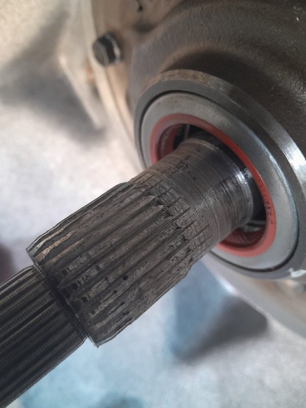

Re: Dave's 72 Dart
The amount of metal in the sump put it into full rebuild territory.
Keep in mind this was built around 2000 miles ago with uprated parts.
Gutted and already broke was not a good combo.

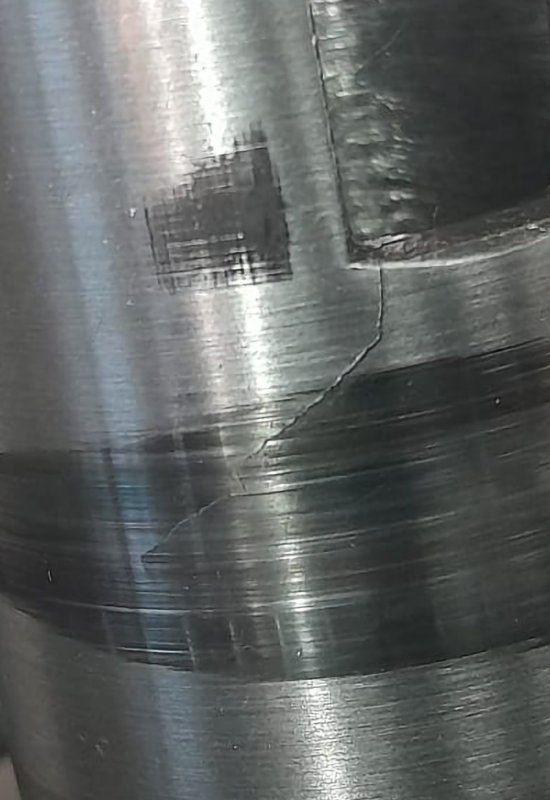

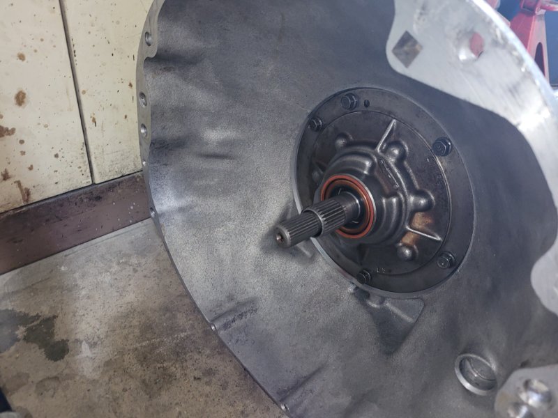

After droppind the pan, we pulled the converter to see if we could identify the leak point.
The front seal was fine, but after looking at the splines on box, it became apparent something wasn't right.
We then had a look at the converter as bar that, the front seal looked good.
Didn't expect to find this.

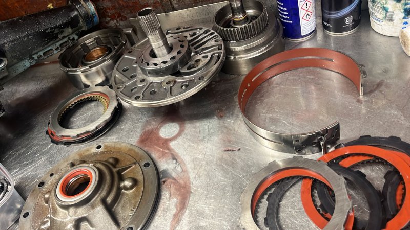

Re: Dave's 72 Dart
Guess we found the leak point.
Trans was delivered to Duncan for a complete strip down and rebuild.

Re: Dave's 72 Dart

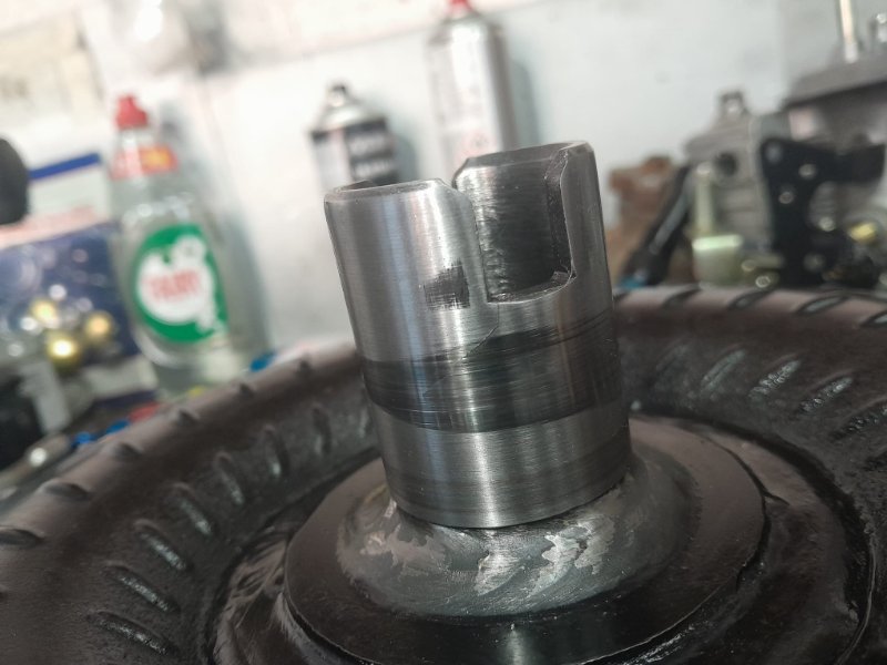

Amazingly after two weeks and various calls it appears that the 300 miles I did on the car didn't kill the trans.
Everything was good to reuse after a good clean, no damage to clutches or bands etc. Only the valve body had slight scoring on the surface, but nothing that should cause an issue.
So this leads to the only thing that could have contaminated the oil being the converter.
This will be split open in the next few weeks, I will post the outcome. To say I'm u happy with ACC and their Boss Hogg line is an understatement.

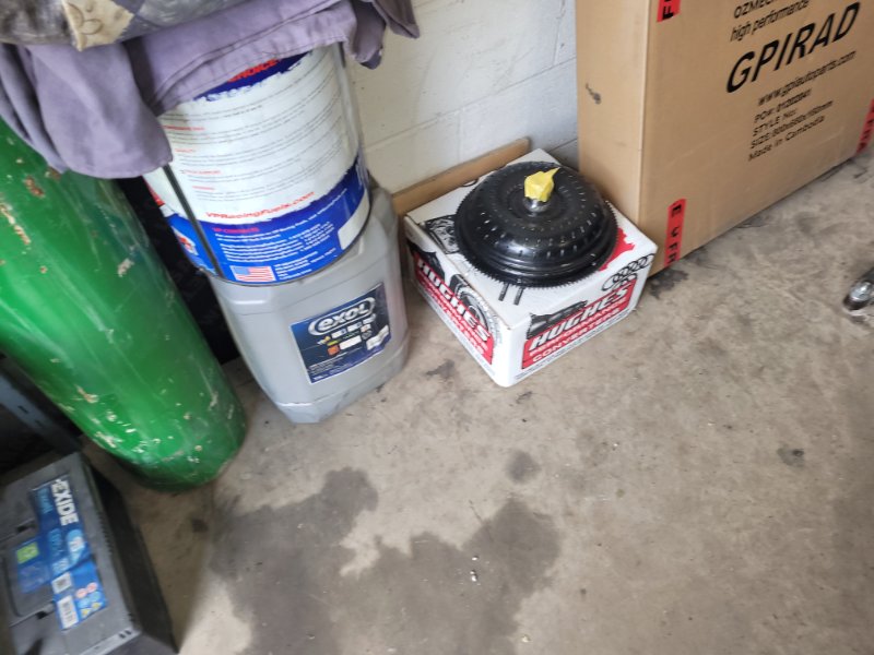

After a very expensive engine build last year, I opted to go with ACC to save £250 over the Hughes converted I actually wanted.
Well, that has now cost me well over £2k.
I've also had to dump all the teflon braided line and the mocal oil cooler, as their is no way you could clean it sufficiently. The AN fittings have been break cleaned and flushed.

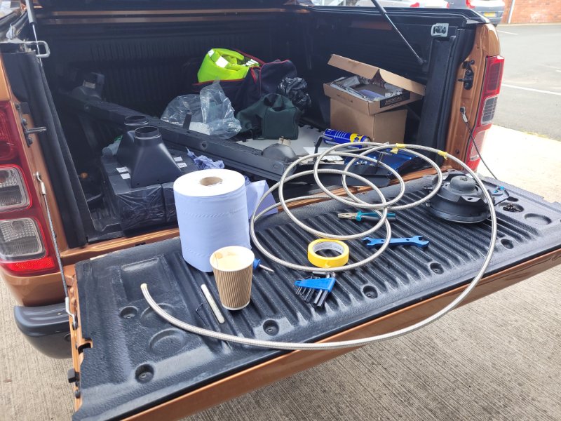

Re: Dave's 72 Dart

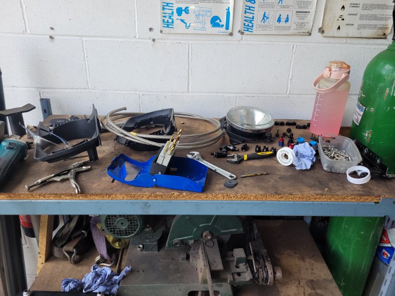

Today, I was Jims apprentice.
Decided to go over to his and sepnd a few hours replacing all the lines and cooler, so he only has to install the trans and converter.
I forgot how fun these cars are. A few hours turned into 8.
- 20240621_152450.jpg (166.86 KiB) Viewed 9152 times
- 20240621_152504.jpg (152.22 KiB) Viewed 9152 times
- 20240621_152508.jpg (121.56 KiB) Viewed 9152 times
- 20240621_152518.jpg (116.37 KiB) Viewed 9152 times
- 20240621_152531.jpg (172.8 KiB) Viewed 9152 times

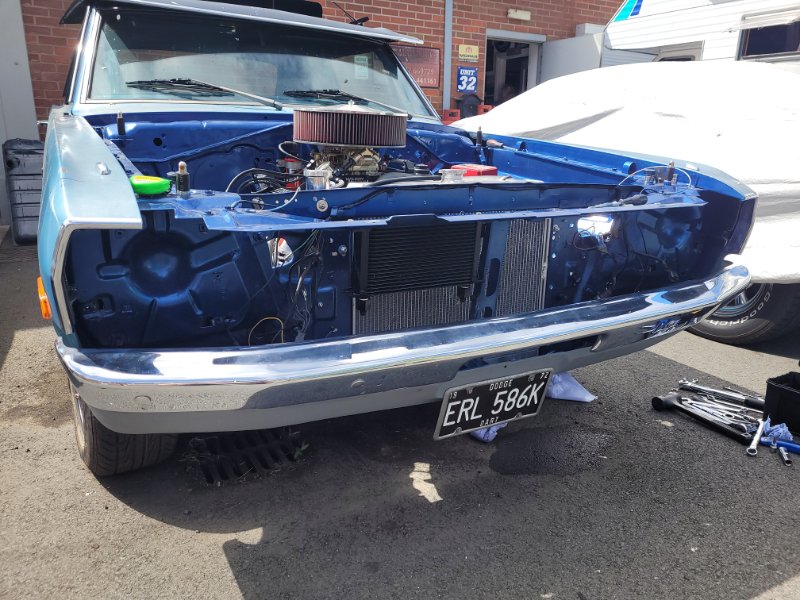

Re: Dave's 72 Dart
Took the opportunity to upgrade the cooler for a bigger surface area version and to relocate it up away from the radiator.
Duncan recons the converter was slipping constantly, so a potential reason for the car running warm, feeling 'off' sometimes and just not putting the horses down I was expecting for a 390 build.
So, another race to get the car sorted and back together before the next NSS race at Dragstalgia. Fingers crossed.
Oh, and after last year, that was my last to drag and drive with the car.
It's just not an enjoyable journey, so the Alfa went in April to be replaced with a pickup that can pull in comfort to Santa Pod in the coming years. The Dart is the only reason that I ended up with a pickup, so I'm classing it as another expensive mod.
If anything happens now, it's in the garage for 12 months.

Still to cut it open, so will post what I find when it's done.
Needed to wait to see of Chris G wanted it back to review himself, but he has left it with me, so will ask Jim to cut it.

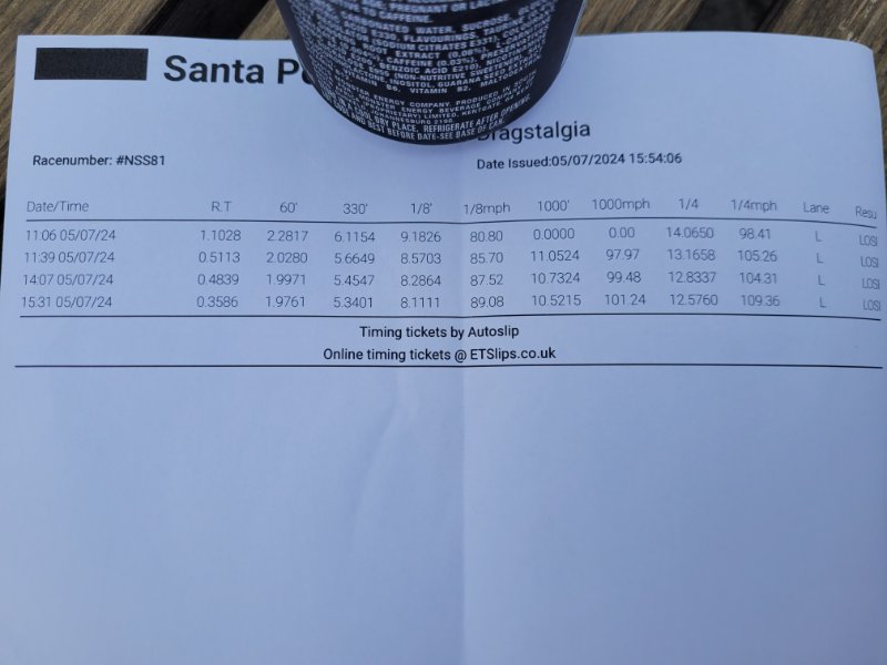

Re: Dave's 72 Dart
For anyone that enjoyed the delights of Dragstalgia 2024, the weather played games throughout the whole of Saturday.
Four qualifiers became one, with the Santa pod crew trying to find a dry spell for all the other classes, so I opted to go safe at 12.5 dial in.
Didn't expect the weather and cooler air would help and went and broke out drastically whilst sleeping on the light.
Was quite happy at the breakout number though, hitting 12.19 @ 111.
This put me up against Don Scott for my first ever elimination.
Nothing like starting easy......
