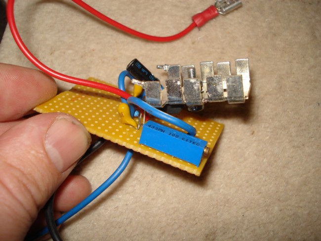

Better not seal it up in anything just yet as I might need to make another one to run alongside it depending on what I hook up to it. This thing will only run 1.5 amps without getting too hot.

Nah, the original and best, here's my 5v regulator I built a few months agoDave wrote:There is probably a better product to use these days for all I know but that is what I used to use in the late 70s to mid 80s which was the last time I made anything like this.

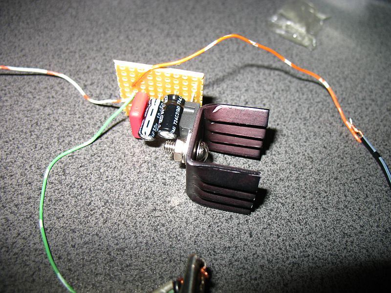

I was thinking of mounting it where the ballast resistor is because I don't need a ballast resistor any more and it will require just a short(ish) length of hose to run to the carb base. The 5v regulator I will mount either under the dash somewhere or behind my electrical board where the battery used to be. I have not decided yet. I only have to worry about losses in the cable from the sensor to the LM-1 meter.Dave999 wrote:if you find a nice bulkhead connector for taking your MAP signal from the manifold through to your box of electroniccy bits let me know
