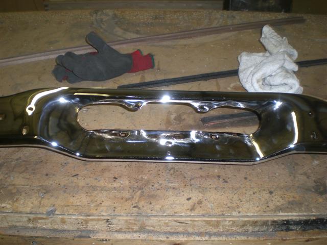

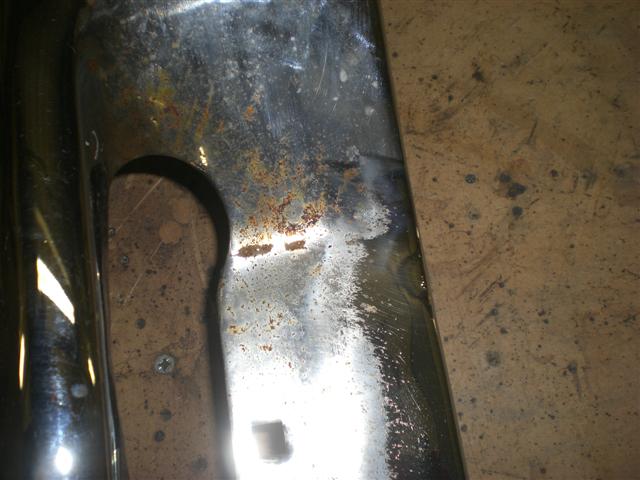

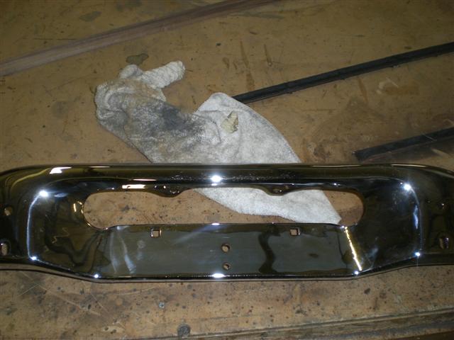

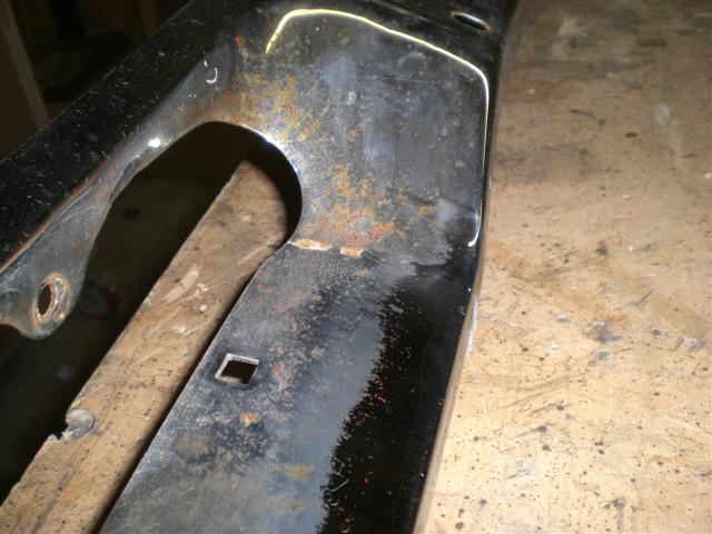

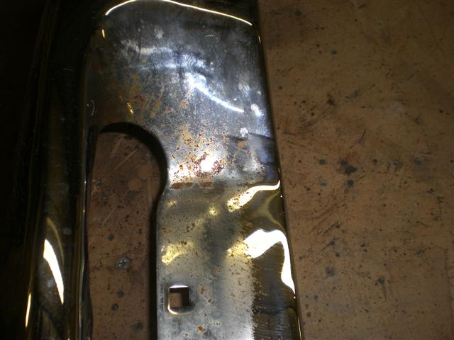

I spent a bit of time tiding up my rear bumper this morning as there was a lot of rust around the number plate area and the quote I got to re-chrome it was between £250 and £300 and I just can't justify that at the moment so I polished it up and i am amazed at the results.
Final Polish And it is as good as it gets without re-chroming.
CIMG8529 (Small).JPG (49.37 KiB) Viewed 1373 times
CIMG8528 (Small).JPG (57.52 KiB) Viewed 1373 times
YOu can see the samll bit to the edge where I started polishing and you can see how much dirt and rust is there.

Charger wrote:great stuff, looks good enough to me :thumbright:
what polish did you use??
The big electric one on the previous page with proper polishing soap (different grades) and different grade mops. i have re-polished all the chrome and stainless trim this way and it has made a big difference.
Posts: 13000
I did exactly the same on my RR bumpers, they were so enormous, I knew the chroming bill was going to be close on a grand by my reckoning, so did exactly the same as you Anton, using an air powered mop and a range of compounds..the results were nearly as good as yours!
Would you use Autosol......?
My bumpers dont look to disimilar to yours regarding their current state!
ANTON
Posts: 2046
Location: Sutton,Surrey
Post by ANTON »
Dave81 wrote:Would you use Autosol......?
Buy hand you just can't rub fast enough to get the same finish as a proper grinder style polishing mop set up. Autosol is good if you want to polish ali as that is a soft material but if you try and use it on chrome (very hard) by hand you will be there all day and as it is quite coarse you could end up with fine scratches. If you want to do your you can use a car polishing mop on a big grinder and use car polish like G3.

ANTON
Posts: 2046
Post by ANTON »
VGVIP
My compressor motor that I used to make my polisher spins at 3000 rpm but is a 2.2kwt (normal bench grinders are between 300 and 500 watt so mine is 4 or 5 times more powerful) motor so i can put alot of force on the motor to generate the heat need to polished quickly and the motor won't stop. I have 8inch mops and 6inch mops to get into awkward areas. I try to sand as little as i can because it can be hard to remove the scratches. I generally use the coarse mop to get any scratches out and any dirty/paint off the piece and the slowly go to finner mops till I am at the finest mop with the finest soap. If you want and even better finish I use G3 polishing compound on the finest mop but that can be very messy.
Whet I start my own business I will offer the service of polishing chrome and stainless trim and I will also removed dents and straighten bent trim as I have just done with one of mine.

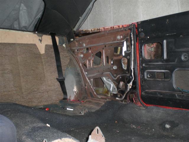

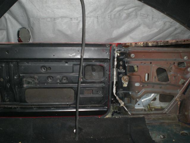

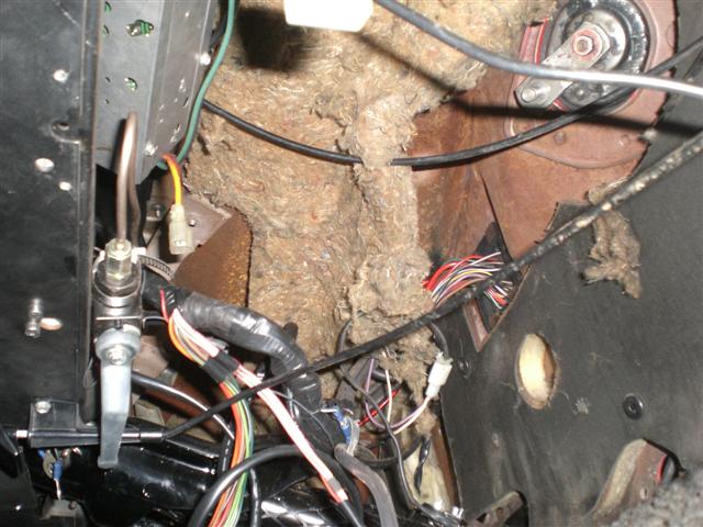

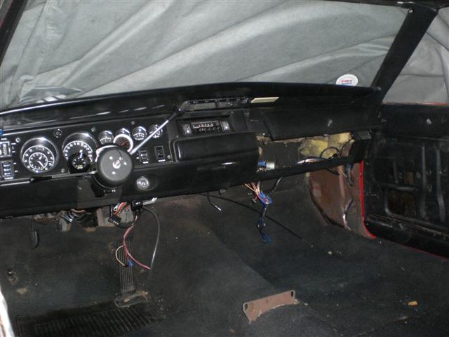

I went to the garage this morning and stripped the rest of the interior out so I could get the rest of the stainless steel trims off so i can polish them.
I also plan to put my new carpet in so i need to get the old one out and clean and paint the floor. I will also be replacing the firewall and under dash insulation after I have cleaned and painted. I have also move my charger from the large garage I had a work to a much smaller one very close to home. I have a lot less space but and can get there more to do more work. It used to take 45 minutes to get to work to work on my can now I can walk there.
See what a mess the insulation is in
CIMG8536 (Small).JPG (67.38 KiB) Viewed 1232 times
CIMG8535 (Small).JPG (51.93 KiB) Viewed 1232 times
CIMG8533 (Small).JPG (48.92 KiB) Viewed 1232 times
CIMG8531 (Small).JPG (45.62 KiB) Viewed 1232 times

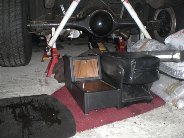

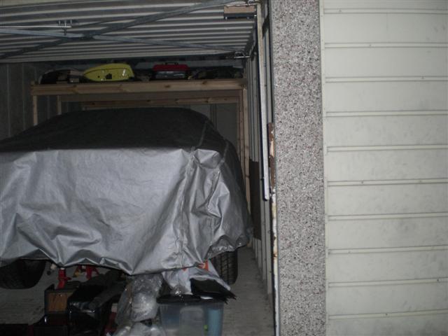

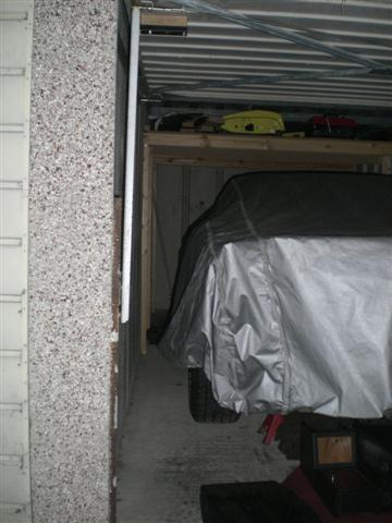

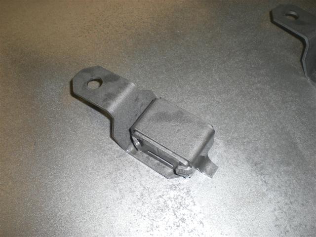

I also got my new exhaust tip hangers in the post yesterday and because the are bare steel I decided to paint them before I install them.
This is how limited I am for space in my new garage. I can just get in the car. This make it a bit challenging to work to say the least.
Storing All the bits
CIMG8540 (Small).JPG (55.2 KiB) Viewed 1217 times
Passenger Side
Passenger Side
CIMG8539 (Small).JPG (47.37 KiB) Viewed 1217 times
Drivers Side
Drivers Side
CIMG8537 (Small).JPG (36.56 KiB) Viewed 1217 times
CIMG8552 (Small).JPG (52.96 KiB) Viewed 1217 times

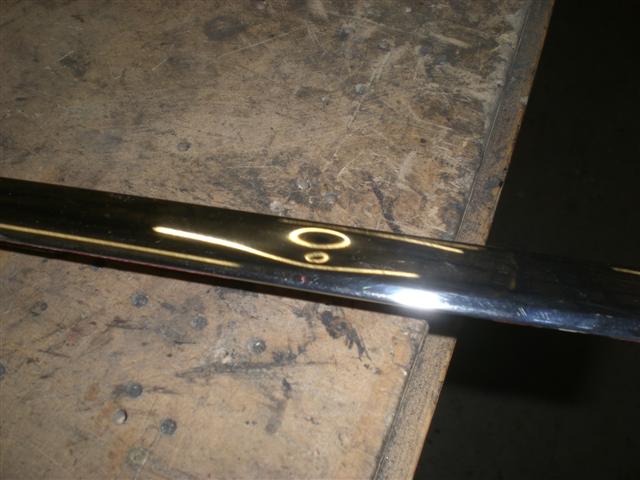

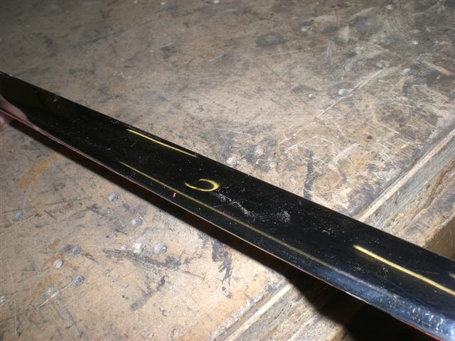

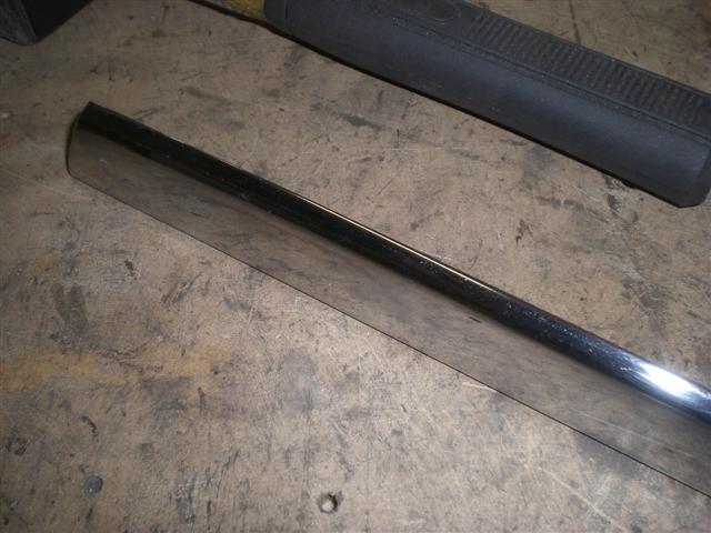

The reason I took off the rear trims I had a dent in one that has annoyed me ever since I brought the car so now that it is off I can fix it.
Dent knocked out and now I need to sand and polish it for a perfect finish
CIMG8550 (Small).JPG (52.82 KiB) Viewed 1184 times

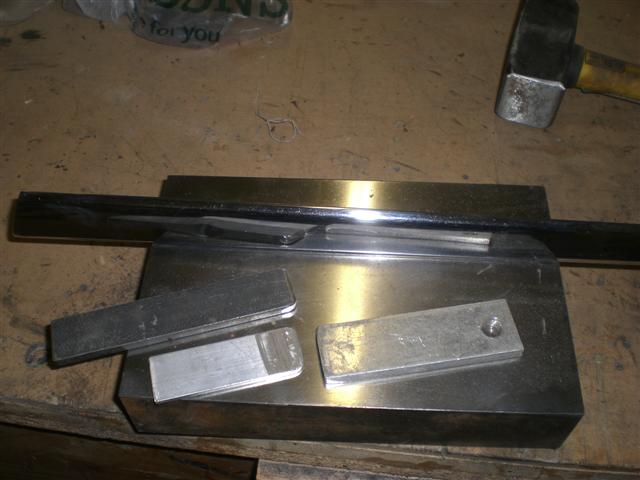

My dent removal tools. Solid flat steel table and some home made drifts out of steel and ali
CIMG8549 (Small).JPG (44.32 KiB) Viewed 1184 times
CIMG8542 (Small).JPG (63.02 KiB) Viewed 1184 times
CIMG8541 (Small).JPG (47.74 KiB) Viewed 1184 times
