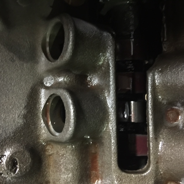

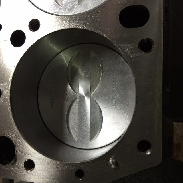

Well that's not your feet visible through those bores Andy :D
Is that a new block, looks very clean, unused..

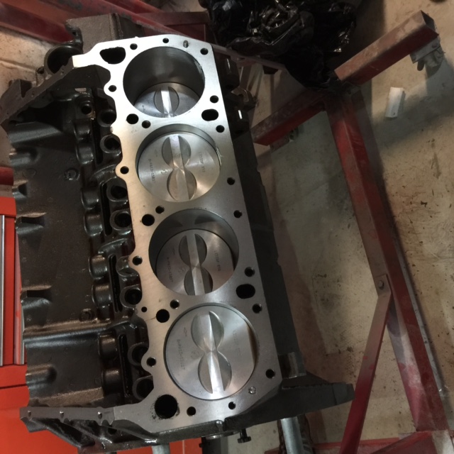

block
Post by JC »
I am putting it together all original matching numbers happy days.

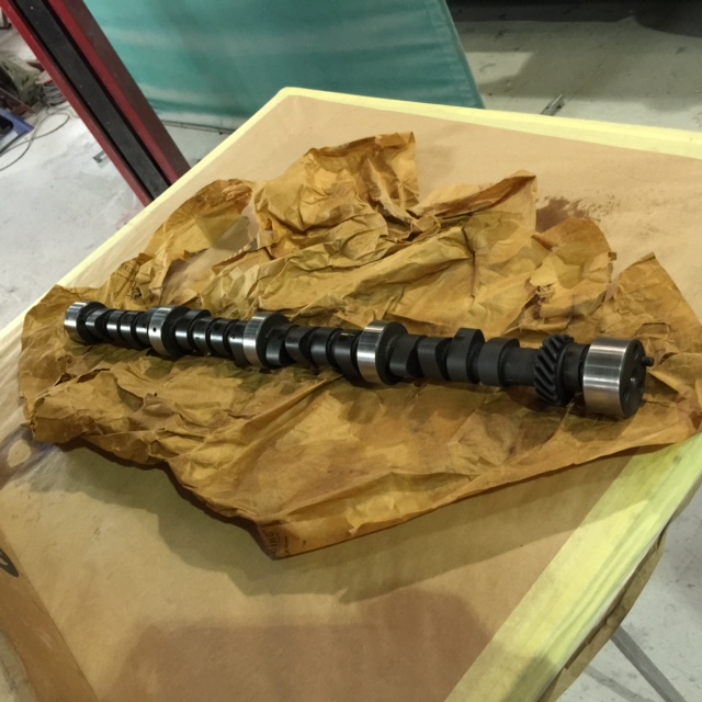

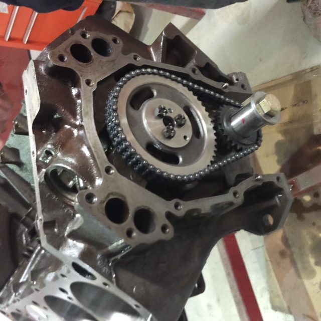

Thanks for the update Andy :thumbright:
Should there not be a lock tab on those cam bolts ?

mopar_mark wrote:Thanks for the update Andy :thumbright:
No lock tab, best to use Loctite though.
Posts: 4697
[quote..... Should there not be a lock tab on those cam bolts ?[/quote]
Answer me one question.....if the cam is rotating clockwise, and the bolts are turned in clockwise is it possible for the cam bolts to unscrew??????
As far as I know (and who am I ) a lock tab was only fitted to the single bolt cam :roll: :read2: :roll: :read2: :roll: :read2:
R.RUNNER wrote:[quote..... Should there not be a lock tab on those cam bolts ?
:P :P :P[/quote]
no lock tab on any 440 cam,,etc the odd aftermarket cams supply one but use for a roller,
Posts: 4697
Workshop manual shows a tab on the 440 4bbl cam bolt :read2: :read2: :read2:
Posts: 4697
ooooppppssss :oops: :oops: :oops:
