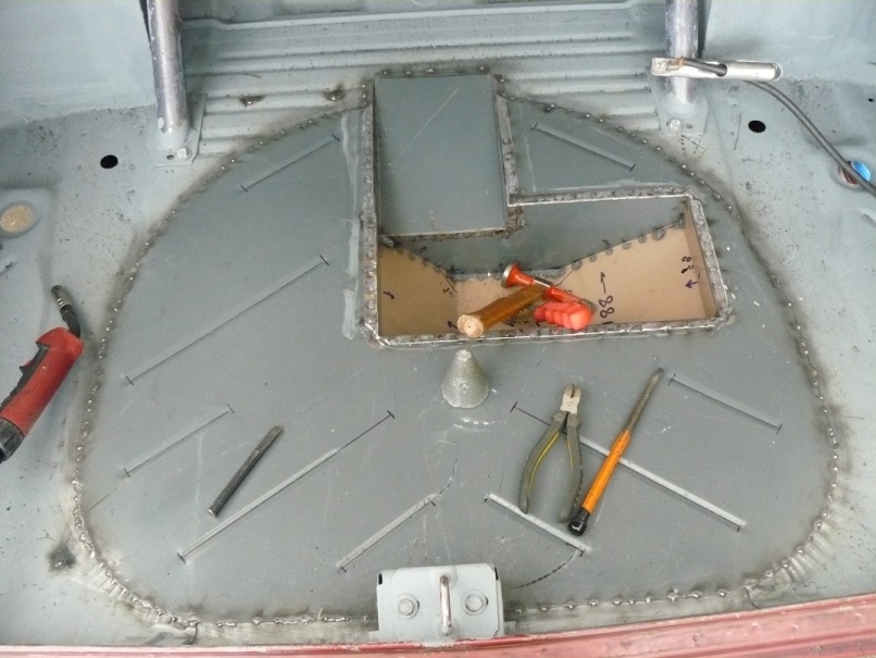

WELDING DONE HOORAY
It's come out much better than i'd hoped, kinda looks like it's always been there...

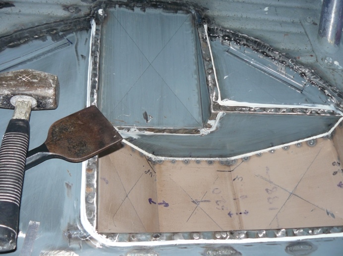

I tacked it all the way round, bit by bit so it didn't distort.
Once secure, i fully welded inside and out so it's super-strong and then made a 1" box brace which i stitched across between the frame rails.

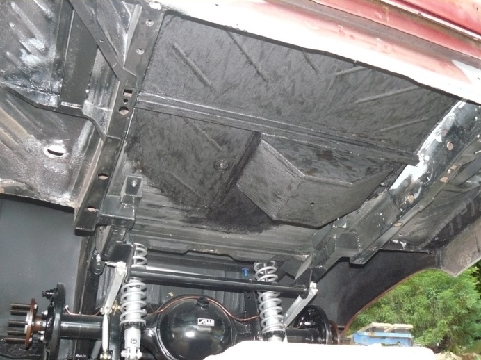

To make the sump a bit stronger and look better i drew an X on each face and whacked it with a bolster, making a nice 'pyramid' effect. I also drilled a drain hole in the bottom.
Bit o' seam sealer, a slap of underseal and it's all done!
