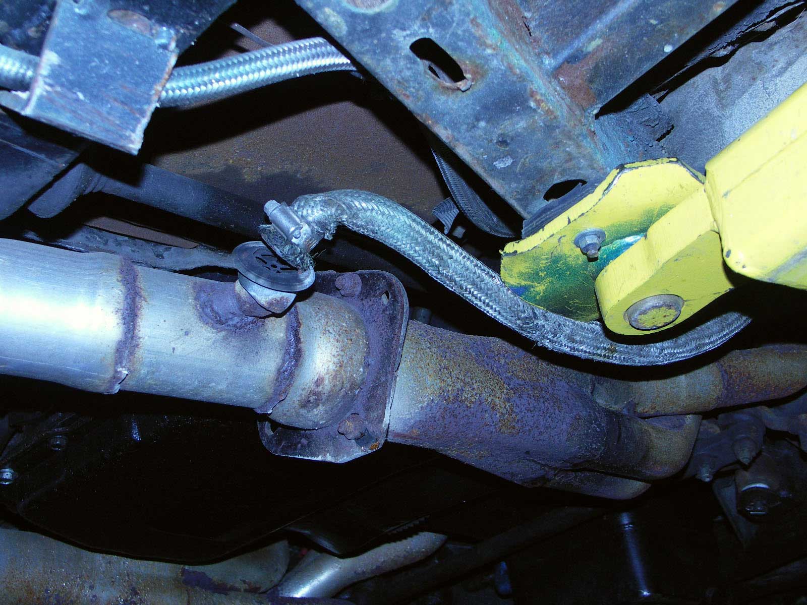

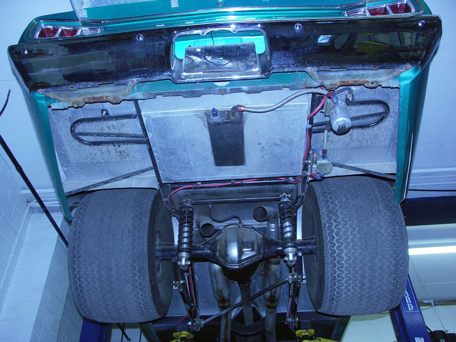

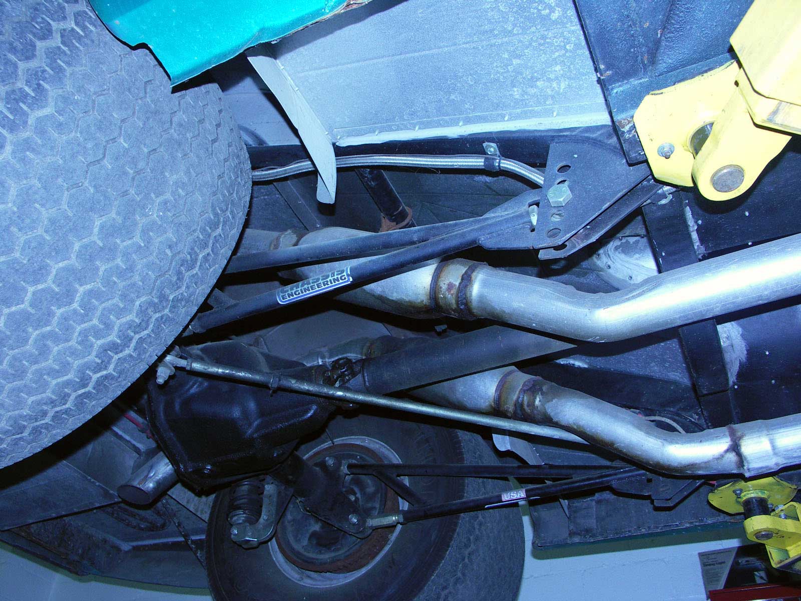

That looks great Nana here are a few more pictures and a report from my Guy in NY on the general condition.
I've been inspecting the Bee and I've made a few discoveries.
1. The Pitman Arm contains a ball joint and it is frighteningly loose/worn.
I can move that ball almost half an inch within the socket. I found a
replacement at Kanter for about $100. I am going to change it since it is a
major safety risk.
2. The left side exhaust pipe hanger was broken and the pipe was hanging way
down. I replaced the broken bolt.
3. The engine crankcase breathers are connected to the exhaust with a
stainless steel braided line. The breather line on the right side is broken
where it meets the exhaust. See picture
4. The oil filter is currently a Purolator PL30001. This is not a standard
Mopar filter. Keep this in mind if you ever change the oil and filter.

6. The rear tires seem to be holding up well, but they are obviously very
old. They show age cracks in the treads. They might come apart under severe
duty. I aired up the rears to 26 psi and the fronts to 49 psi.
7. I raised the height of the front by tightening the torsion arm adjustment
bolts.
8. The floors were pretty rusty and show some rot, but they have been
patched with sheetmetal. Not a big deal.
I've included a couple of pics to give you an idea of the equipment under
the car.
Best regards,
Chris
From what I can see there Bob, it looks like a well put together car, can't fault the chassis work at all. Do yourself a favour and replace the rose joints on the ladder bars, even if they have no play in them, I don't know how long ago that car was built or how many miles/runs it has on it, but the joints take a lot of stress and eventually fail and when that happens you're in big trouble...
Looks like your man's lift broke the PCV valve ;)
