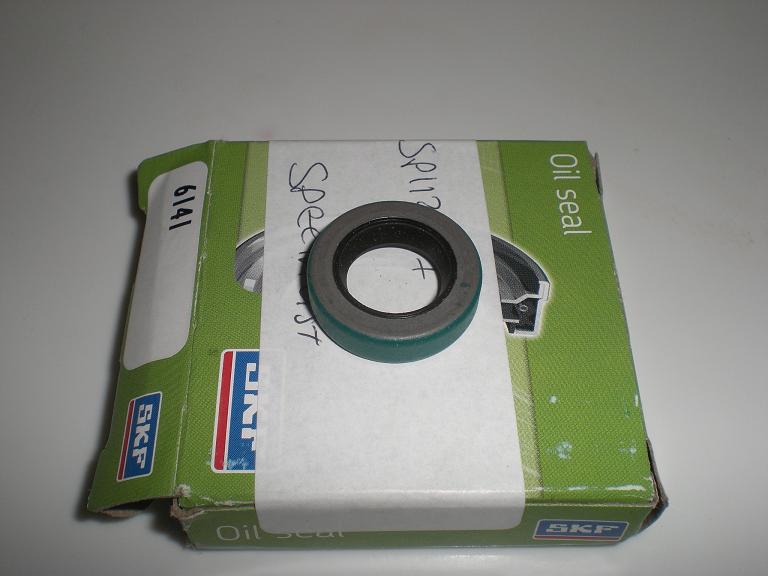

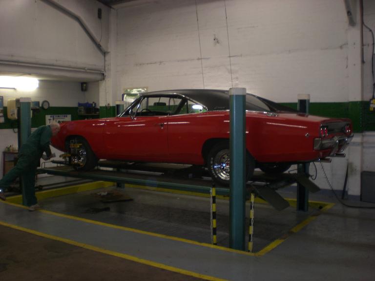

Got the new steering box seal on Wednesday and fitted it Thursday night and set the ride height. Fitted new power lead from alternator to battery so the car was ready to go for wheel alignment on Saturday. Got the wheel alignment done today and what a difference. The car is rock solid and drives so much better for all the work and I'm well chuffed.All I need to do now is fit the new coolant pipe i got from Derek today and my coolant leak should be sorted.
Wheel alignment done by Willow Motor Works in Mitcham
Seal from Specialist Autoparts

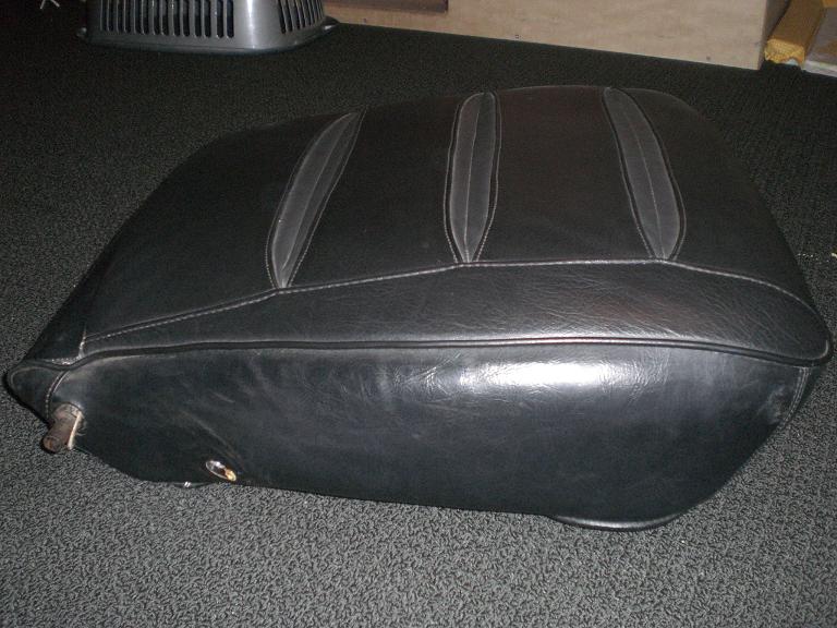

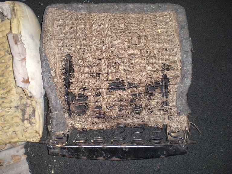

Thanks to the generosity of Derek who gave me his old seat covers I have stripped and recovered my drivers seat with his old passenger seat cover as it was undamaged and now i have no rips in any of my seats and here are the results. I added more foam to stiffen up the seat.
seat recovered with Dereks old cover

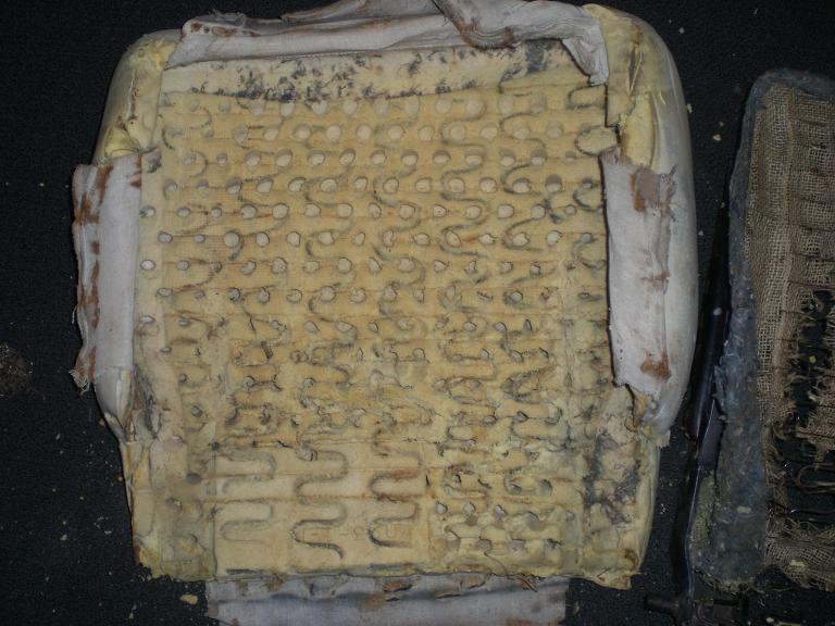

foam was in one piece but was crumbling very badly
seat base and hession in bad state

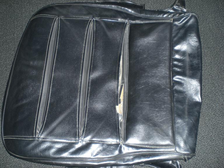

Old ripped cover
Old ripped cover

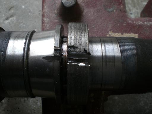

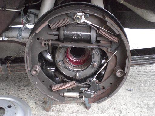

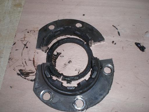

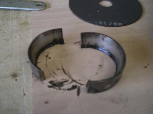

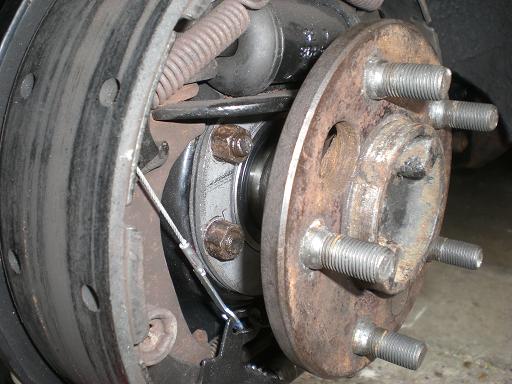

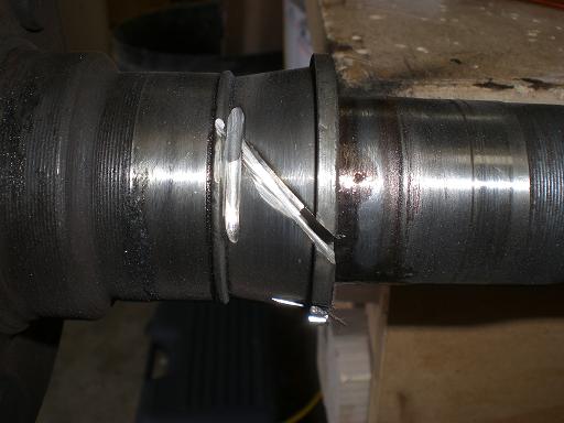

When i brought my car i had a bad grinding noise from the rear axle and didn't know what it was so on the advice of Derek jacked the car up one side at a time and spun each wheel and found that the noise only happened on the drivers side(i have an open diff so can spin each wheel separately).With lots of advice i brought a set of Green Bearings from DaveB(good,quick service thanks Dave). In the photos i show a step by step how the change to green bearings.
Anton

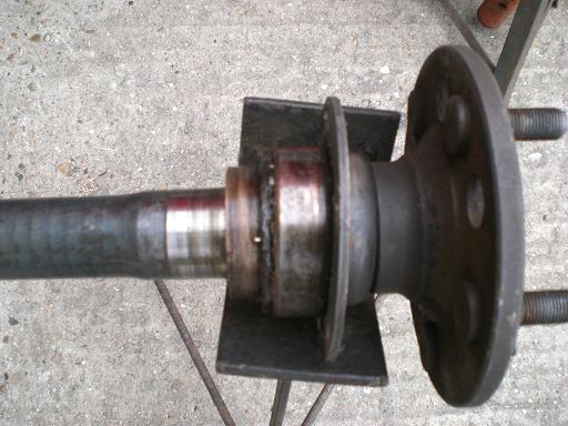

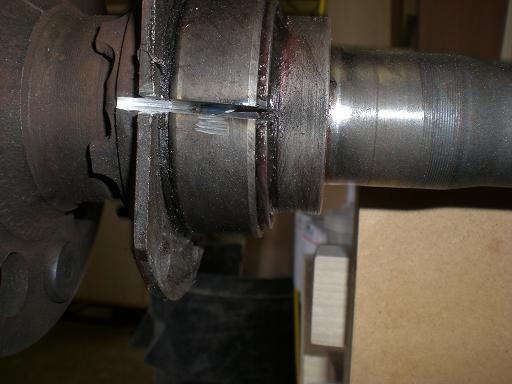

grind at 0' and 180' through axle retaining plate and remove
outer bearing race removed
Grind through th outer bearing case at 0' and 180' and remove it do the same with the rollers and casing
Haft shaft with original taper roller bearing
Jack one side up remove wheel and unbolt the half shaft and withdraw it carefully

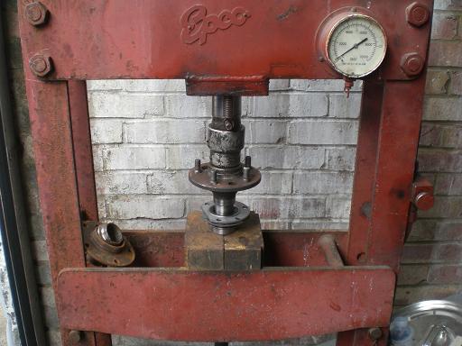

more
now fit the green bearing and i used a scaffold pole(which is exactley the right diameter)to get the bearing square and partially started before i used the press
cracked inner bearing race

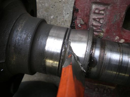

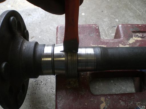

next grind a slot into the inner brearing race but not too deep and the again use a cheisel to crack th race and remove it
cracked collar.Now it is easy to remove
grind a deep slot into retaining coller(don't go too deep and damage the axle) and then use a cheisel and in the slot to crack the collar

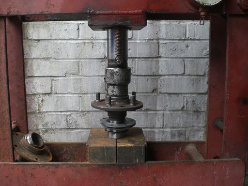

half shaft back in the car.The swapping of the bearings took about one hour and was alot simpler than what i thought it was going to be.there is no need to disturb the brakes when doing this job.After it was all back together i took the car for a test dri
bearing press all the way home and now ready to got back on the car
then it was into the press to press the new bearing on

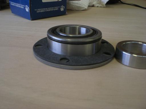

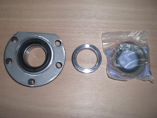

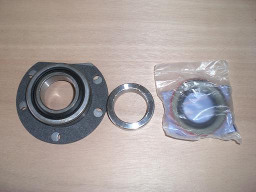

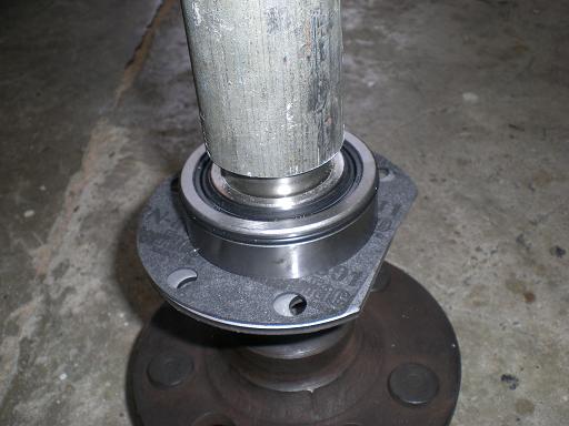

This is what a set of green bearing looks like

How did you put the locking collars on ???? press fit or warm them up and drop them on ????
John Rutledge
ANTON
Posts: 2046
Location: Sutton,Surrey
Post by ANTON »
John if you look at picture 12 you will see the locking ring is below the bearing and i put the bearing and locking ring on at once with the press.
Anton

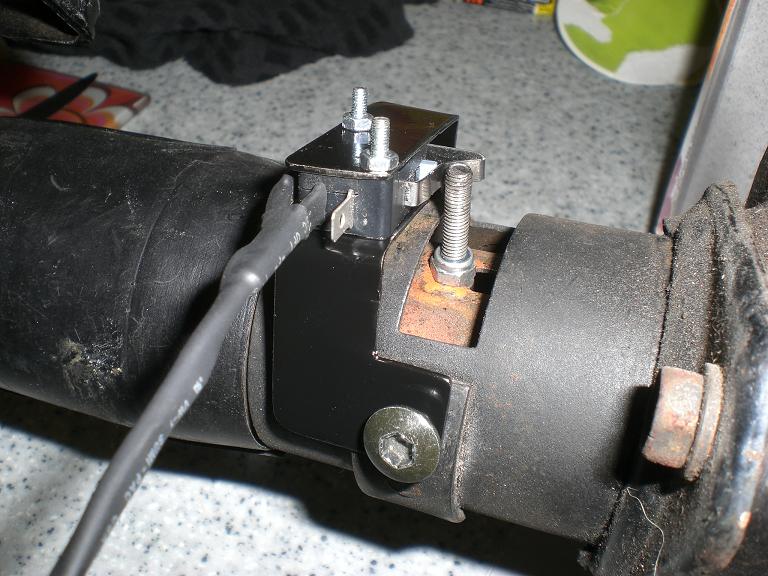

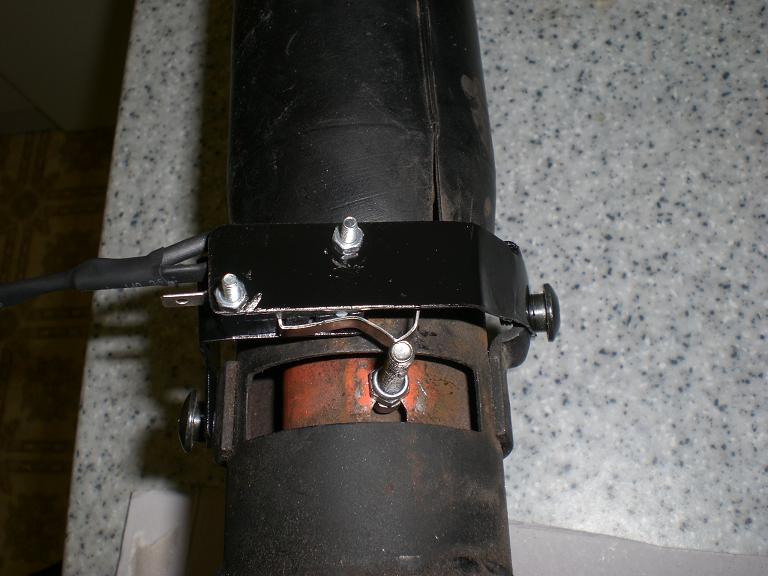

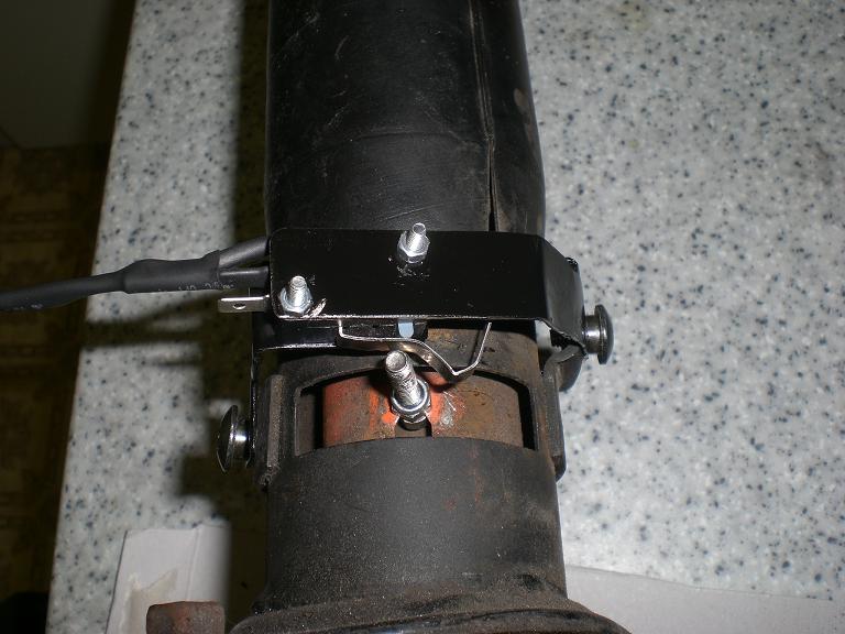

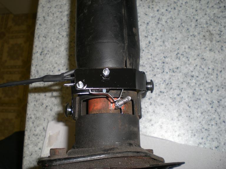

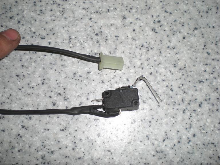

As you may have seen in the wanted section I was after a reverse light switch and bracket and was told that they were very hard to get, so i decided to make one and here are my efforts.
Side view with bolt a lever
gear lever in DRIVE
gear lever in DRIVE
gear lever in REVERSE with micro switch depressed
switch and bracket attached and gear lever in PARK
Micro switch arm bent and wires and plug soldered on

Nice one Anton, its always good to see some lateral thinking. Nice modification. :thumbright:
