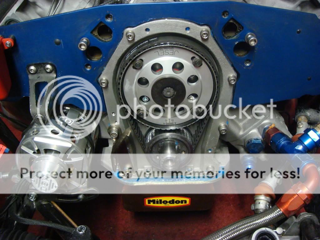

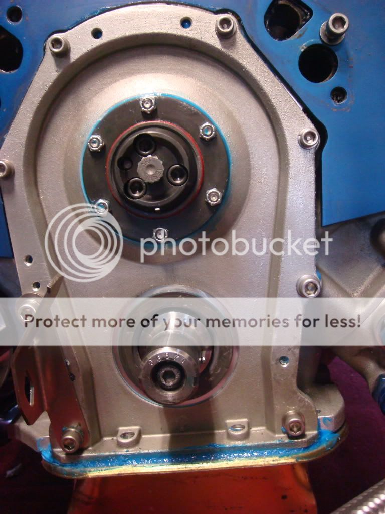

As there were a few questions on a Jesel, thought I would post a couple of pictures, as I just fitted new Top & Bottom seals
Jesel - Without Pulleys & belt - shows the camshaft pulley taper which determines belt tension & centres
Jesel - With Pulleys & belt fitted

interesting stuff. Is the taper both on crank and cam components - it's hard to tell from the pictures.

Pete wrote:interesting stuff. Is the taper both on crank and cam components - it's hard to tell from the pictures
Pete, taper is only on the top/camshaft pulley, the bottom pulley is parallel

mopar_mark wrote:As there were a few questions on a Jesel, thought I would post a couple of pictures, as I just fitted new Top & Bottom seals

you got enough ponjo round that cover mark, :shock: :D
Posts: 6740
I knew someone was going to comment :D :D
Yeah, plenty on there, meant to wipe the excess of with me finger, but got side tracked & forgot to do it :roll: Left it to late & it had already started to set.
Could of trimmed it with a knife, but then can get iffy messing around, so let it be ;)
Might look a bit ugly, but at least I know it wont be leaking from there :D
Was only a small oil leak, but the mess was bleedin unbeleiveable. Oil was getting onto the blower belt, trapped between the belt & pulley & emulsifying & slinging sh te everywhere. Took about 6 hours to get it all clean again :P
