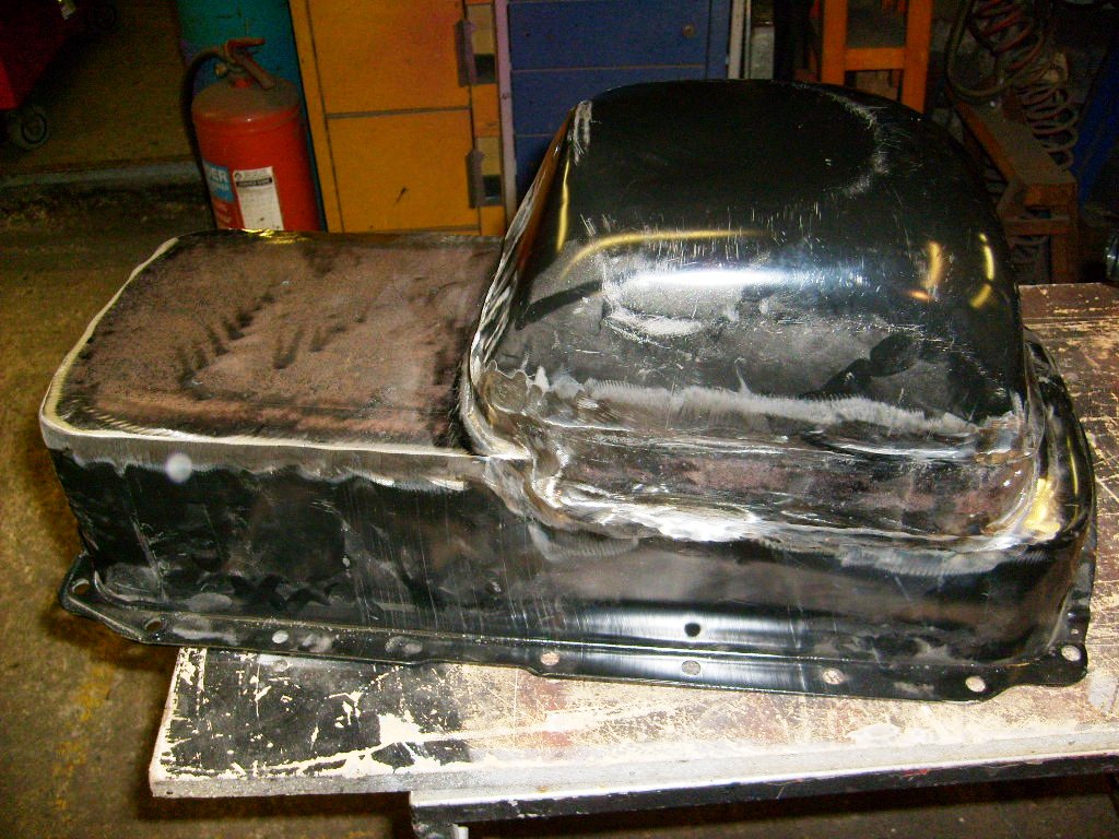

Just got to braze the sump internally. Leak test, then build and install baffle and remake oil pick up. Paint it, then that`s the bottom end mods finished.

Nearly done
Leak tested and braized. Just finishing the pickup tube and then fit baffling
Checked capacity and it is going to be approx 7 quarts
Surprising. A blower motor and the bottom end is not studded....
I'll get me coat...................

I`m fitting studs Pete
8-)

Jonathan you know if you are fitting studs, you should have the mains honed as the studs apply torque the bottom of the block differently to bolts. You may get away with it for a while but not forever.
Jon Connolly
Posts: 3116
Post by Jon Connolly »
I`m hoping it will be OK Guy ... only using it short term.

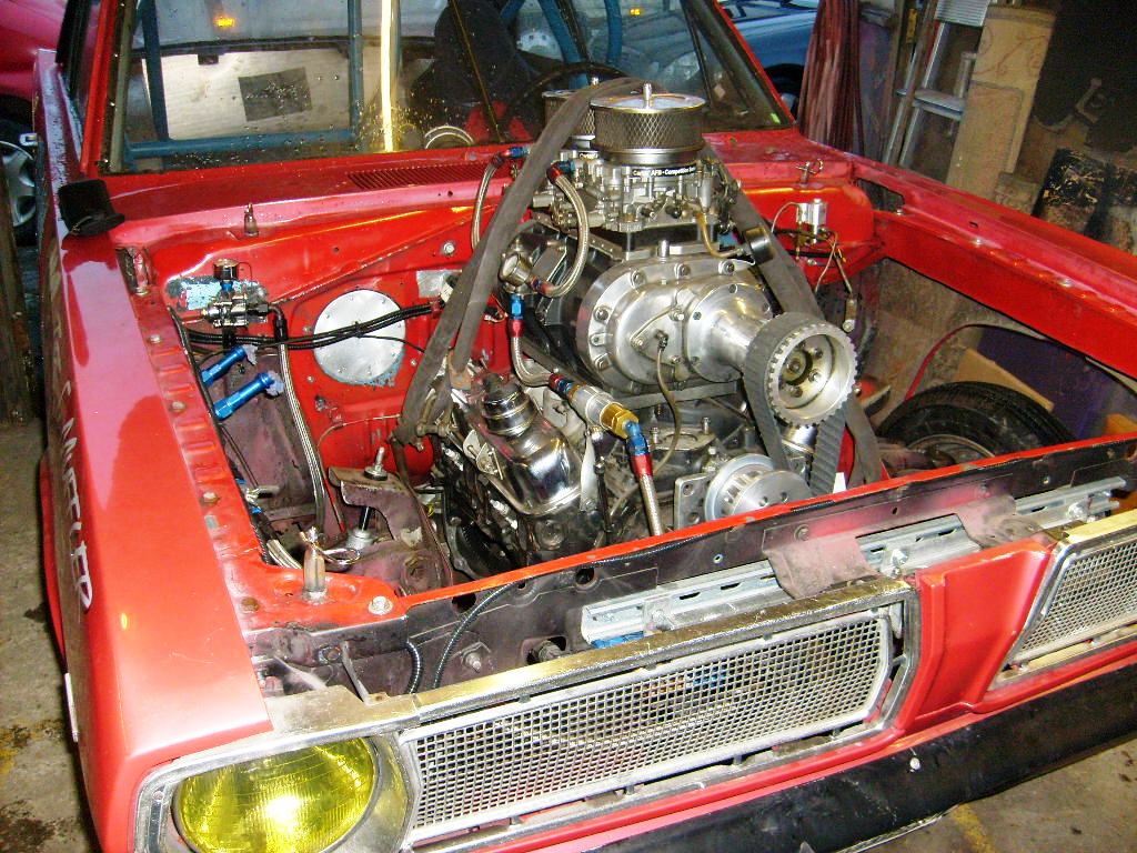

Got the sump baffles in, extended oil pick up and painted the sump.
Engine is now in, but sump just catches a bit on passenger side k frame, so will have to sort that. ( HAMMER )
Looks like radiator will fit in original postion. Headers are gonna be a nightmare. Will also have to make a filter housing and a few other bits
Posts: 13000
Jon mate, the blow hold down straps aren't supposed to go over the air filters like that :geek: :D
Looking great by the way! :thumbright:
why wont your original headers fit ?????????????
Jon Connolly
Posts: 3116
Thanks Ivor :roll:
Duncan ... the old ones were Hedmann tight block huggers, knackered. Got some tti`s to go on but don`t know if they`ll fit.
Of course they will - just add money :thumbright: :thumbright:
