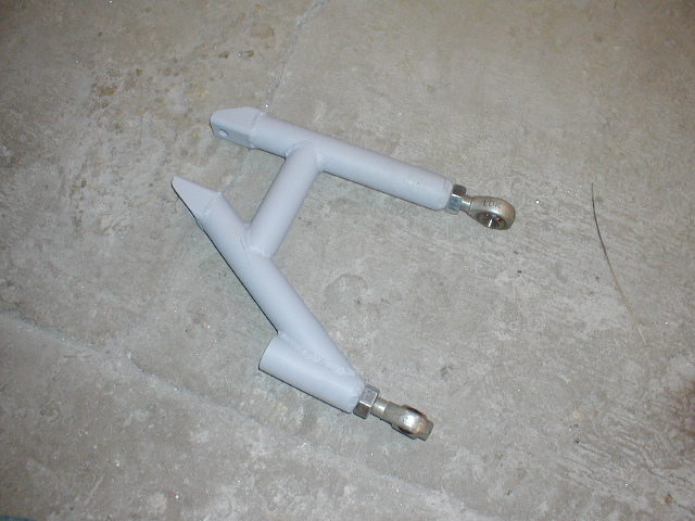

fabricated top arms up and tigged together

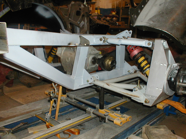

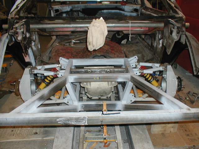

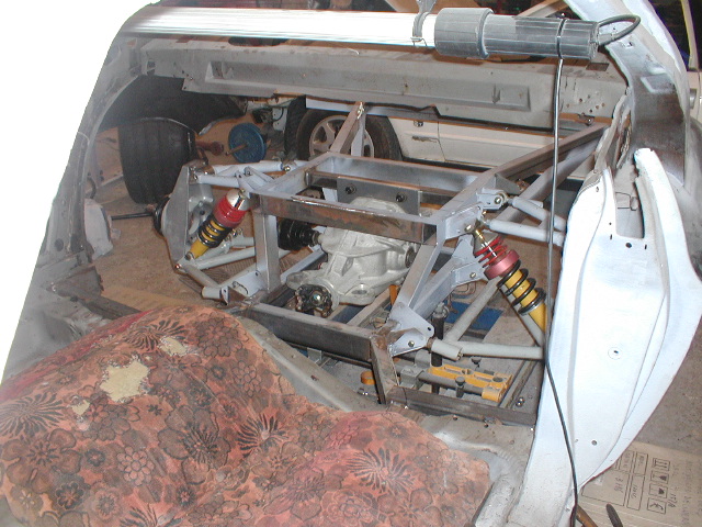

back suspension all on most of rear chassis now welded in place,just on with diff mounts, had to cut the mounting lugs of the viper diff and made a plate sandwiched between diff cover.

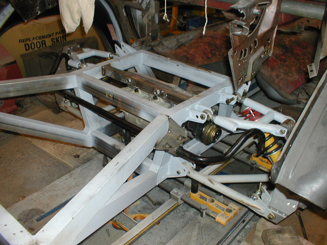

rear arb fitted, need to make connecting rods to lower arms, rear tyres in place to widen rear inner arches. 345/35 19" on 13" wide rims.
