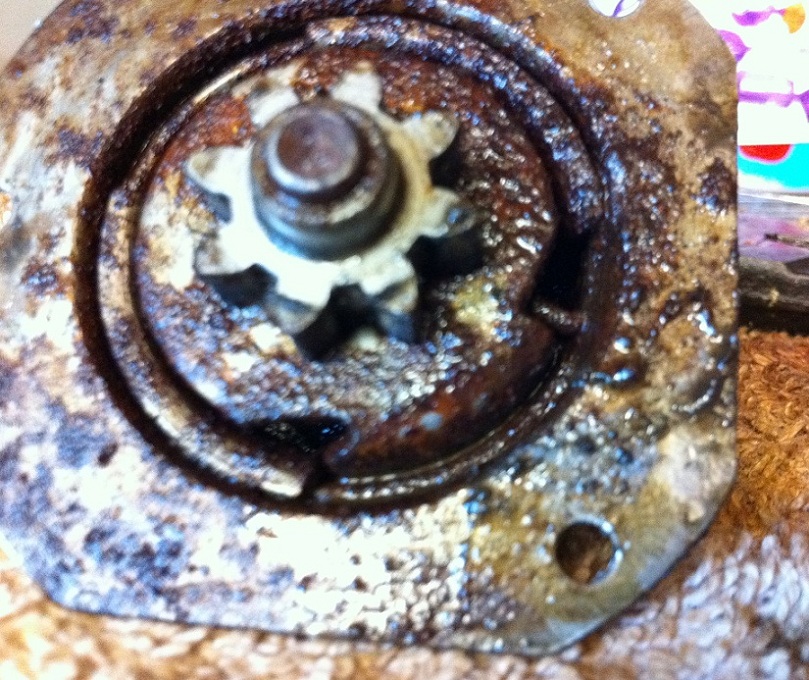

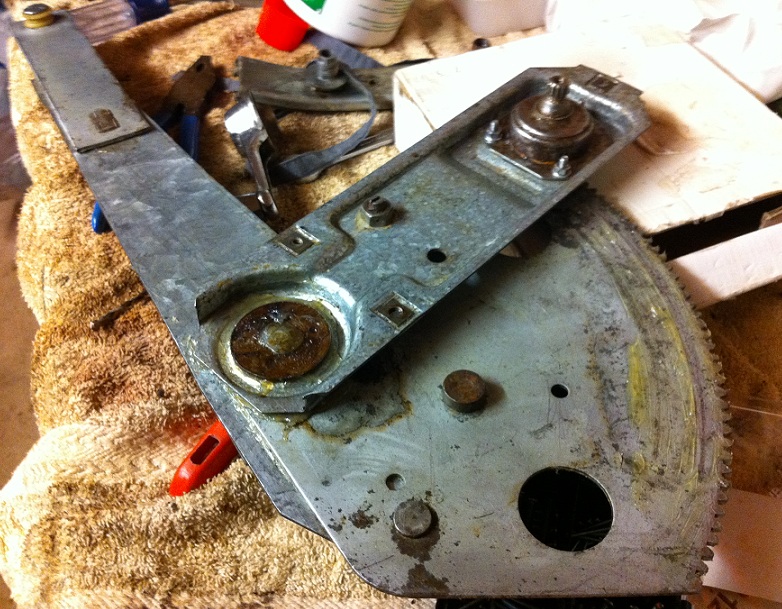

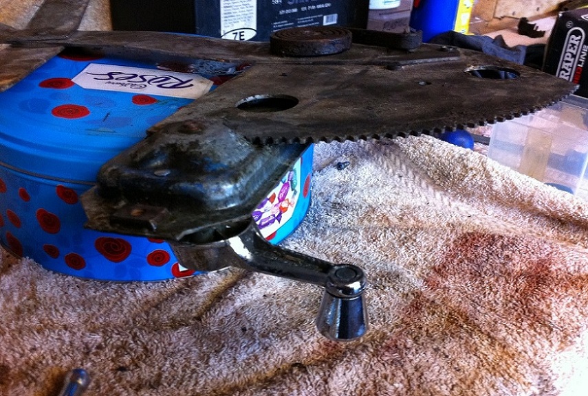

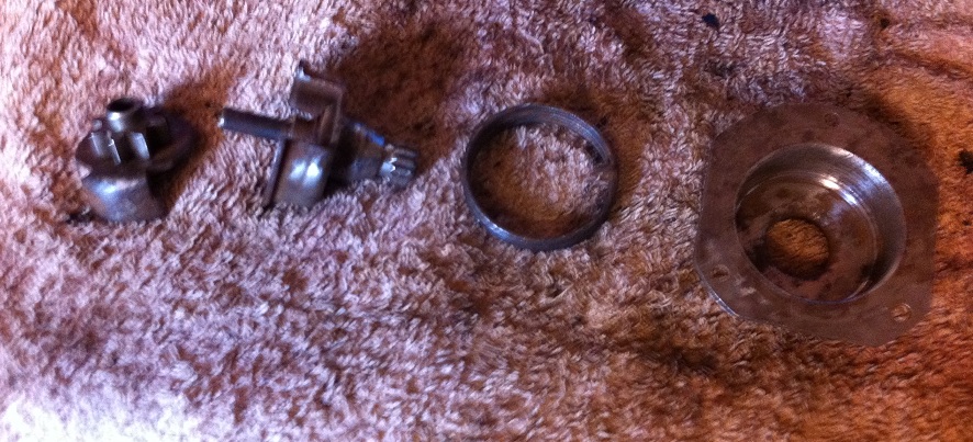

Also made a start on the rear window mechanisms as these are seized solid (just like the fronts were) :shock:
Stripped the complete mechanism out on the drivers side and tore it down.
Drilled out the rivets to get to the gear and spring thats hidden behind the cover where your window winder connects too.
(This is what we had to do with the fronts so knew where the problem was)
The spring inside had rusted completely in it's seat.
A good clean up, grease up and reassemble sorted 1 side out at least ;)
We'll refit it next weekend and strip out the otherside.
Also had to de-seize all the rollers too.
That's abit of a nightmare as they're nylon/plastic, and too much pressure will just crack/brake them so abit of TLC is needed when it comes to these.
A good overnight soak in a tray of the old WD usually does the trick :thumbright:
Refitted And Greased Up
Stripped Out And Cleaned

Problem Area
Problem Area

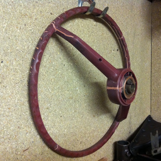

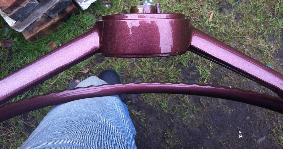

Next job .... Steering wheel

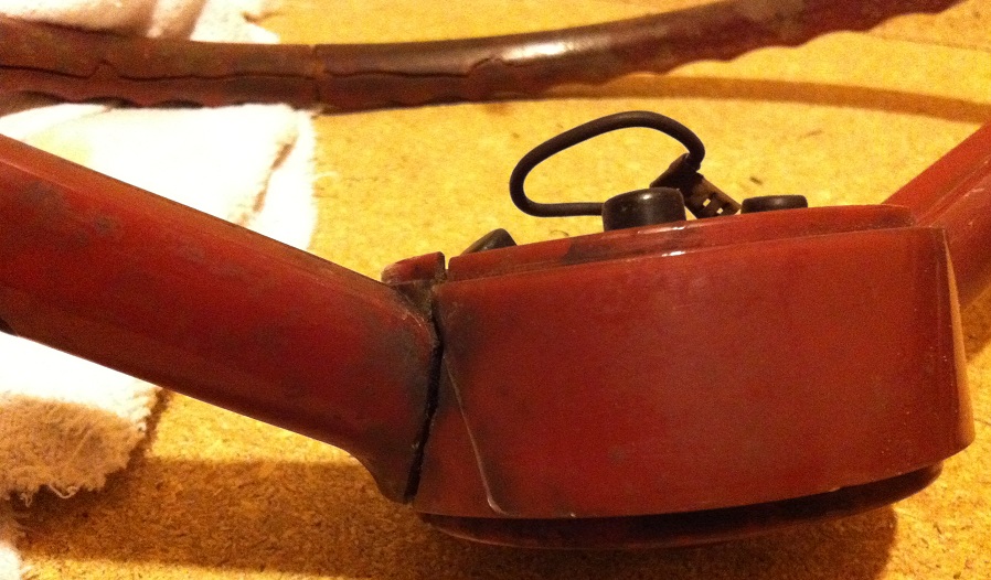

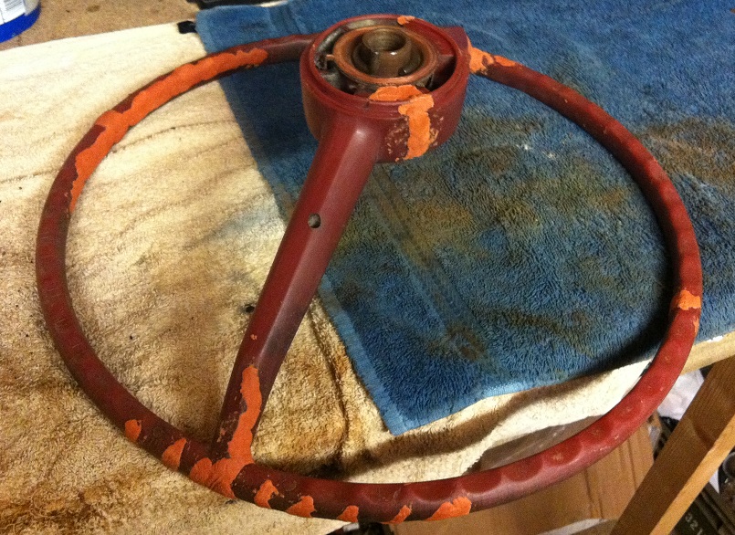

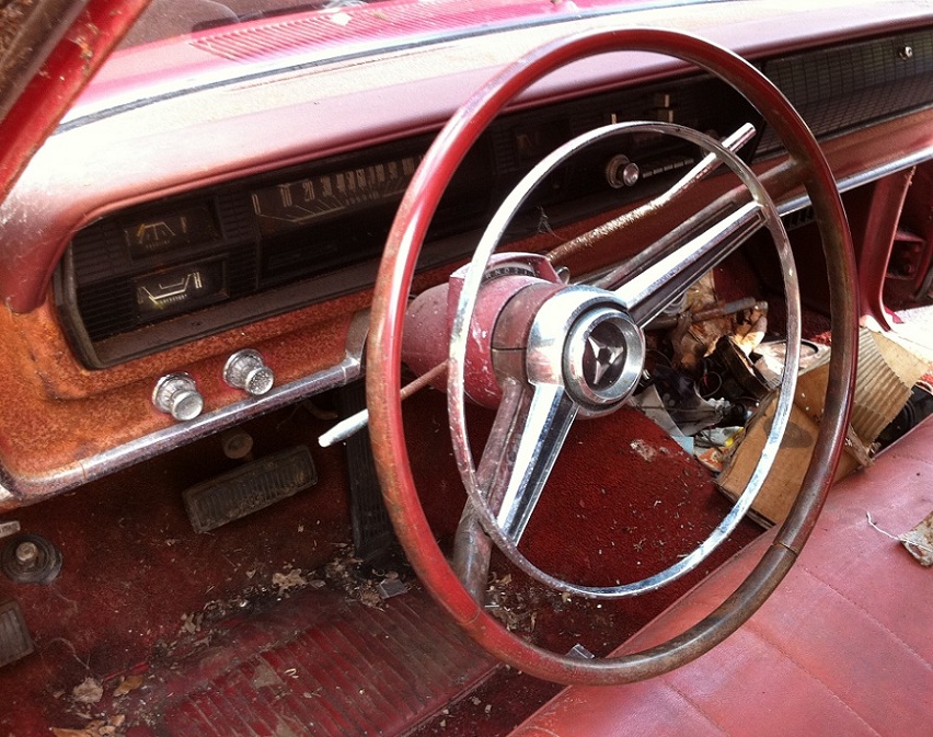

Along with the dash, our steering wheel was also in need of abit of TLC. It had definitely seen better days by the time we got our hands on the car. :shock:
We found out the best way to repair cracks in a wheel was to use an epoxy putty, so thats what was used. :read2:
After a real good clean up and de-grease we set about the repair.
Incase you were wondering......this stuff is real easy to mix, use and sand down! :thumbright:
The stuff we used came in a pack containing 2 lengths of putty (like kiddies plastercine).
You just cut off equal amounts of the stuff and mix together until a uniform colour, then away you go :)
The pack says that it's hard enough to rub down after a few hours (optimum temperature) but due to the poor weather we had at the time,
we thought it best just to leave overnight.
After a good rub down and clean up, I took it to a professional body shop to be painted ;)
Rubbed down
Rubbed down
The putty squished right in there
a couple of deep cracks
How the dash and wheel was

Jules
Posts: 1850
Post by Jules »

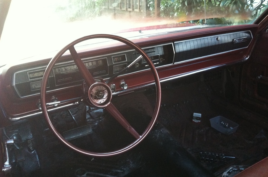

Seeing as a steering wheel is (slightly) flexible, the correct primer for the job is needed (one with plastercisers in the mix - I hope I've got the right name)
otherwise the paint can flake off after a while. This is the reason why we had this particular item professionally redone.
The bodyshop took care of any small imperfections for us that we missed, then primed, painted and laquered it. 2 pak laquer I believe was used, so very strong and durable ;)
It looks the Mutz Nutz and it finishes off the dash a real treat :D
Column and wheel back in place
Dash - No column
Dash - No column
.....what cracks?
.....what cracks?
Fresh back from the paint shop

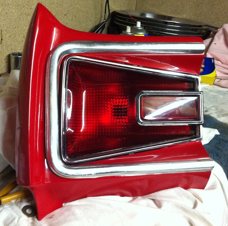

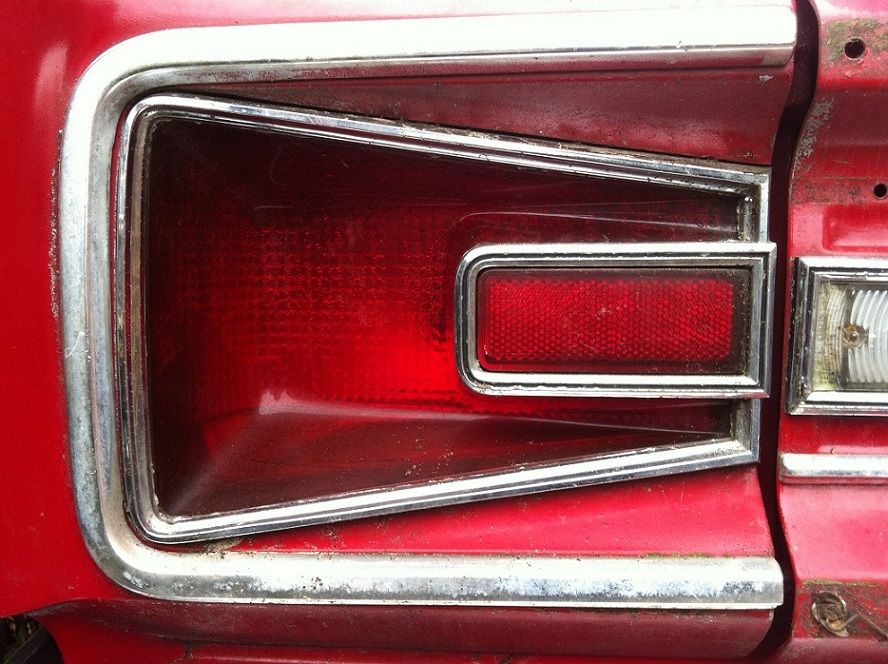

Then, it was time to head for the workshop and clean up the rear lens clusters which obviously involved alot of patience and a tremendous amount of skill to carefully dismantle said items ready for refurb :lol:
(actually we did have to tread carefully coz the chrome trim is riveted to the reflector part of the lens which we didn't know about :shock: )
As we dismantled the components, half of the californian desert that had accrued over the years in the clusters fell out onto the work bench :lol:
so my garden is now another 2" higher than before :lol:
After dismantlification we carefully cleaned all the components ready for polish and paint where necessary :thumbright:

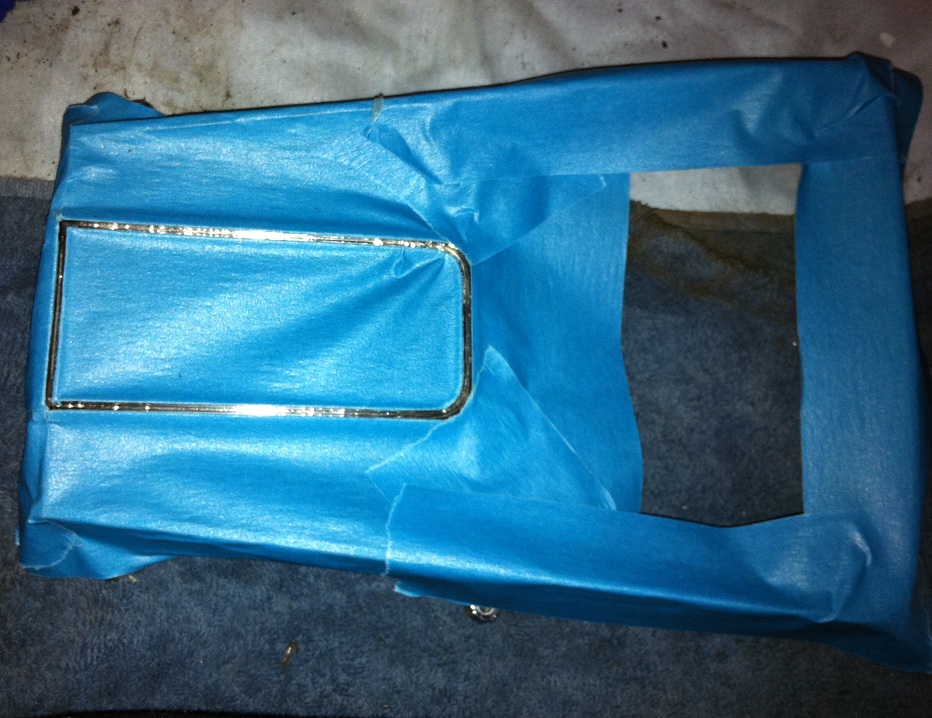

We repainted the inside of the light housing with some chrome paint as it had gone abit flat and also re black-lined the chrome trims that surround the light lenses.
We gave the lense a real good clean and polish and now it all looks fab :D
ooooooh yes!
ooooooh yes!
Cleaned and painted after dismantlification LOL!!!
Masked up for blacking
Still on car
Still on car
