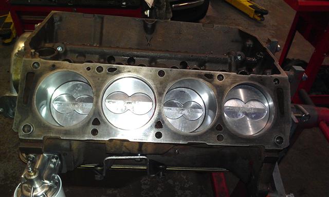

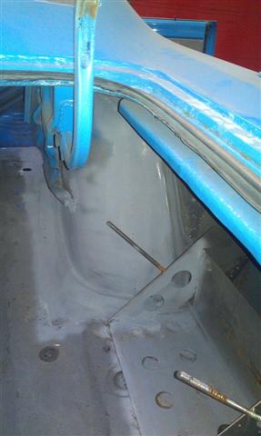

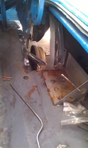

Posts: 7516

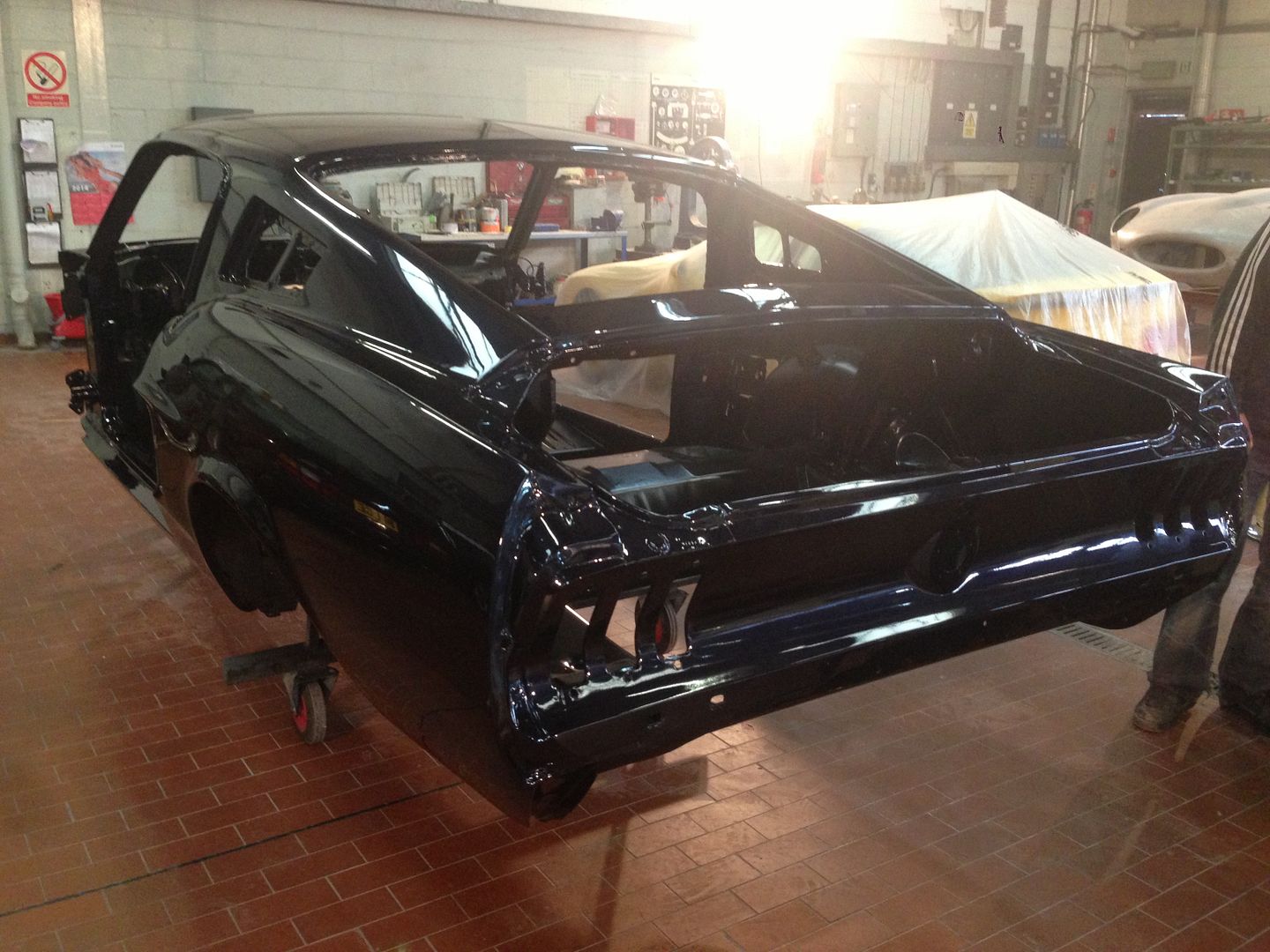

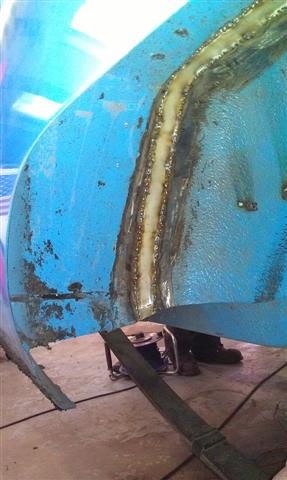

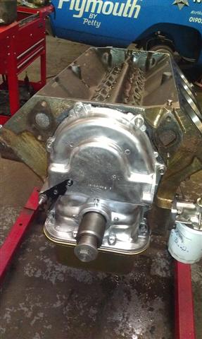

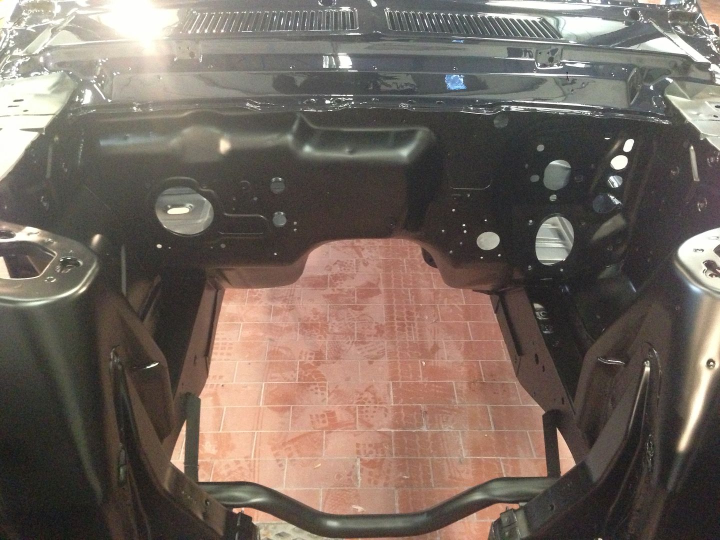

Anton has been busy again, building Lee's Mustang engine and making Don's tubs a little bigger.
IMAG1294 (Small).jpg (25.08 KiB) Viewed 2232 times
IMAG1293 (Small).jpg (61.79 KiB) Viewed 2232 times
IMAG1288 (Small).jpg (28.03 KiB) Viewed 2232 times
IMAG1287 (Small).jpg (95.8 KiB) Viewed 2232 times

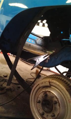

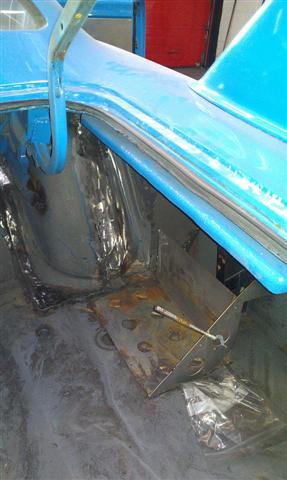

Posts: 7516
I even helped Anton today.....................I held the hammer. ;)
IMAG1297 (Small).jpg (25.12 KiB) Viewed 2228 times
IMAG1296 (Small).jpg (24.71 KiB) Viewed 2228 times
IMAG1295 (Small).jpg (68.22 KiB) Viewed 2228 times
vipergts
Posts: 940
Joined: Sun May 21, 06 4:22 pm
Location: kent
Post by vipergts »
Engine looks great Anton, I vcan't wait to fire it up.
Shame to splosh blue paint all over it really

great work there Ant and Dek :thumbright:
Posts: 13955
Don wrote:great work there Ant and Dek :thumbright:
Like it! That'll stick :D :lol:

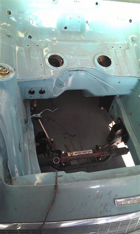

Posts: 7516

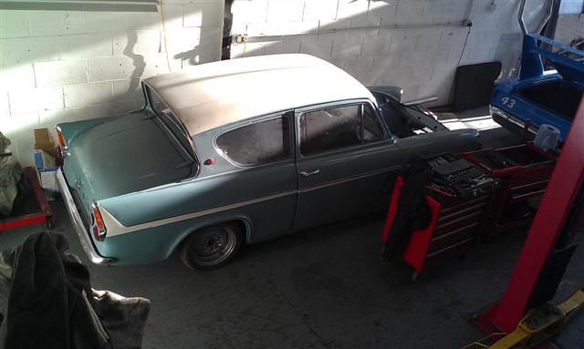

And another couple, the Anglia is having a Harris built engine put in to it, sadly it's only a four pot, lots of other work has to be done to the car too.
Who remembers what colour this was last year.

Posts: 5915
Green and white 2 tone

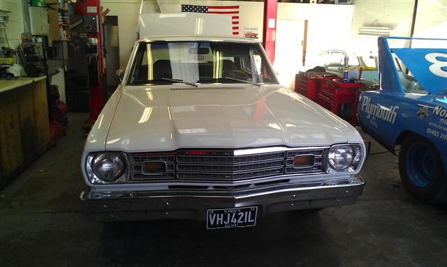

And another one arrives for work, Sam's Dart, what a pain in the butt it is to fit headers to an A body, but it will be worth it in the end..................How do you guys with a big block get on fitting headers in an A body.
And yes Matt you are right.
IMAG1400 (Medium).jpg (75.71 KiB) Viewed 1810 times
Don
Posts: 1844
Post by Don »
bad enough fitting them in a b body del, i've got mine off at the mo and they're a pain in the 4rse, chopped them back as far as i can so as to stay 3.5 all the way through :? Sams dart lookin good :thumbright:
