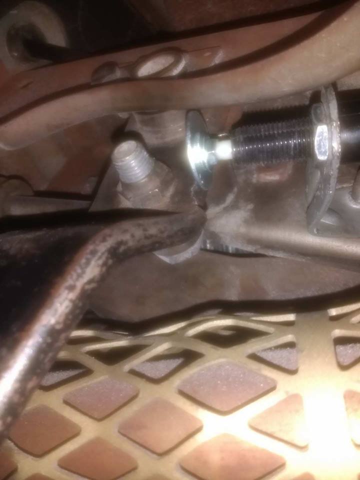

One of the more frustrating things that i have battled the entire time i have owned the car is the brake light switch. I Managed to get the bracket out and it was all bent out of shape, hammered it back into the rough shape, but all the switched i had were not that great and none of them would connect to the pedal assembly either. At about 9pm i had an epiphany, the switch i had, the actual part that presses is hollow, so i screwed a small sheet metal screw into it, and put a bunch of washers onto the screw. The switch hits the pedal every time now and works like a charm. Hopefully wont have to sort that out again. The dash has gone on and off about 50 times in the last month. Annoyingly the lights on the dash still dont work, apart from the indicator lights on the dash.

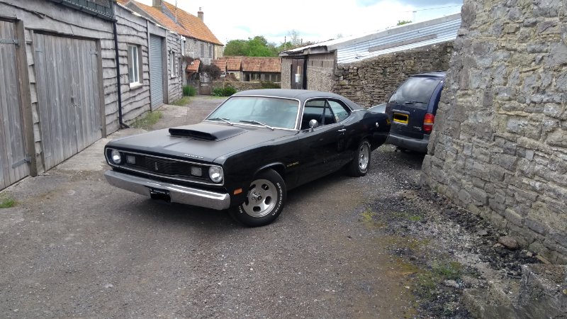

Been far too long since my last update. Laid the Duster up for the winter in August 2017, job situation throughout 2018 was not great, and the Duster took a back seat for a while. Got a great new job in a completely different field last October and i am finally in a good place to get the Duster back on the road, and replace my current boring old Toyota.
Had the car down my mates Garage, hes done the odd bit for me here and there, but i wanted him to get through some of the bigger or annoying things i cant or dont have time to do.
So Headliner is finally done, 2 years after starting it. Looks great, but sags a little at the back where the trim is not installed.
Purchased a new PS pump as my previous one leaked, and stained the driveway and garage pretty badly, i think he said he had difficulty getting the pully off, so he just rebuilt it with a seal kit i had bought a few years back.
Purchased new some tires from Jon Leonard in bristol (Orange Dart and Gen. Lee charger), and finally had them installed. Its now 215 down front, 225 in back. Doesnt make as much as a difference as i had hoped, but still looks good and i wont have to inflate the tire every couple of days.
Car has also had a full MOT and service. I Know the rules are different now, but it hasnt been done since Ash Rawson had it for paint. Needed some brake and bearing work.
Next up should be new brakes up front, installation of a TF2 shift kit, and some minor electrical works. Should be at the Nats later this year for a few passes.

- IMG_20190528_133621192.jpg (120.38 KiB) Viewed 2272 times

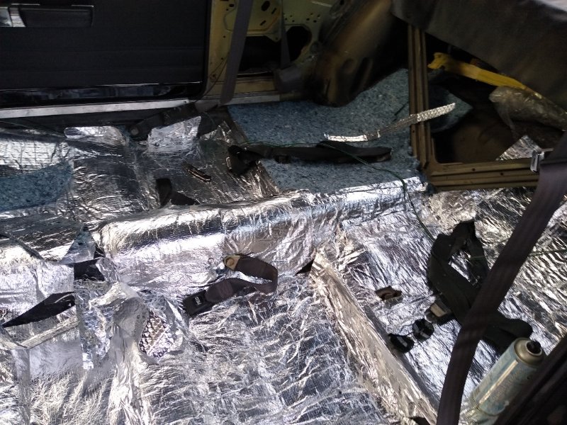

Slow progress, but finally getting there. Stripped the interior today, gave it a good clean and used a wire wheel on some of the surface rust from the old leaky seals. Bought this stuff like 3 years ago now and only now getting around to fitting it. Not pictured are the dynamat strips that are strategically placed on the floor pan. Annoyingly, i only now discovered the insulation kit i purchased had to left side rear panels, instead of a left and right. Had to flip one over for now, wont ever notice anyway. Tomorrow carpet on, rear inner panels back on, give the seats a good clean and should be all done for now.
