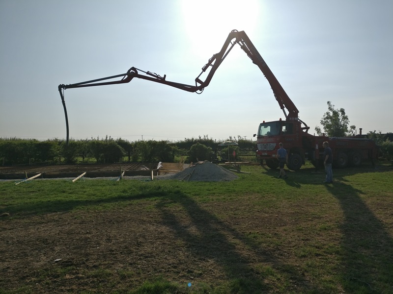

update, concrete in. 36m cubed.
Damn that was hard work, happy with the finish though :D

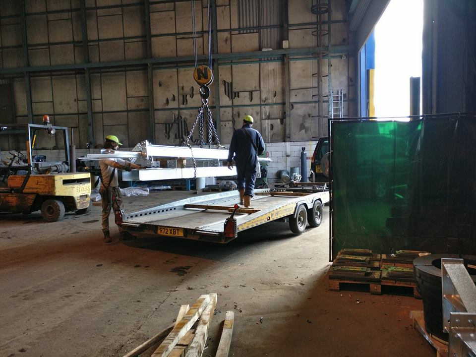

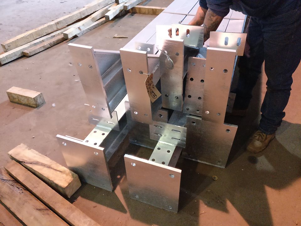

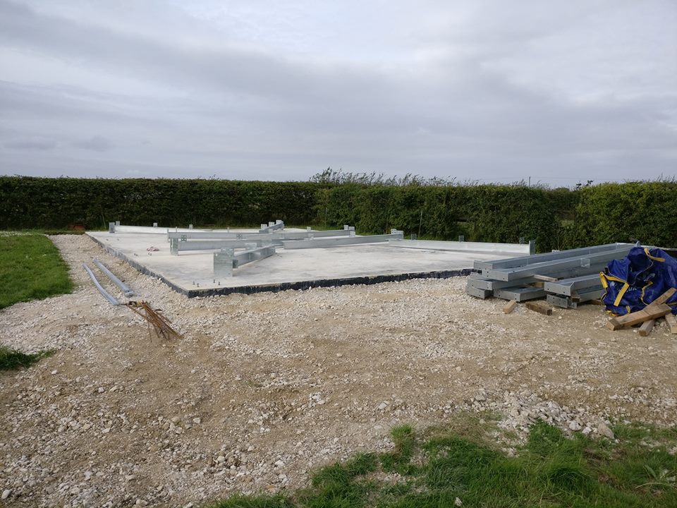

So the frame was picked up the other week:
GJUK
Posts: 2486
Post by GJUK »
pic

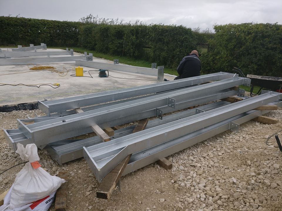

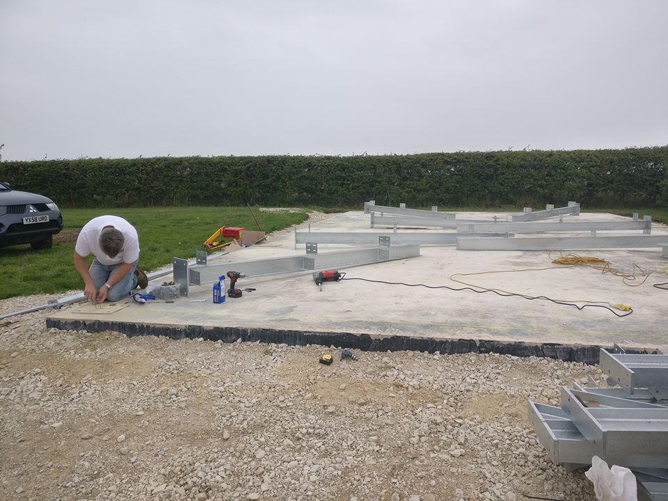

Build has started - epoxy bolts in.
GJUK

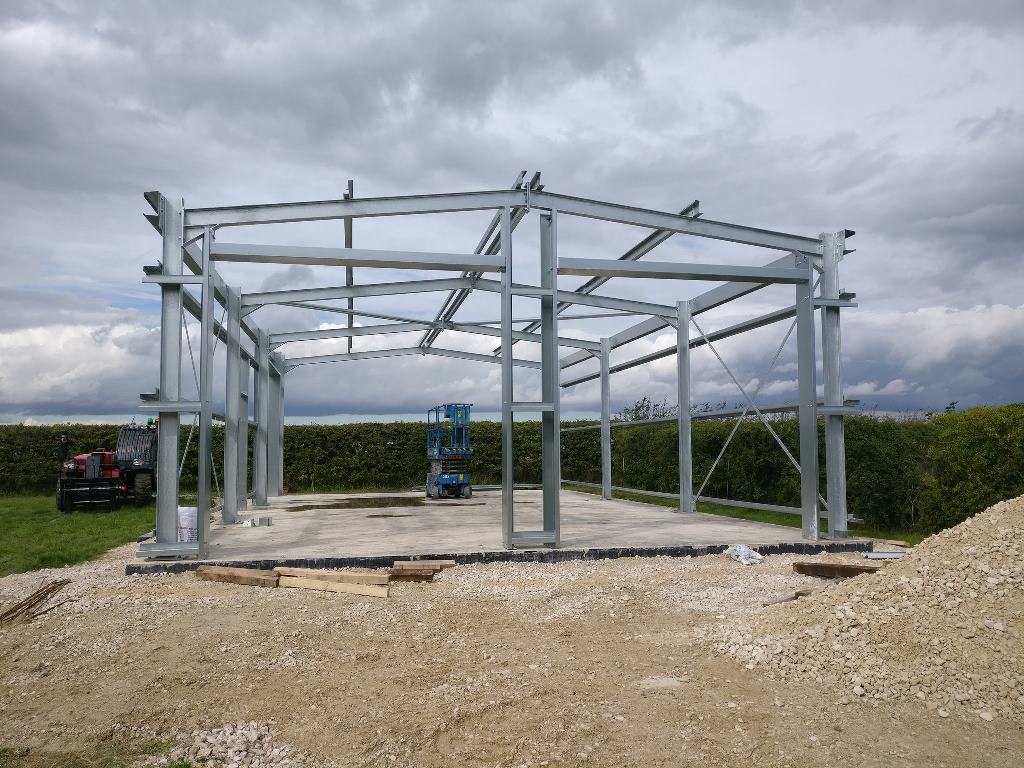

Posts: 2486
ta-da
Post by GJUK »
ta-da
