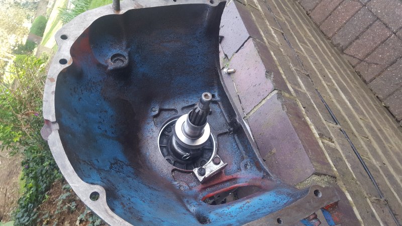

I have a car bellhousing coming, It shold make all the differance. The input shaft should be in the back of the crank flange by abut 22/24 mm ;)

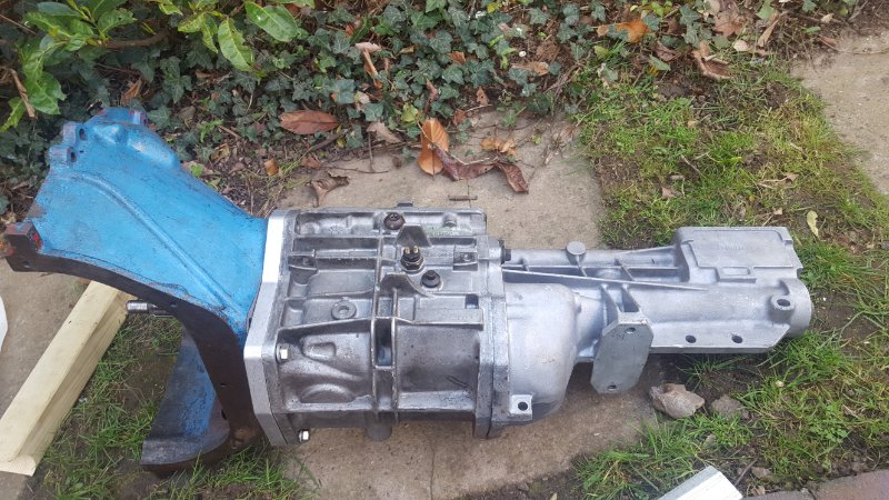

Re: Cortina MK3 V8 MOPAR
Nice

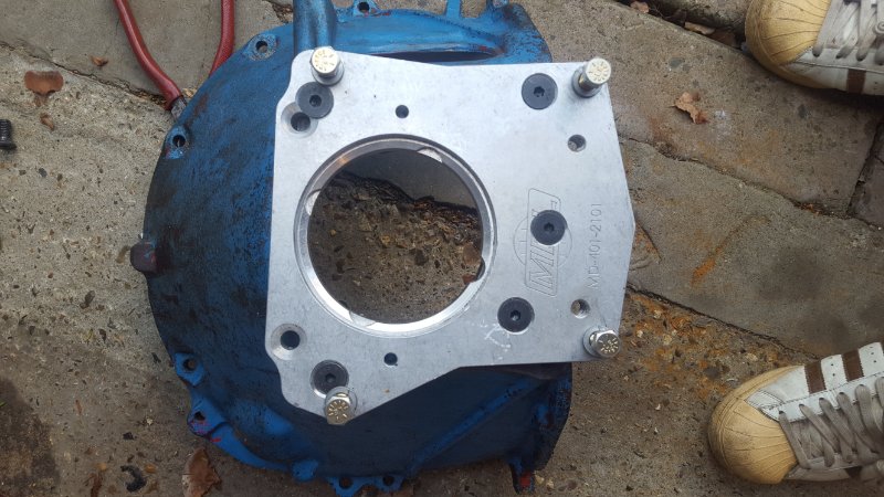

you need something like 18 -25 mm in the adaptor
easy way is to measure the bell from front to rear face
mopar is usually 7.5 inch i think
then you have somewhere between 18 and 25 mm to play with for the dapator between bell and box
mock it up and check that the end of the spline on the input shaft ends just before the friction face of the flywheel when mounted up
the bell depth + whatever is left is you adapter thickness
i got in touch with modern driveline in the US he's a mustang guy who does bellhousing to box adapters he was willing to share dimensions of his ford and chevy stuff so that i could choose one with the holes well away from where i needed new ones to mount my odd box and bell combo
$150 and £25 at a machine shop here...job done
next check that the clutch plate has free play back and forth on the spline T5s had long and short input bearing retainer (IBR)
and they came in aluminium steel (and steel for pocket bearing ford racing T5)
you need a standard steel one of appropriate length.....
a swap is not hard but neither is it easy as the IBR supplies the preload through the main input shaft right to the back of the box.
its all set with shims. you can buy packs of peal-able shim material in a range of thicknesses.
and its easy to lose shim and roller bearings into the box internals when you take off the IBR and input shaft, its all sloppy if you don't get this right at this end.
ally IBR is ok but most are very old and scored and worn the release bearing can get hung up causing clutch drag
i'm assuming you have a long Input shaft t5 you might not
if you have the short input shaft box the adapter situation might need to be 5-8 mm steel rather than fat alloy to achieve spline in the right place
ideally you would not have the clutch centre overhanging the taper on the input shaft when clutch is engaged...full spline coverage in the clutch centre hub is best

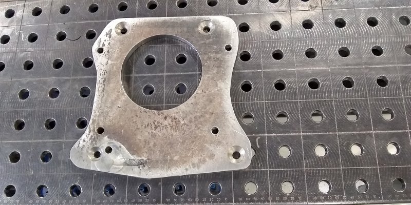

aim for something like this
bell mounted to block with flywheel on
block on its side
move the trans into the back of the bell until the end of the input shaft sits into the hub of the flywheel to the point where the spline end is level with the fiction face.
measure the gap between the back of the bell and the front of the box.....
that gives you your wiggle room on adapter thickness
by bell had offset lower left (in picture) mounting hole right on the side of the adapter
so i drilled and tapped two more holes
belt n braces and all that. would have been fine with just 3 bolts but...you know. toss up between an adapter that could easily be centred into the bell housing hole or one that would be a pig but had more space for new holes
centreing was key for me so i had to cater for the 4 offset mounting hole in other ways
Paul coffy at modern driveline was very helpful has a 67 falcon loves a ford, knows nout about chryslers but affable helpful and his adapters are $100 to 200

Thanks Dave,
This is what ive have made to mate them, I used the centre hole to line everything up.
Just need to drill one more holeImage

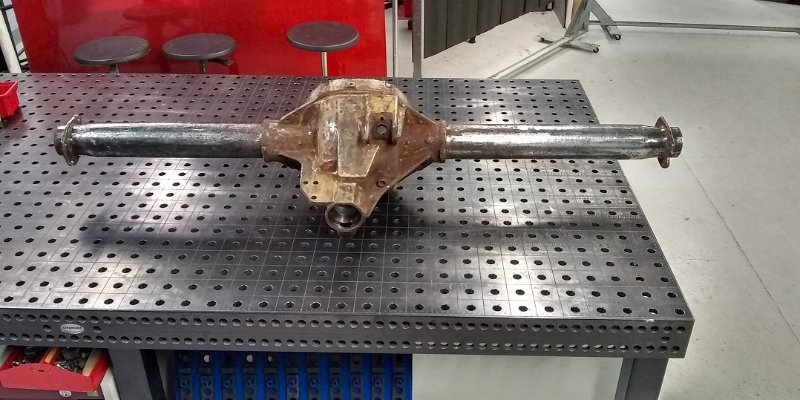

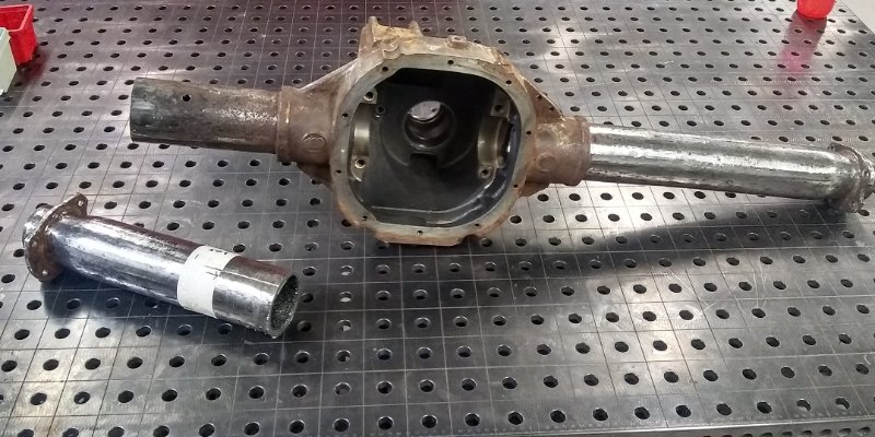

On the rear axle, I found out that the mustangs 7.5 rear axle may not be up to the job of running a V8.
Ford Explorer, as these things have an 8.8 LSD rear axle beefy enough to take the V8

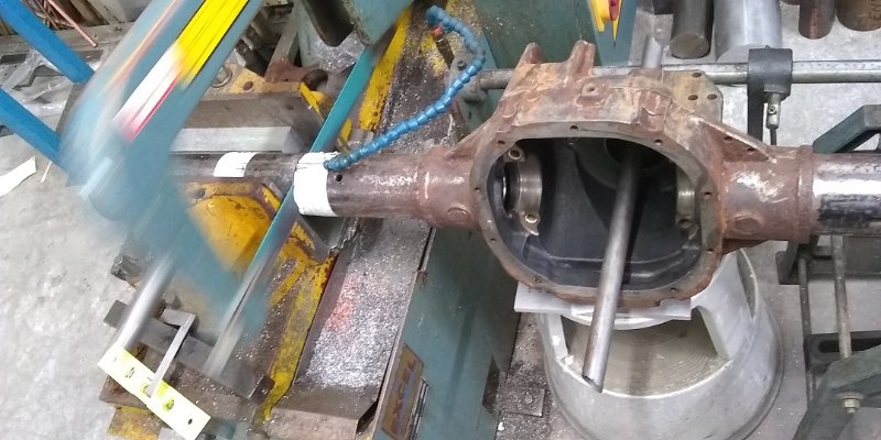

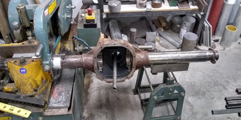

I need to narrow the axle so I can get some nice deep dish wheels on the car, I was going to have this done by someone .But decided to give it a go myself :unsure:
After fighting with the 70kg rear axle on my own to get it out, cleaned it up and cut off all the original mountings.
TIB3300
Posts: 631
Location: Sheffield
Post by TIB3300 »

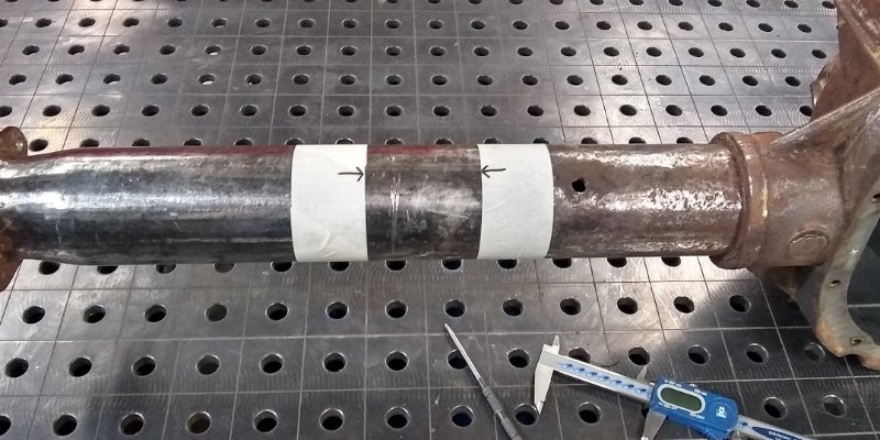

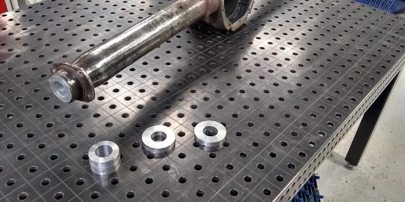

The thing with the explorer rear axle is these axles are actually narrower then the cortina by 10mm,
But I want to narrowed it by another 3in, I was going to buy some Moser shafts made to measure at a cost of £460 + vat and carrage.
But after some research and noticing that one half shaft is 3in shorter then the other. It made sense just to buy another short shaft £80
So after mesuring both the long shaft and he short shaft, I figure I can cut the casing down by 77.598 mm
