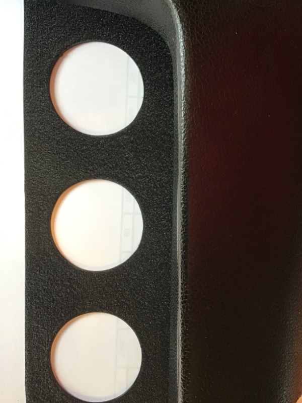

Plate should be cured by tonight, so will test fit the gauges again. Very pleased with the finish against the trim, looking forward to seeing what it looks like against the ribbed finish on the dash.

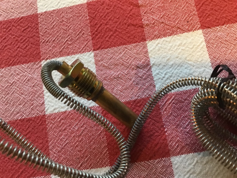

Quick question on the water temp gauge, at the manifold / sensor end of the capillary tube, does this need sealing in somehow when connected? I dunno, ptfe tape or a blob of something, or is it fine as is? Take it I’ll have to drain the coolant half way or similar.
