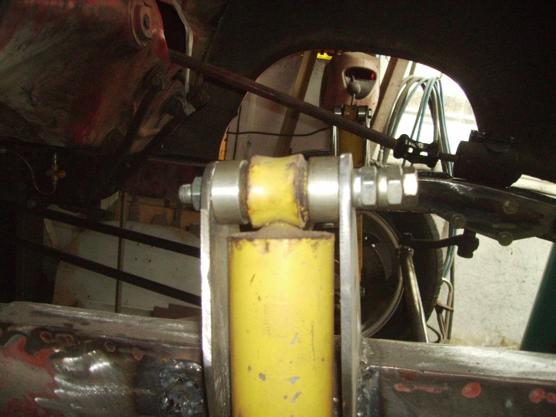

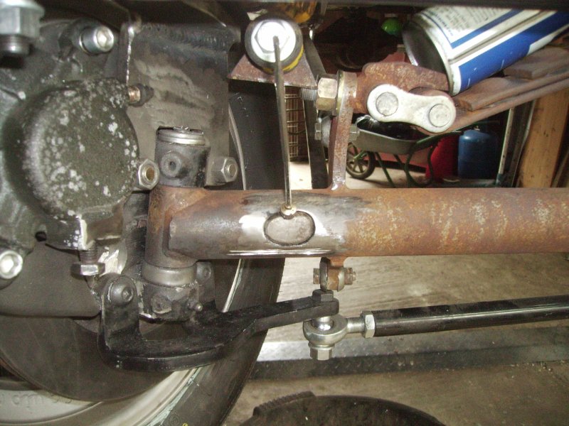

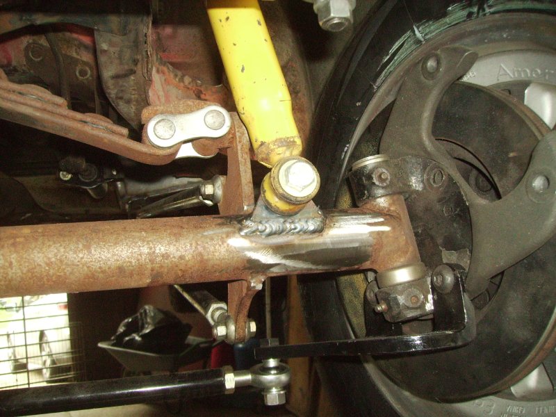

today the front shock mounts were finished off. we tried the threaded slug in the axle idea........ fail, even with the slug moved over an extra 1/2". the caliper was still too close on lock so that meant '2 steps back' and weld a lump of 1/4" steel back in the hole and then just weld the old brackets on the upper front of the axle instead of the lower front. last job was turn some ally spacers for the top mounts. these are made nice and chunky to give the brackets extra stiffness.
neil.

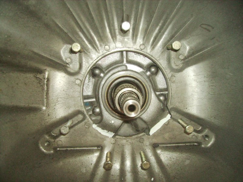

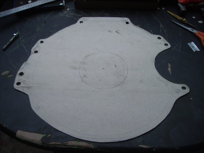

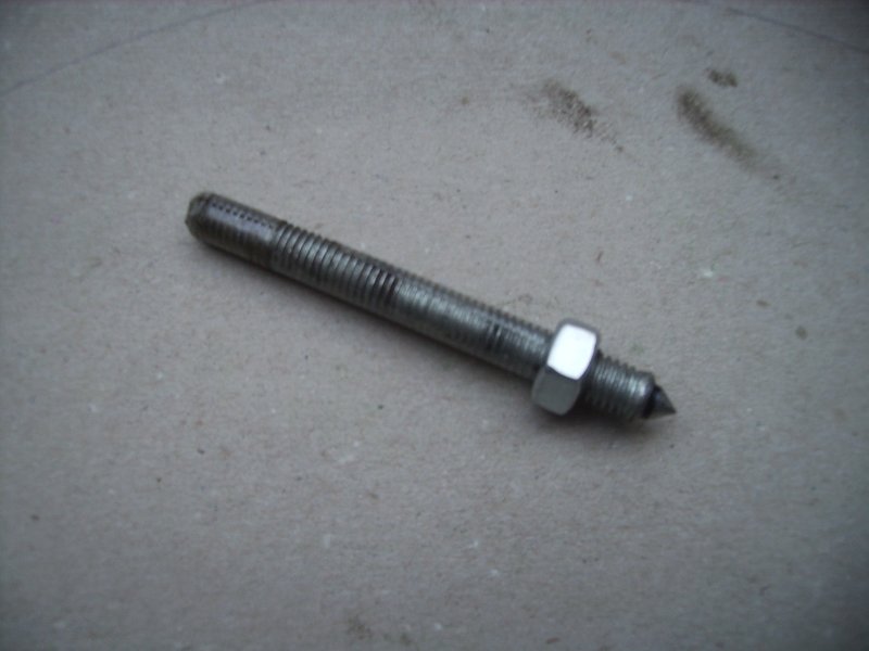

we did some more cad work today. we now have a 'rough' template ready to be transferred to the 10mm perspex sheet. this was made from 2 templates, one for the engine and one for the 'box. centreing the engine one meant drawing a circle the diameter of the crank' flange. and the 'box we had to make a centre point from a bit of 8mm stud turned to a point with a nut to keep it out flush with the face of the 'box. the cutout was then taped back to the engine template and the 2 centre dots aligned for marking them both on the same card. not sure how much we can leave in the middle, the flexplate needs fitting to get some depth measurements from crankshaft to torque convertor. we'll then know what spacer it'll need to push the flexplate back far enough leaving the convertor correctly engaged in the 'box.

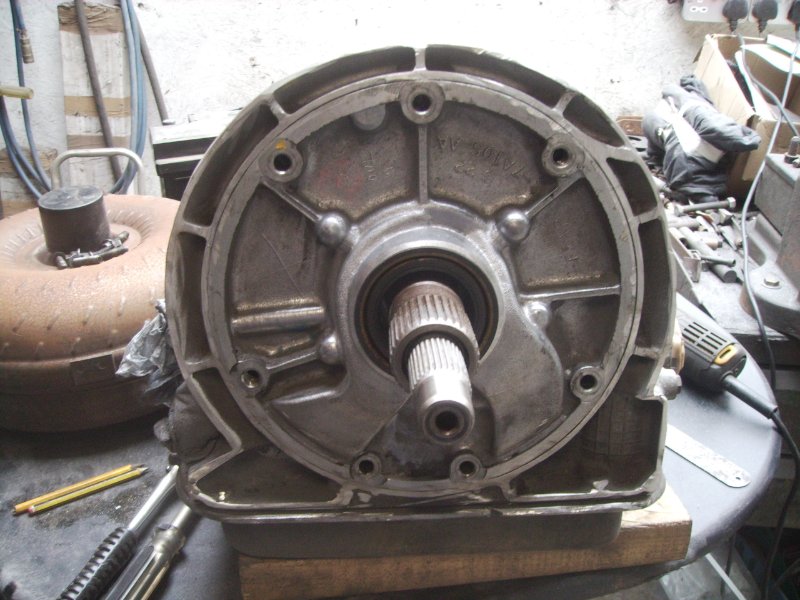

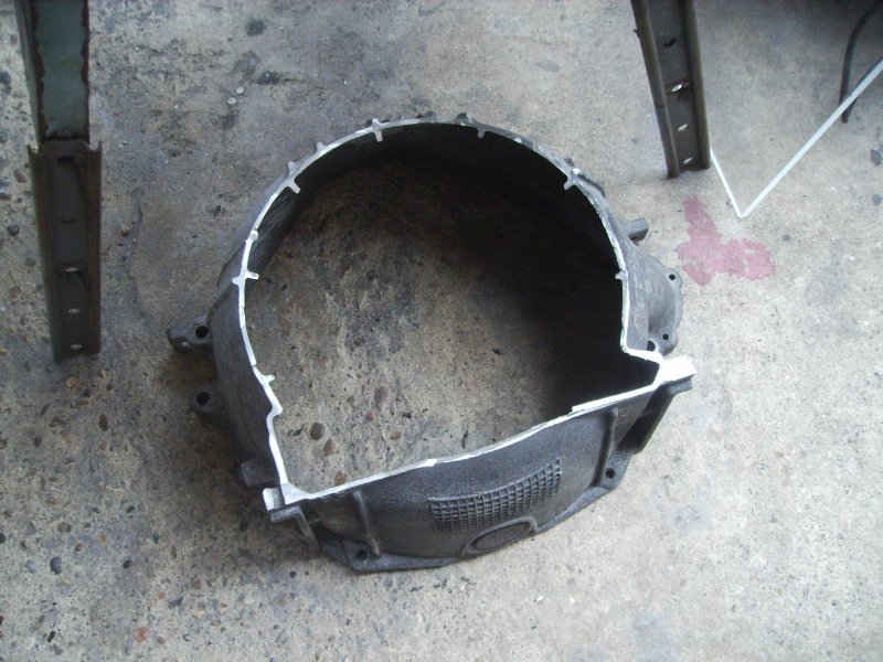

ok..... the fe flexplate is too big to go in the 4r70w bellhousing so adapting the box to the fe that end isn't a homemade job. the other way is to cut the bellhousing off of the box and adapt the fe bellhousing (they unbolt) to the box via the front pump bolts. a quicktime bellhousing is available but as expensive as the adapter plate mentioned above. so some radical surgery was the order of the day, lol. i may even need to drill and bolt the fe bell' directly to the pump if i'm going to keep the stock lockup convertor. we'll see how we go. the last pic shows what it'll look like.

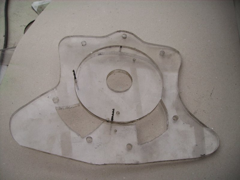

we made a start on the bellhousing swap/replacement today. a cad template of the front pump (big enough to include the 4 bolt holes in the bell' also) was copied to and cut from the 10mm perspex, followed by a disc/ring that's snug on the pump shaft. then another disc/ring is marked ready to cut that fits both on the pump shaft and into the fmx bell'. these 3 will be glued together while on the box, then removed and snugged into the bell' so the bolt holes can be transferred to the bell' for drilling. the bell should then bolt to the pump using the new high tensile countersunk bolts i ordered and the 4 threaded holes in the bell' if there's room.

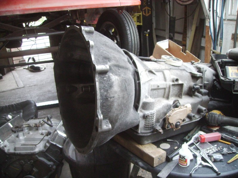

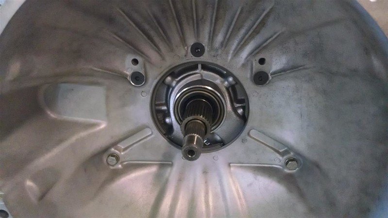

well the bellhousing fits! i'm waiting for the countersunk bolts now so it can be attached for good. some holes come through on sloping parts so will need grinding flat first but that's easy enough. once the right bolts are fitted we can slip the convertor in place to see if any ribs need grinding down inside the bellhousing. the hard bit's done though.

yesterday i thought we'd be at a standstill with the gearbox swap and we are but not for the reason i expected. i wasn't expecting the countersunk bolts to arrive but they did so we set to countersinking the new mounting holes in the bellhousing and trimming the bolts to length. then we bolted the bell' to the box and fitted the converter. this showed up some clearance issues with the ribs inside the bell', which are now ground back. i'm still not happy with how much engagement there is on the 3rd 'step'. soooo..... i've been in touch with my friend who has his own machine shop and he will be milling 5mm from the mating surface of the bell' that bolts to the box. that is the afore mentioned standstill. i don't have a milling machine (nor probably ever will). once done though that'll give the required clearance while at the same time reducing the gap between the flexplate and converter. this will be the last piece of the puzzle finally and will be worked out once the bell' is milled down.

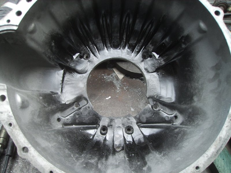

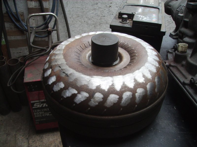

back to the nash, here are a couple of pics of where we're at so far. in an effort to gain every mm we even took the little bumps off of the convertor, another 1.5mm gained. the black paint in the bell' is so we could see where there was still contact when the converter was fitted and rotated, you can see a line of black on the converter in the second pic. still, the machining of the bellhousing should get this part of the swap together with clearance.
