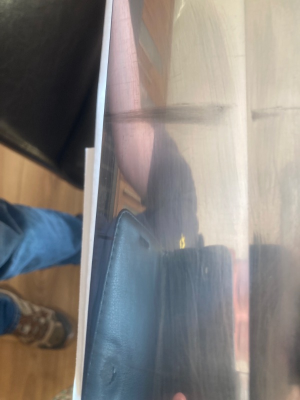

As I’m putting parts back on, I’m trying to get them as tidy and fresh as possible. Having some trouble with the windscreen trim, it has some really odd marks on it.
Not sure how well the photos show it, but it’s almost like grease / oil marks and polishing isn’t gifting them at all. They aren’t surface scuffs, more like it’s stained somehow, so didn’t want to bowl straight in with the wet and dry, but anyone had any success / experience with this sort of stain?

It is stained, aluminium trim is clear anodised to stop it corroding. As far as I know it won’t clean up, you have to sand or polish the anodising away and have the trim anodised again. You can leave it bare but you’ll be forever polishing it to keep it shiny. On my car I cleaned it up as best I could and left it at that. Looks fine a 5 yards…
i've polished various metals and painted them with 2k clear lacquer. then just treat them as a painted part and polish them

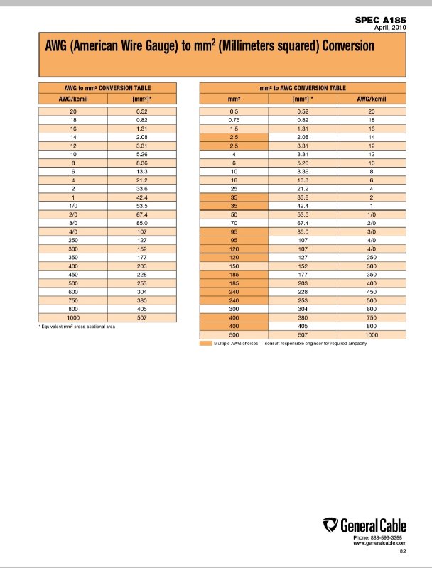

I’ve decided to rebuild the harness myself, but being an electrical thicko, I’ve no idea what gauges of wire to order.
I’ve got a full colour wiring diagram, but no idea how to figure out the gauges! Any helpful advice out there? Don’t want to be responsible for it burning to the ground!

This might help Stu, I rounded up to the next size of wire when making my looms.

I did the same as Dave and rounded up.
You can get nearly a 1v drop over the length of the car if there are bad earths and the gauge is too small..

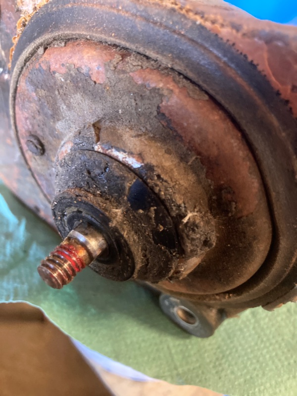

Wiper motor needs refurbing before refitting, so was going to give it a clean and a quick slosh of black before putting it back on, but it’s a bit unclear what gaskets etc should be on there. There is what looks like a foam insert that’s been painted over for a start, can’t see any separate parts for these anywhere and don’t fancy paying for a new unit, anyone any ideas?
Also a couple of rubber seals that look brittle. Anyone know if these are available separately? Getting tied in google knots…

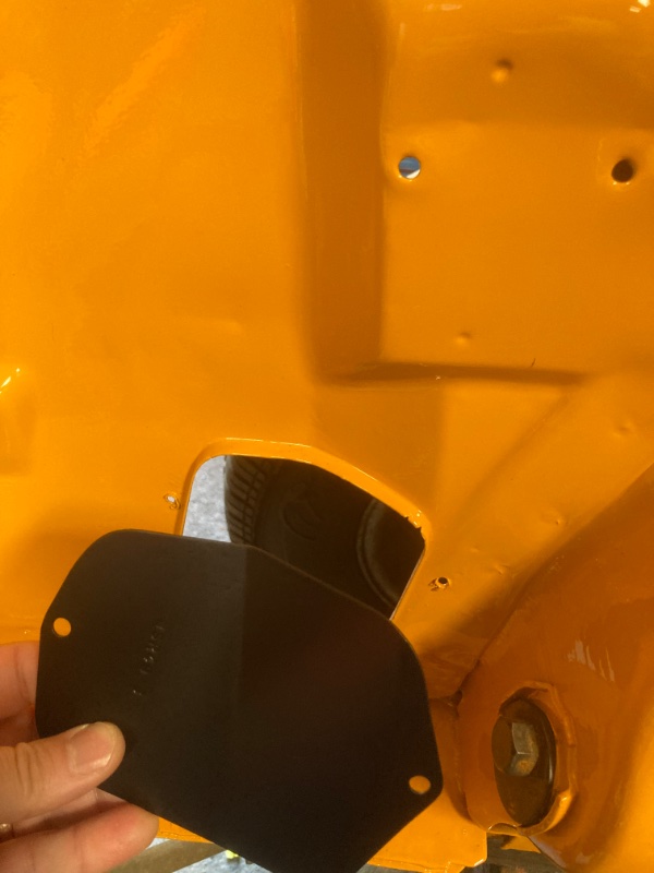

I appear to have *ahem* “misplaced” the clips for these little panels. Anyone got a pic of the correct clips, please, so I can search my stash!? Doesn’t seem to be covered in the manual.
Also, should they be sealed at all, or just clipped in?

They are held in with tiny self tapping bolts, not clips....

Aha, cheers Pete. That’s good news, I have shed loads of those.
