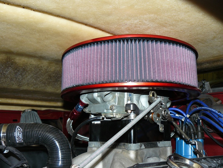

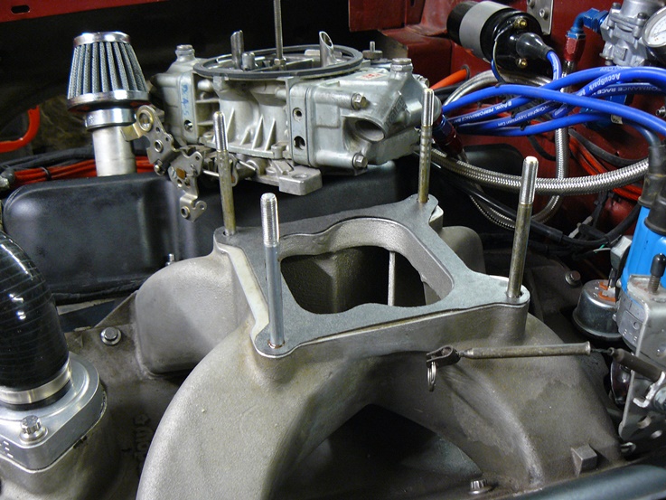

It was sulking a bit cos I'd fitted my 2" carb spacer (thanks to Bozwell's 4" studs) and my new 4" K&N but didn't have time to up-jet it :roll:

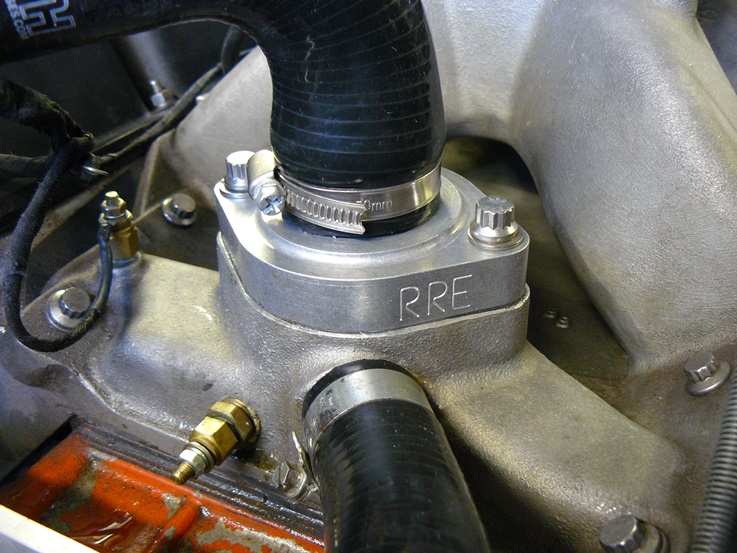

I've also fitted my new Thermostat housing from Trev so no more water leaks.

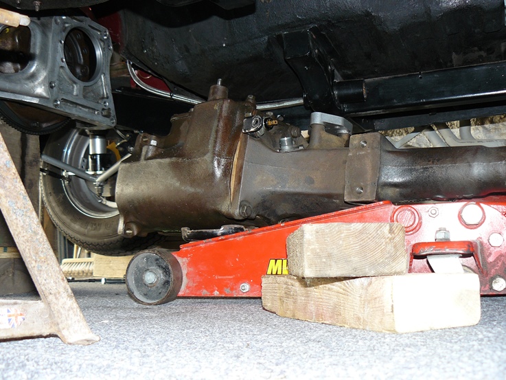

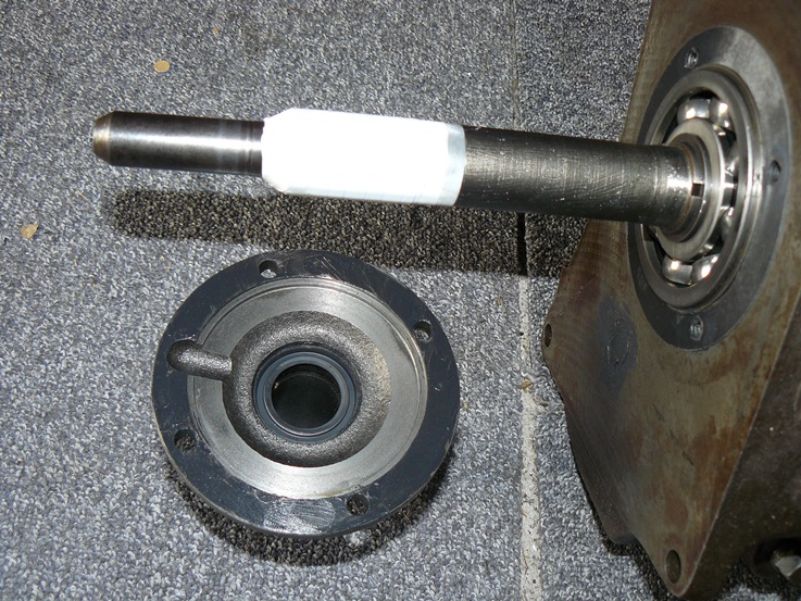

Input shaft seal prep.jpg (216.62 KiB) Viewed 1150 times
4 speed ready to lift.jpg (217.64 KiB) Viewed 1150 times

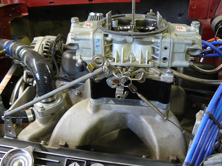

...and the carb bits.

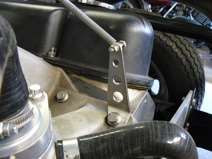

I made meself a little bracket for the throttle return spring.
Carb spacer stack fitted.jpg (210.53 KiB) Viewed 1139 times
Bozwell studs.jpg (196.48 KiB) Viewed 1139 times

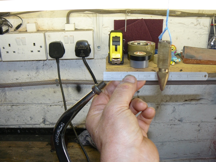

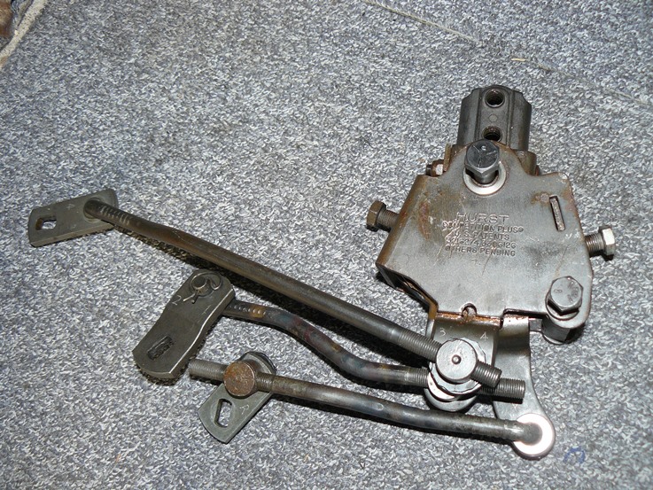

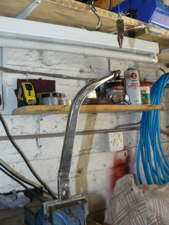

The shift lever i bought turned out to be wrong so i tweaked it a bit.
It needed to come back 3" and 2" to the left.
I grabbed it in the vice and hung a plumb line from the end of a screwdriver i stuck in the shelf above to mark where i wanted it to end up. I'd ground the chrome off and sliced nearly all the way through it with my trusty grinder so i could easily bend it into place.
I welded it up and even though the join is hidden under the boot, i gave it a squirt of chrome paint... jobs a good-un :thumbright:
Shift lever ready to weld.jpg (201.16 KiB) Viewed 1133 times
Shift lever adjustment.jpg (205.3 KiB) Viewed 1133 times
Wow I like the spring bracket I always wanted something like but I am not that crafty or have the proper tools,looks great :thumbright:
And what did you use for the throttle cable linkage ,they look like key rings? :scratch: :scratch:
Love this sooo much
Great work keep these post coming
What is the little bracket made of Alu ?stainless

No more punching the dash on shifts now ! :thumbright:
There needs to be a tang on that throttle spring bracket to stop it twisting. Can't see if it has one in the photo for the top hose.
Thanks Dave- the area to the top left of the bolt contacts the inlet casting to stop it twisting.

Will- I knocked it up out of a bit of old stainless. The finish is scotchbrite & WD40.
Well now I've at last CURED the big leak from the gearbox input shaft, I can see all the minor leaks!!
I've replaced 2 oil seals on the shift pivots, the seal on the neutral switch, PTFE'd the drain and fill plugs and popped off the side casing and siliconed it (quite a challenge with the gearbox still in the car!)
I took it out for a blast today and the trans appears to be completely oil-tight now :D
I've done a bit of jetting too- idle screws out 1/2 turn and up 2 sizes on both main jets. Doesn't that say a lot about the K&N filter! :thumbright:
