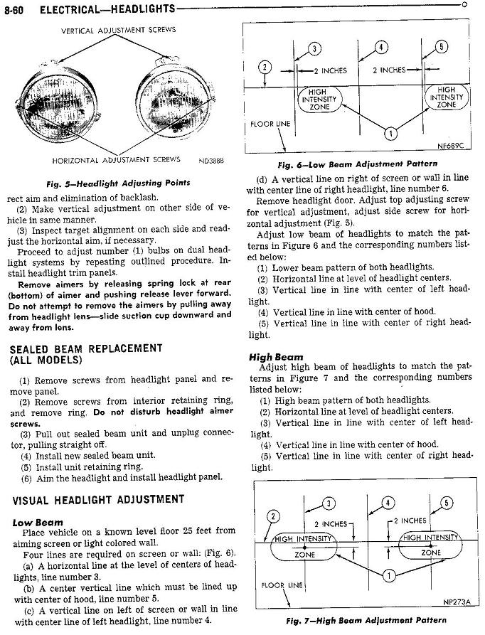

I think I just remembered how to set the headlights.
You have to be 25 feet from a wall and you mark a wall with a horozontal line at the same height as the center of your headlights.
You then place two vertical lines the same distance apart as your lights through the first line so that they cross exactly where the center of your headlights would be.
From 25 feet on main beam the light pattern (if I remember right) should be centered on (or is it just below?) the crossed lines.
When you switch to low beam the pattern shifts to below and to the left of this point.
This is what I'm using Dave
Obviously it's from the manual so you have to reverse it. :read2:
Manual 004.JPG (162.95 KiB) Viewed 695 times
Excellent! :thumbright:
I never thought to look in the manual. :oops: :roll:
Mind you. To get 25 feet to my garage doors I will have to block the road. :lol:
Yeah, I'm having the same problem :thumbright:
I have a neighbours garage which is perfect, white doors right on a bend in the estate. I wait until he goes out to work and then put electrical tape on it and measure up (shhhhh don't tell anyone :D )

do it at 12.5 or 6.25
use a bit of pythaggy
(short side)^2 + (next longer side)^2 = (the long side )^2
so (SS)^2= (TLS)^2 - (NLS)^2
square route of what ya get is ya new short side measurement
Rt angled triangle innit.

OK
basically if you work it out its not worth working out.
in fact this is probably the first time ive used it since i sat my exams...useful yes but not very often as i rarely have to work out ow far over the river the hook on my line is when my rod is at is 12 foot long and my line is hanging only 4 foot from rod end to surface of perfectly flat river with a bank of exactly 2 foot above water level.
at 12 meters its just less than 2 inches for the pattern to move
