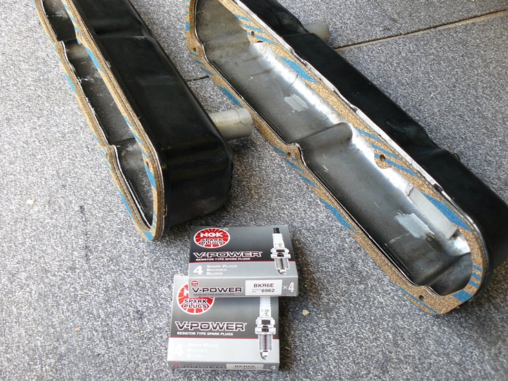

Parcel from Hausers today!
New plugs gapped and ready to fit for the Nats.
New Felpro 0.3" rocker gaskets with steel insert, to sort out two major oil leaks :thumbright:
Gaskets look good quality Paul. Out of interest how much ?
£35 plus delivery. They're $35 in the U.S. so a pretty fair price from Hausers
Ta mate.
Good price. My covers drove me mad. Oil straight on the headers. Nice !!!
Resolved with Mopar performance covers and gaskets. :thumbright:
Can't beat a bit of cork though !
and they have a thin steel layer sandwiched in the middle so they can't belly-out, which my old ones were starting to do.
