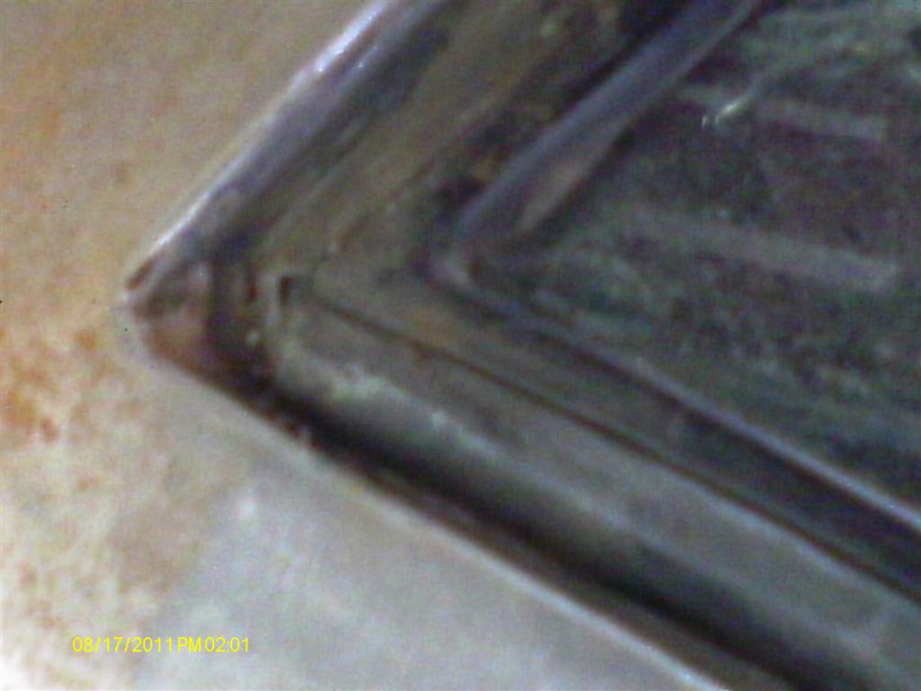

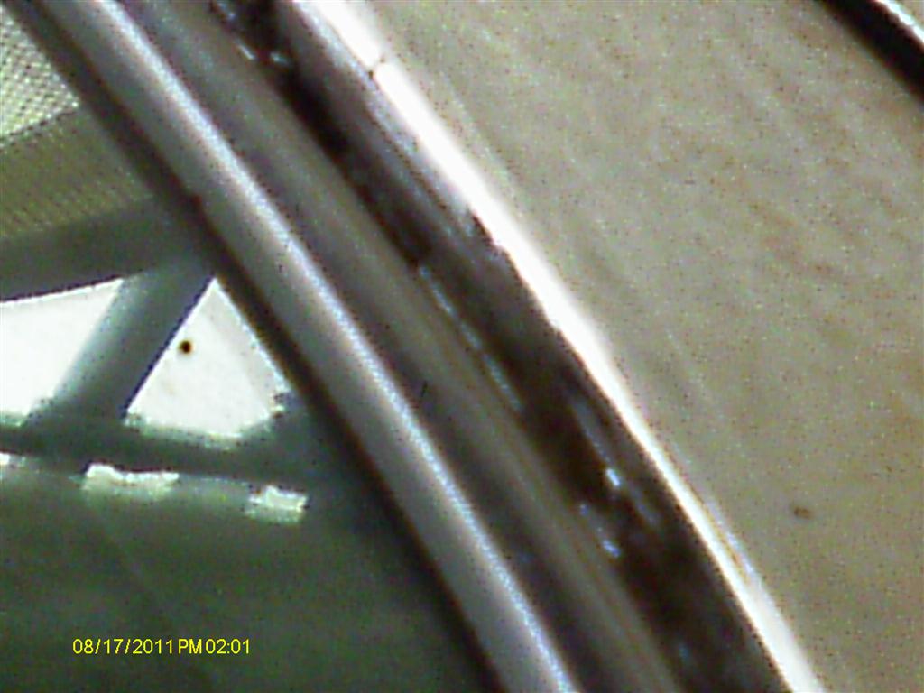

first pic is the rear window , I had filled it with gutter seal about 25 years ago coze I had lost the trim now all cleaned out ready for paint and thanks Dunc for the trims that you had at the nats !! good price too !2nd pic is much the same but top end of window clips have been removed long ago and holes filled up as the clips were rusty and leaking
clear out (Medium).JPG (89.66 KiB) Viewed 1426 times
cleaning (Medium).JPG (102.45 KiB) Viewed 1426 times

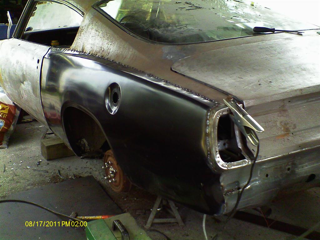

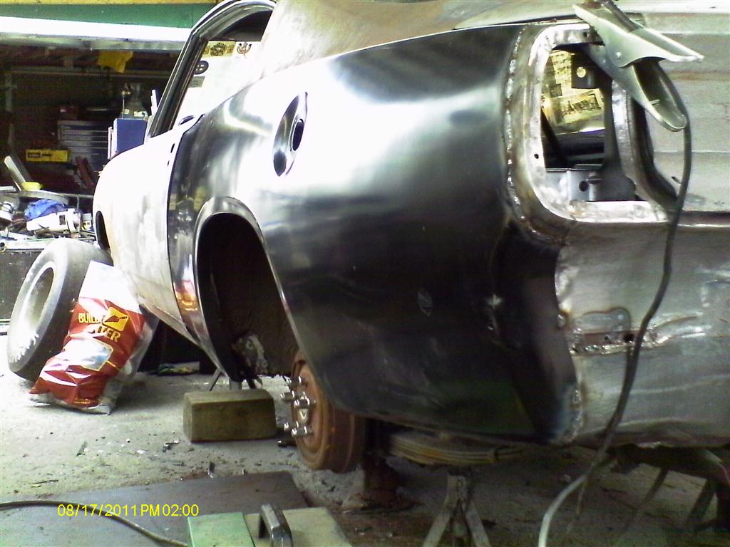

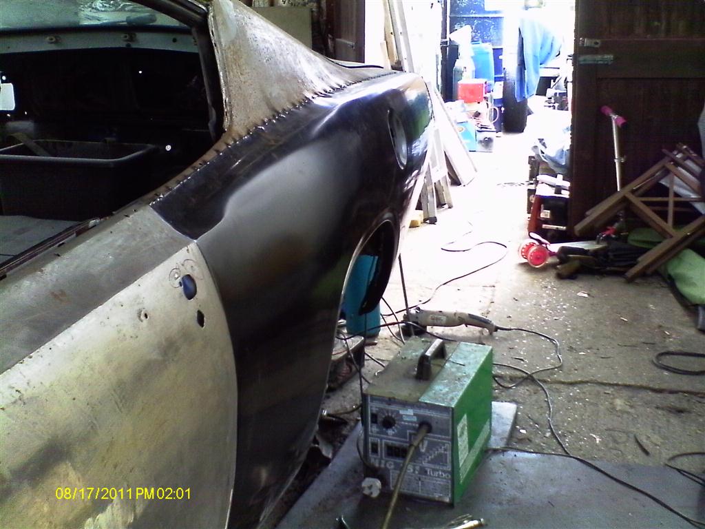

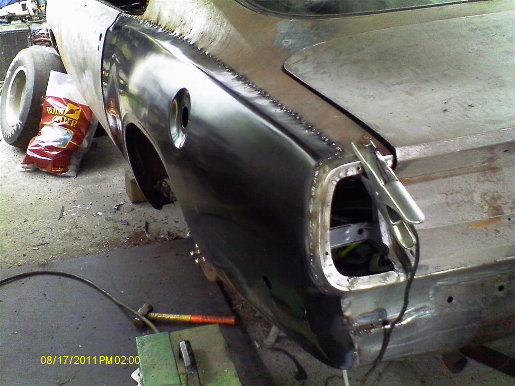

rest is just back end stuff with new metal !!!!!!
rear qtr (Medium).JPG (152.63 KiB) Viewed 1414 times
rea end (Medium).JPG (148.05 KiB) Viewed 1414 times
on (Medium).JPG (150.73 KiB) Viewed 1414 times
more weld (Medium).JPG (96.39 KiB) Viewed 1414 times

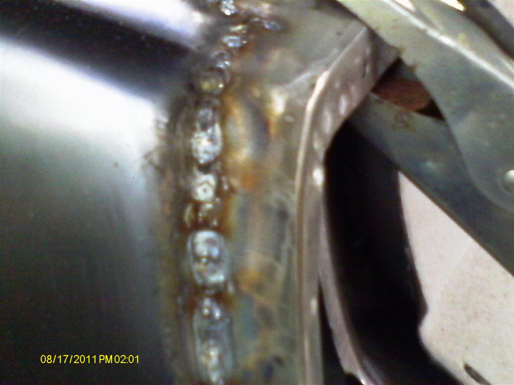

OOOOOps forgot one !!!!
welding (Medium).JPG (144.78 KiB) Viewed 1415 times

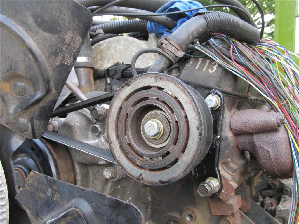

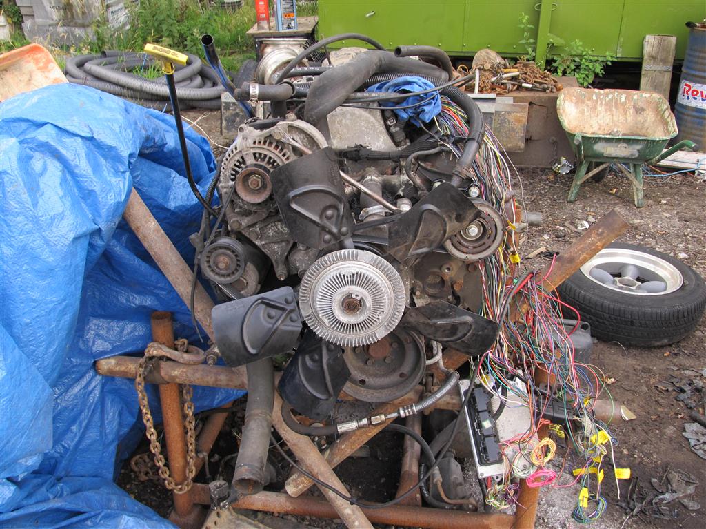

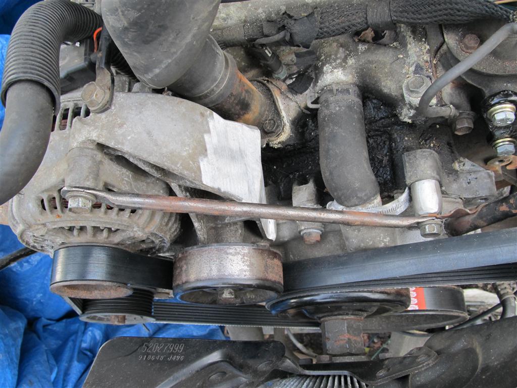

Got some pics of the engine work that I have done this time useing my camera !
the shaft and pulley that you can see is one that I made , the pulley came from the A/C unit and I had to make up a plate to get the run for the belt right , the wiring looks like a mad spider has been there but when yo see what I had to cut out as I did not need the ABS or A/C wires then it make sense !! it took me about 2-3 days to make it out I found that I could not do it for long as it gave me a headache !!
engine etc 004 (Medium).JPG (140.3 KiB) Viewed 1363 times
engine etc 003 (Medium).JPG (148.3 KiB) Viewed 1363 times
engine etc 002 (Medium).JPG (146.11 KiB) Viewed 1363 times
engine etc 001 (Medium).JPG (184.29 KiB) Viewed 1363 times
John Rutledge

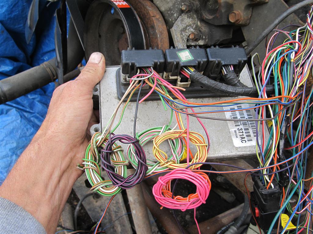

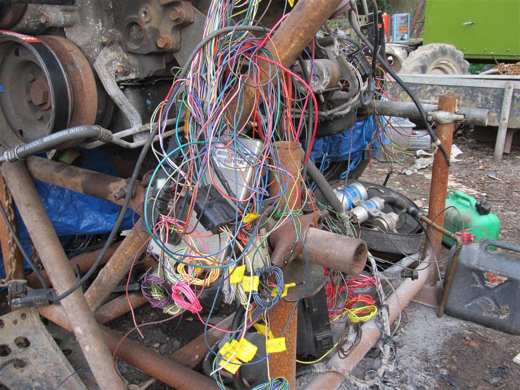

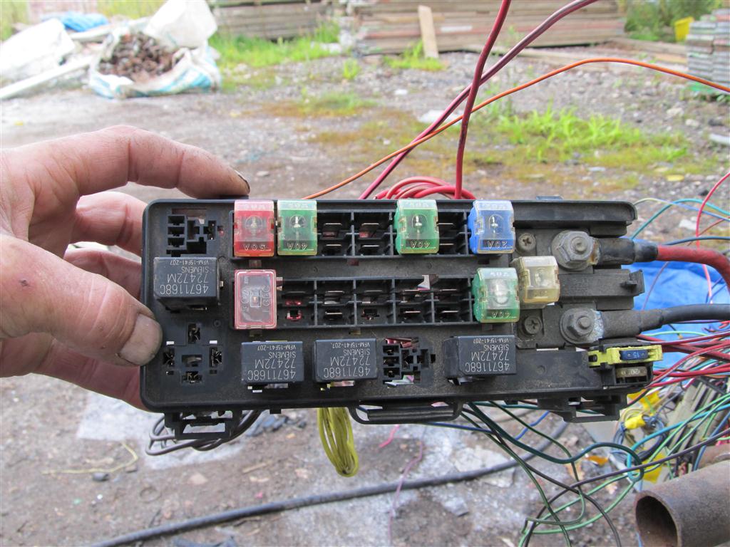

Some of the wires !!!!!!!!! now all I have to do is tidy them up into some sort of loom !the bottom pic is some of the bits I had cut out
engine etc 007 (Medium).JPG (138.54 KiB) Viewed 1357 times
engine etc 005 (Medium).JPG (193.66 KiB) Viewed 1357 times
engine etc 008 (Medium).JPG (166.02 KiB) Viewed 1357 times
engine etc 016 (Medium).JPG (150.55 KiB) Viewed 1357 times
John Rutledge
