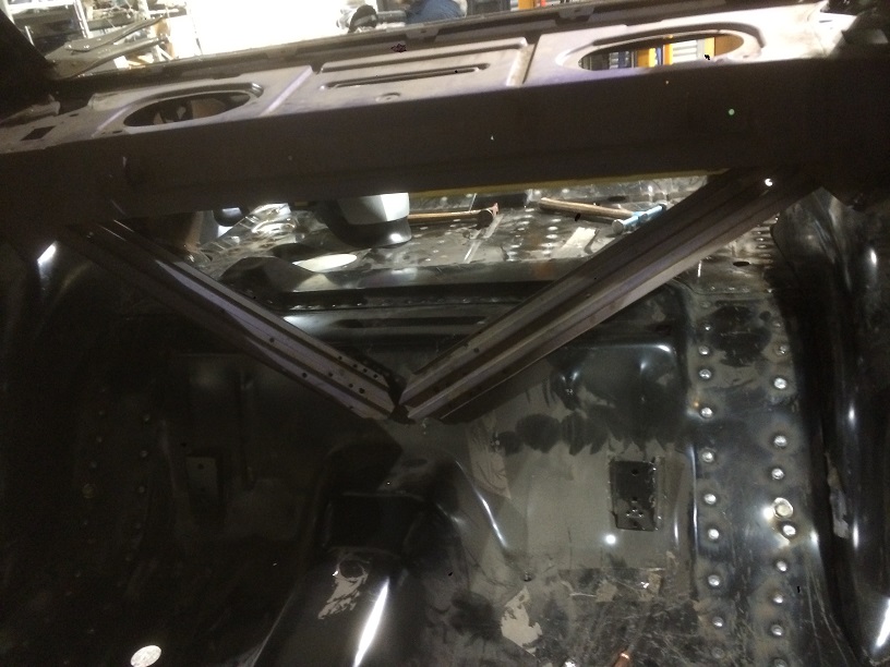

and time to fill all of the plug holes in after a final measure. Rear drivers wheel arch will need cutting and a fillet welding in as AMD one is an inch too short!

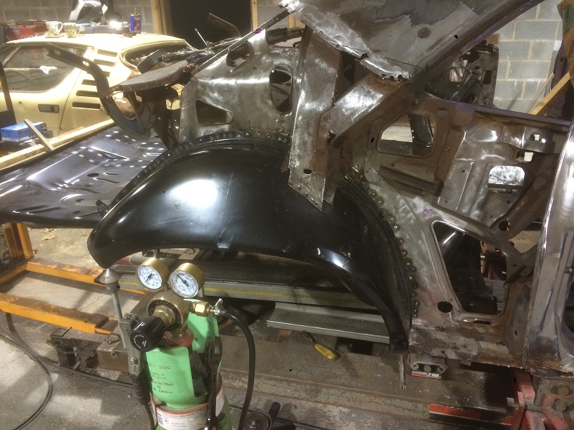

now the arches can go in and fit to the chassis and floor, rear quarters checked for fit again!

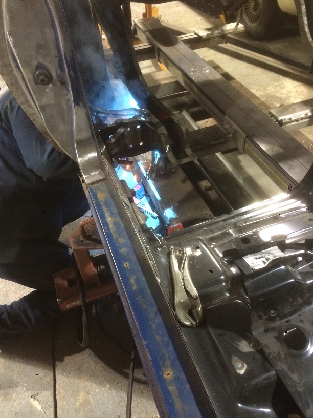

finally welding rear frame rails in

Both of our wheel wells came up short by and inch, and the trunk floor was short too,AMD it is nice to have new panels, but sometimes I wonder, perhaps our car was way off from the factory, :?

The passenger side arch fitted fine after some hammering, although the holes didn't line up as the original. The trunk floor was about an inch short too.
I'm not sure what the tolerances in the factory were but we have the rear chassis to within 2mm of the drawing, going to have to get some frame connectors to reduce the flex and make sure everything stays the same.
The Inner fenders panels that overlap at the back are 10mm different to each other in length and they are factory parts.

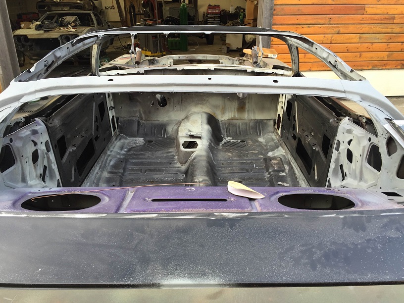

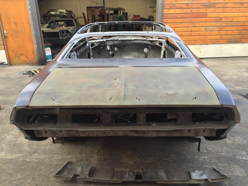

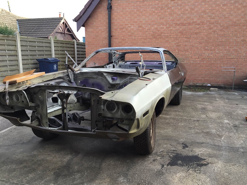

Floors are in at last. Transmission tunnel repaired and in, lots of hammering and beating the arches and wings to get them to fit with the doors, roof cleaned and repaired and ready for on, cowl welded back on with all of the front end assembled, welded up. Before welding up the car went to the sandblasters for the first time, there were more holes in the roof rails, so cut them out and welded them back up!
I have also restored the hood by taking a good skin off one and welding it to a more repairable frame from the other, boot lid still needs a rear lip and some repairs.
The plan now is to spot-weld all of the rear panels on, beat the roof corners into the right shape so it sits much better on the car and weld it all up!
