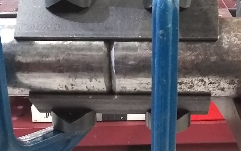

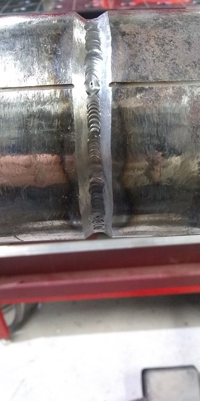

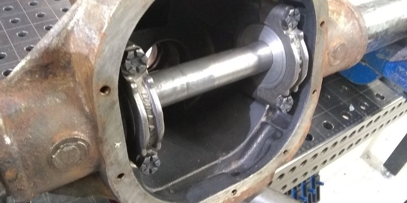

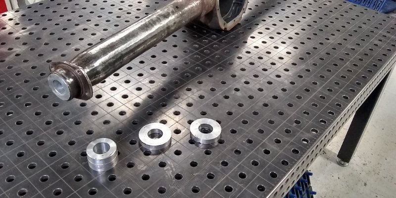

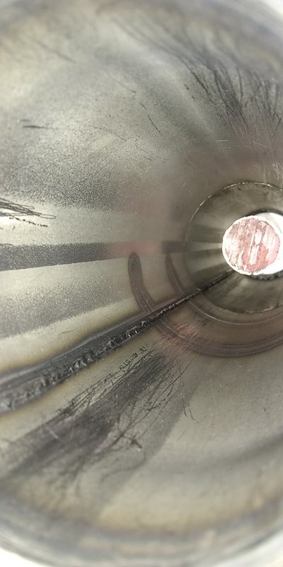

Well reading and watching over .. :read2: Time to weld
I used tig as I like the control, made some bearing replacement supports
All lined up Image

Post by TIB3300 »

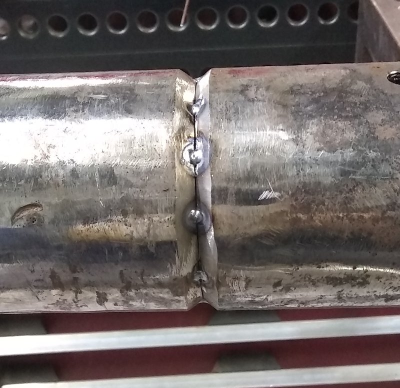

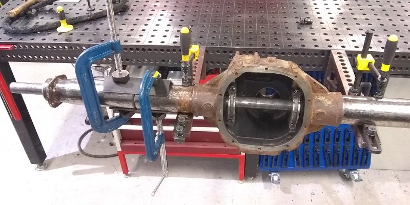

First multiple tacks, then small seam welds around 40mm long.
As a full weld could course miss alignment due to the welding pulling the tube. So I welded one side then the other filling in bit by bit :thumbright:

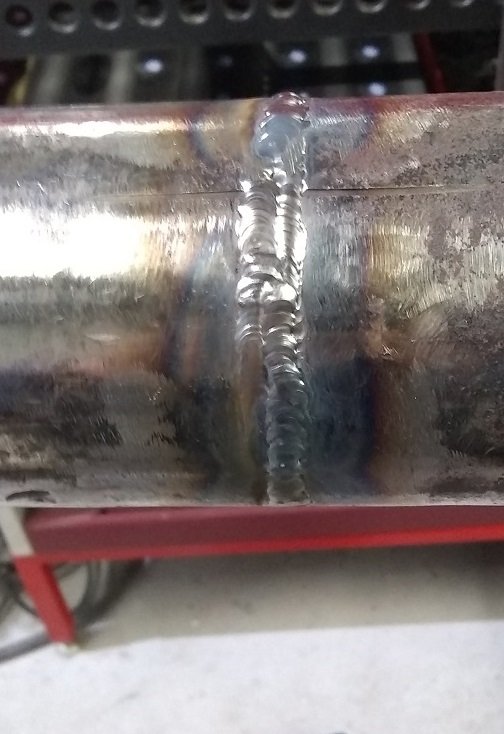

Re: Cortina MK3 V8 MOPAR
Post by TIB3300 »
After welding nice and free :)
Posts: 9561
super.....looks perfect

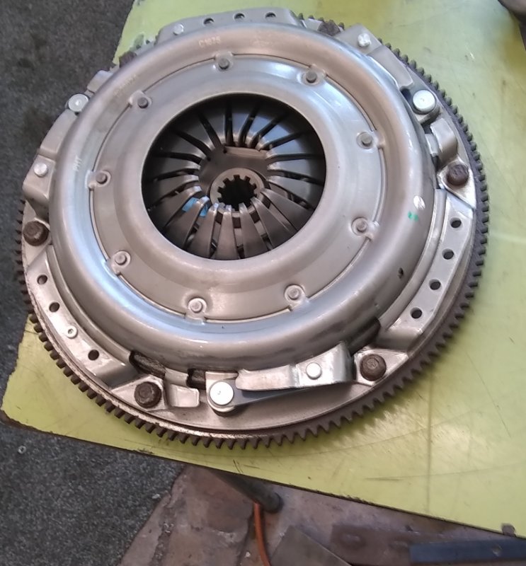

So I bought a Dodge 10.5 clutch and a Mustang V8 10.5 plate Happy days,
Its a bit close in the centre, but what you can see is a Dart 10.5 flywheel with dodge pressure plate with a Mustangs friction plate

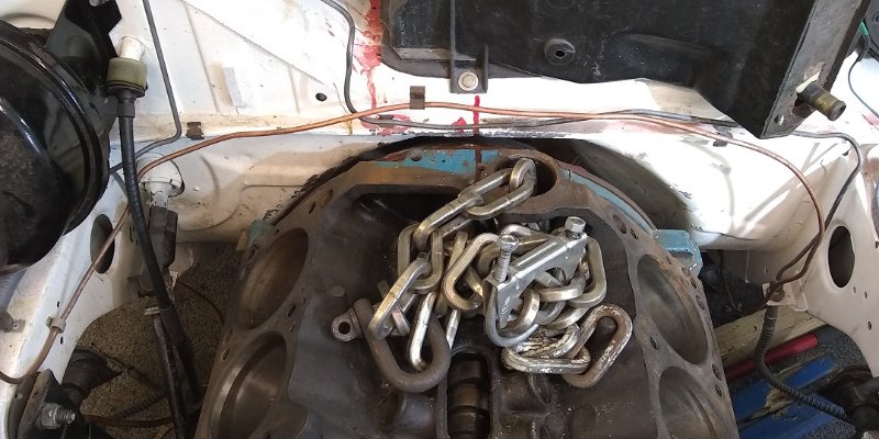

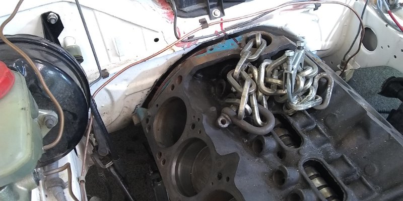

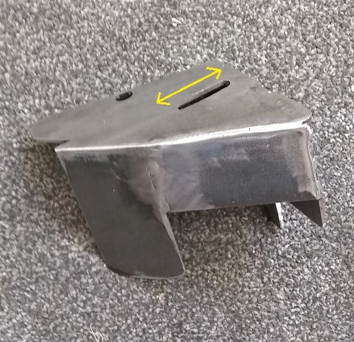

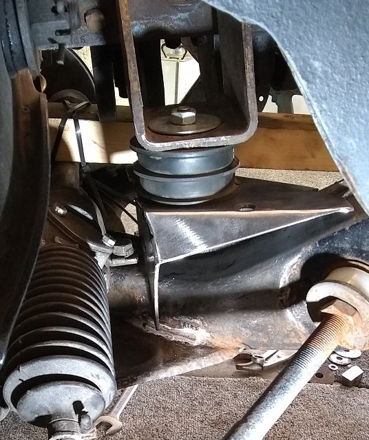

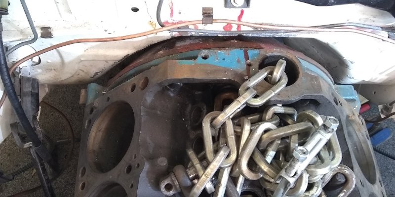

Started on my fully adjustable engine mount locations :)

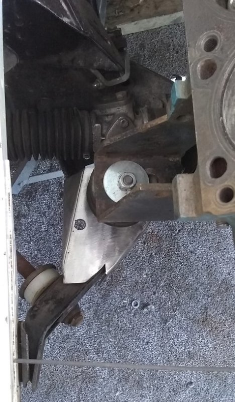

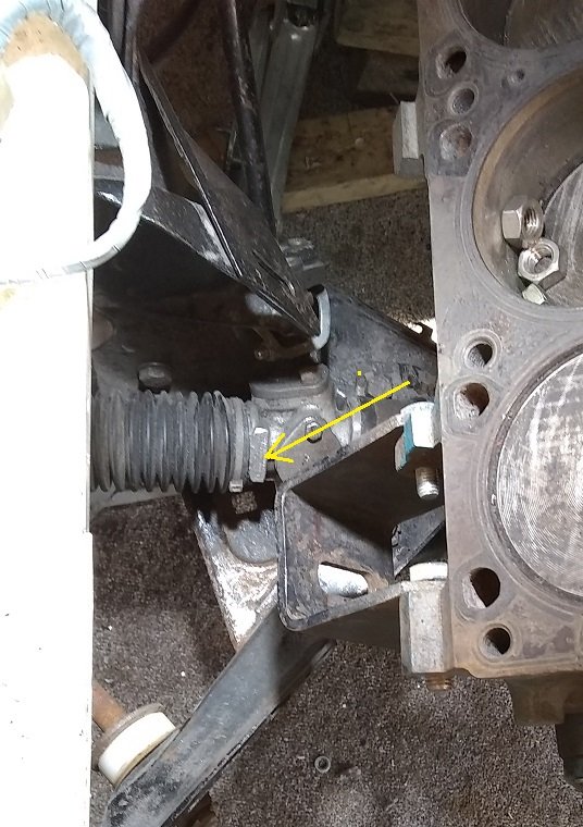

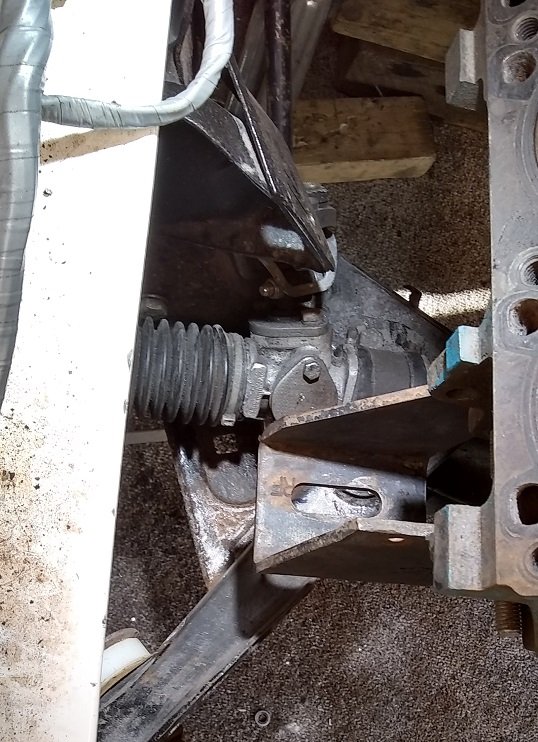

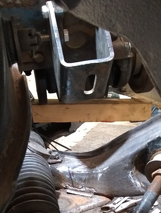

I found out that if I rotate the original engine mounts they face down to the cross member

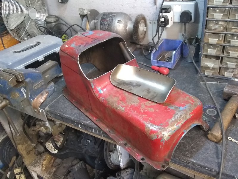

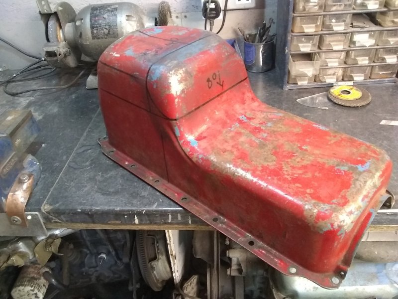

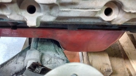

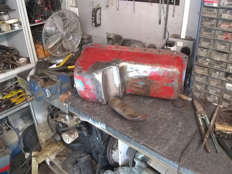

Been busy with the gearbox crossmember, but todays job was the sump.
After mutch measuring , I cut out a section so it fits nice away from the engine crossmember.
First picture is how it was!!

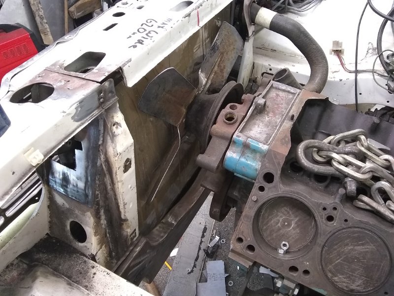

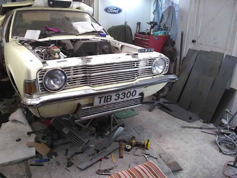

Lots of time on the car with the lockdown, been working on the cooling side and front panel.
Ive gone for a nissan 300ZX turbo rad, but with the engine being quite long I have not gone for the usually cut out front panel.Ive decided to put the rad under the front panel.
This means that to rad now is lower than the front valance . So starts the custom work, vwala? to my stores ,,and found a MK1 escort grill, chopped it down :lol:
Not finnished yet, but you get the idea. :?
A bit like the new'er cars with the inter/cooler sticking out 8-)
Fantastic work, but watch out for reduced sump capacity - that is what saw off the 396ci BB motor in my '57 Che*y....
mygasser
Posts: 1376
Location: faversham, kent
Post by mygasser »
Pete wrote: Thu Jun 18, 20 9:52 pm Fantastic work, but watch out for reduced sump capacity - that is what saw off the 396ci BB motor in my '57 Che*y....
maybe add a bulge to each side to compensate, although myself i probably would've notched the rear of the subframe and left the sump.
