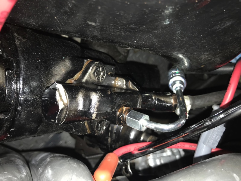

Can you jack the front of the car up and with the engine running turn left and right in an attempt to bleed the system?

This is the bit you need to adjust, undo the 2 nuts just a bit and either tap it up or down but only a 1/16th of an inch at a time.
Posts: 4226
Re: Morgans 68 Charger. Engine #3...
Yep - thats the one...
In fact, if you look at mine ( newly rebuilt) you can see where its moved (unpainted, needs to tap towards camera) so i think first thing is -
A) jack it up and bleed.
B) tap it back to where paint suggests and see what its doing.
With no pump the box works fine so i dont think there is anything terminal.
High hopes. Let ya know. :)

Had same with mine after re-build !!
When I removed the valve body I discovered they had re-fitted the Pivot lever upside down - put it the right way around, slight adjustment all fine !!
Posts: 4226
Well, good news is, adjusted and steering works ! ( yay!). Too far other way now but we can play. Phew !
