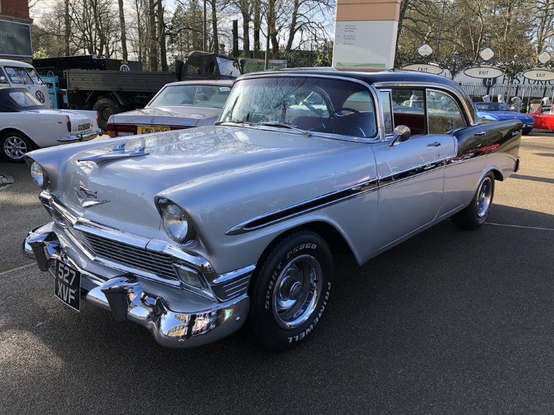

Re: what are you doing while at home?
Andy, I look forward to seeing the 56 at KK when this is all over.
you never know, you might do lol, ive got a mate chomping at the bit to get his hands on it when its readyDerek wrote: Wed Apr 29, 20 11:25 pm Andy, I look forward to seeing the 56 at KK when this is all over.
