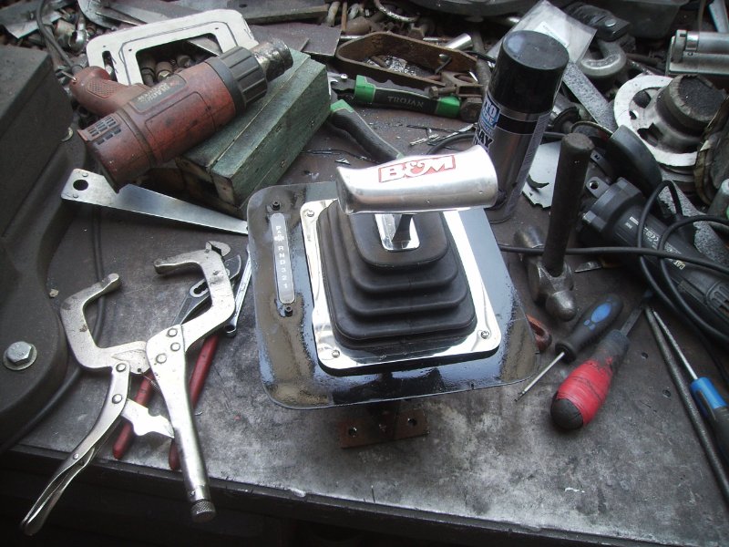

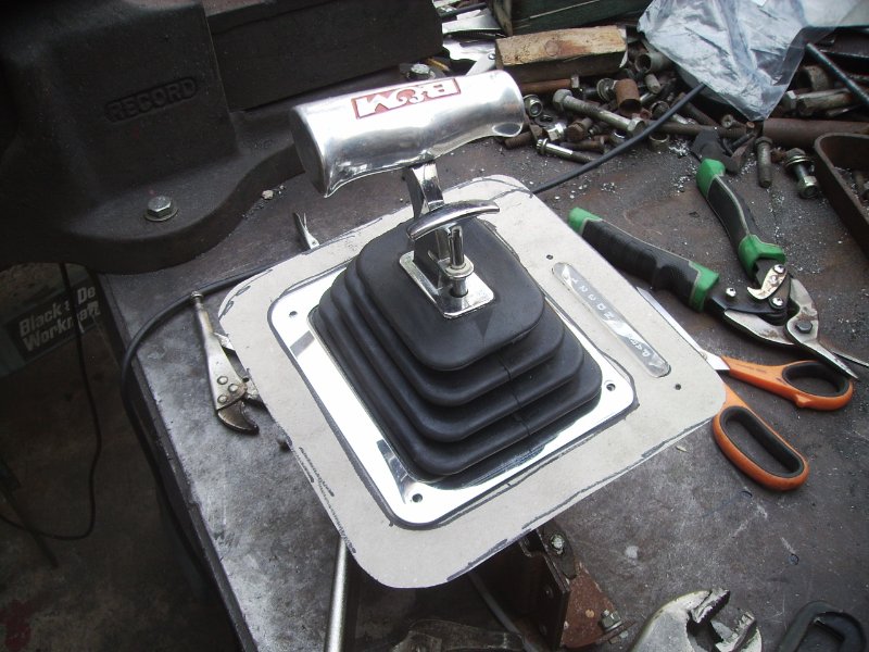

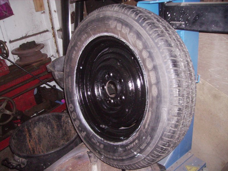

the new fence is done so back to the car. the new shifter boot is wider than the original so it would cover the gear indicator as is. this means we need a new back plate so today some cad work was required as always. once cut and painted we'll just need a 'box' to mount to the tunnel or even a console as i have seperate front seats now instead of the bench. also some tidying took place (shock horror!) so we could get the spare tyre rimmed up after painting the wheel. the nash is ford/mopar 5 stud which is handy so i just picked one of the 5 that it came with to use.
neil.

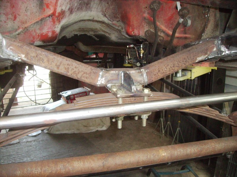

today we made the plate for the shifter and reassembled it all. then i looked at the front spring crossmember to see the easiest way to drop the axle 2" from the chassis. then it dawned on me, why not cut the perch off of the top of the crossmember and reweld it below. so that's what we did and that's that sorted.
neil.

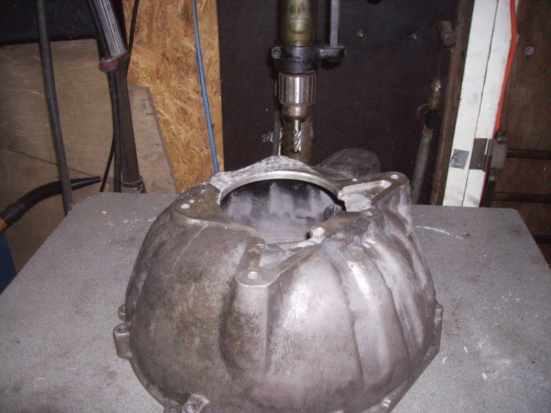

so.... most 'smaller' milling machines are listed/advertised as a mill/drill. on that basis now my bigger 'commercial' pillar drill is set up i thought why not see if we can use it for milling too. specifically my bellhousing, but if it works other stuff too. so i bought some straight shank milling cutters (4-12mm set of 5) that'll go in the drill's chuck. i've been looking on ebay for adjustable 'bed's) to bolt to the drill's platform but to no avail. then i thought all i need for now is a stiff flat 'something' that'll bolt/screw to the drill platform and we'll experiment from there. looking through my garages of crap i found a lump of 40mm worktop about 3ft x 2ft so that'll do. as i said it's all experimental for now. if i balls up the bellhousing there's one the same on ebay for cheap so the way i see it there's not much to lose. anyway that's the plan.
neil.
ps if anyone has a milling bed/table that adjust left/right and back to front for sale let me know, we may be able to have a deal.
mygasser
Posts: 1416
Location: faversham, kent
Re: '58 (nash) rambler american family project
Post by mygasser »

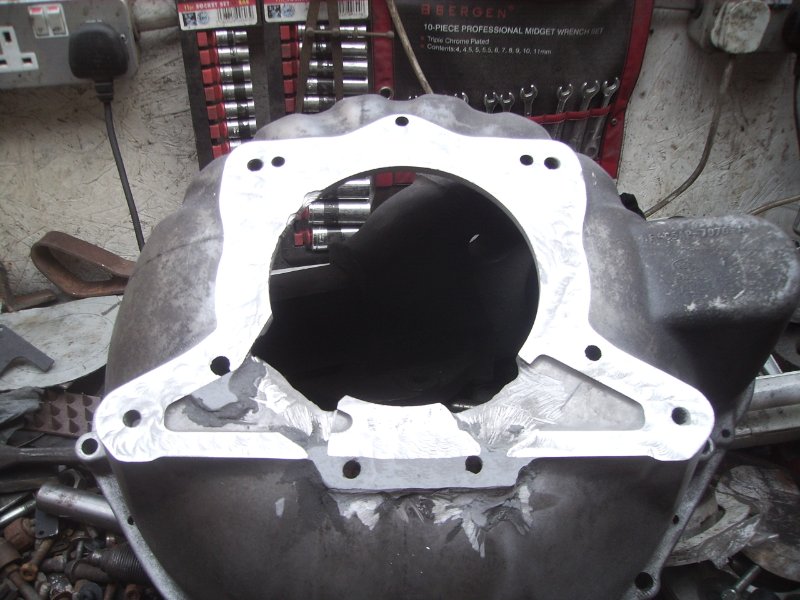

well my heath robinson milling machine works, with 2mm removed from part of the face. top tip though...... don't get body parts anywhere near the cutter! yes i did and that ended today's fun while milling a chunk from the side of my left thumb too, lol. anyway here's pics of today's, er, results.
neil.

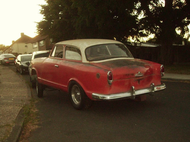

today so far we've made room over the road for the nash and got it back down on it's wheels. before lowering it i remembered the new halfshafts were just slid into the axle so the wheels could be mocked up. so the wheels were removed followed by the shafts and the rear diff cover. the pin through the planet gears was removed and we fitted the new outer hub seals. the shafts could now be slid in and the 'c' clips fitted into place. then refit the pin, clean, seal and bolt on the diff cover and finally the wheels. later when it cools down a bit we'll Bananarama! over the road ready for the ute to come in.
neil.
ps when the nash is outside i'll take some pics, the front's really high now we've relocated the spring under the crossmember. good job it'll go down a lump when the cast iron big block's sat in the engine bay, lol.

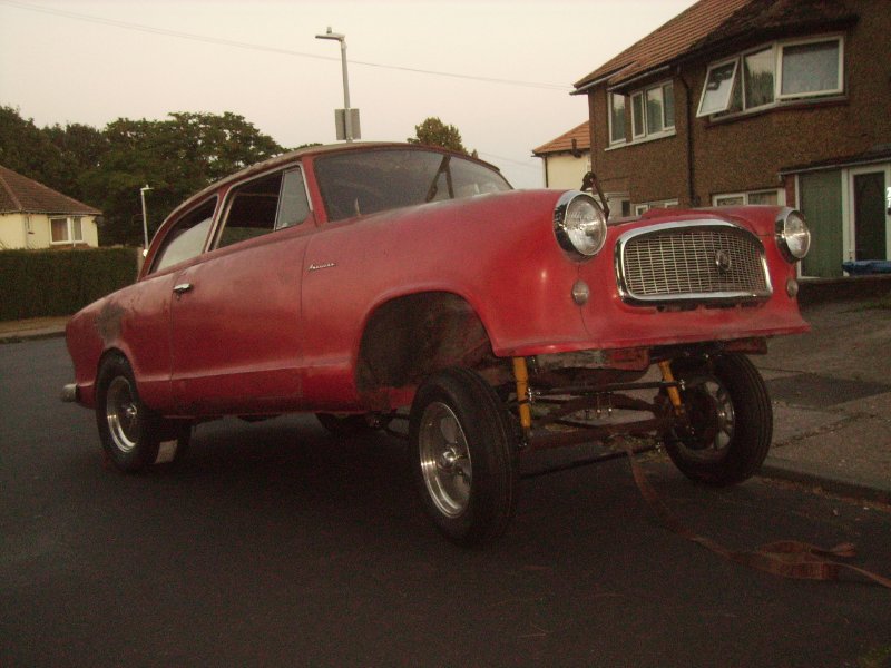

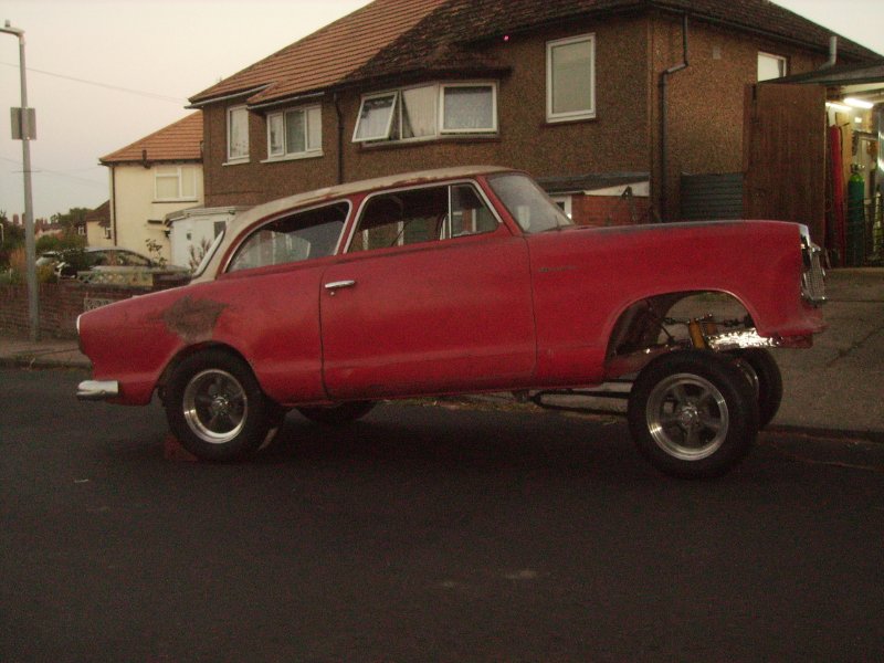

here's the first pics since the car has gone gasser, lol.
neil.

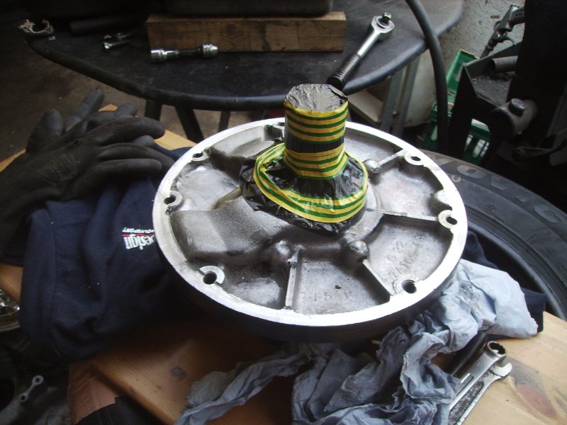

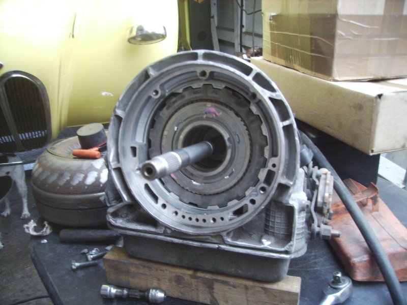

back to the nash for a bit. we finished milling the bellhousing, we sped the drill up which helped tremendously. this gave a much smoother finish. there was a little triangle we couldn't access by the starter bulge but it was only 3/4" ish so nipped it off with the grinder. next we pulled the pump out of the box ready to machine that flat too.
neil.

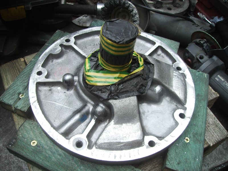

we made a start on facing the pump in the lathe today. we're in as far as we can go as there's 2 raised sections which i assume have to stay. from here we'll make a box/sleeve to sit it in and mill the rest. we marked where the open centre of the bellhousing is in the 'ribs' of the pump face and the plan is to mill that far so the pump centres not only on it's bolts but also on the bellhousing too. that's the plan anyway.
neil.

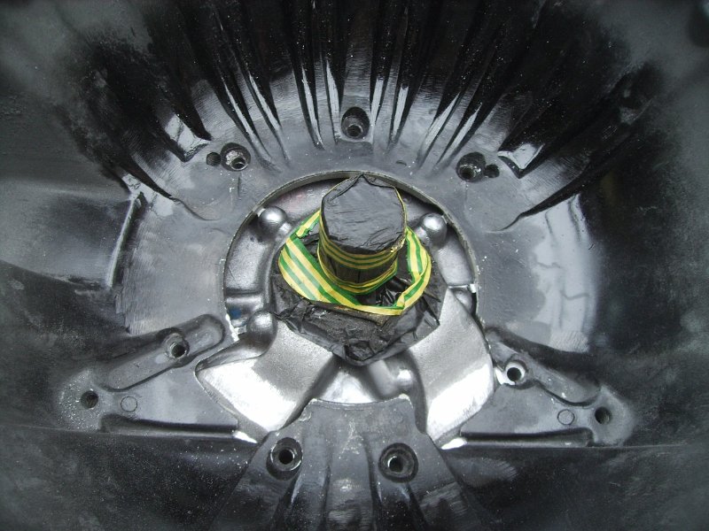

well milling the pump was pretty straightforward today which was nice. then we offered the bellhousing to it and that needed lots more taking off where the 2 'bumps' on the pump are. after an hour-ish of grinding and offering up we got there. there was lots of cheapskate 'engineers blue' (sharpie) used to mark the area before each offer up to see where more needed removing, lol. i'm going to get new pump gaskets/'o' rings before reassembly so there's no leaks, oh and front and back oil seals too while we're there.
neil.
