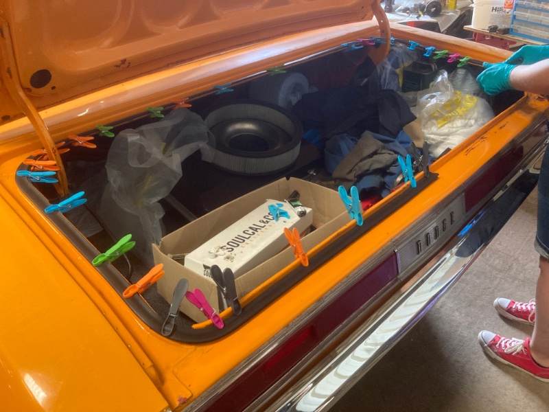

I really wanted to get the rear springs done today so I could measure for the prop, but think time has got the better of me.
In the meantime, my good lady has been doing a cracking job of the boot seal for me. :D

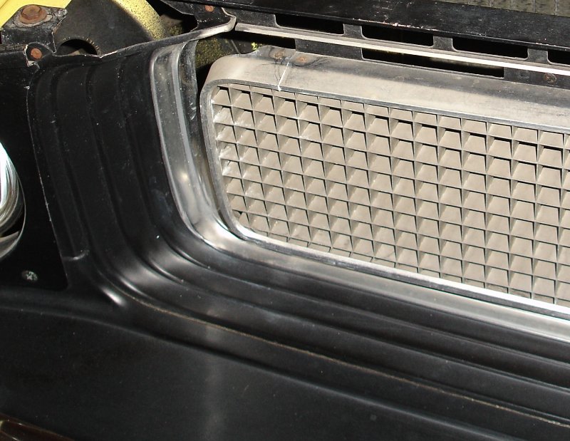

First go at tinting the inner beams. Not an easy job, but reasonably happy for the first attempt. Will have a few more practice goes before I do the final install, but I really like the look. :rr:
Don't want to be picky but you should have left the leading edge of the grille and the area around the mesh unpainted. Unless it's damaged?
