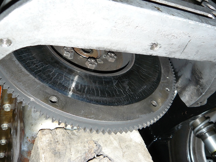

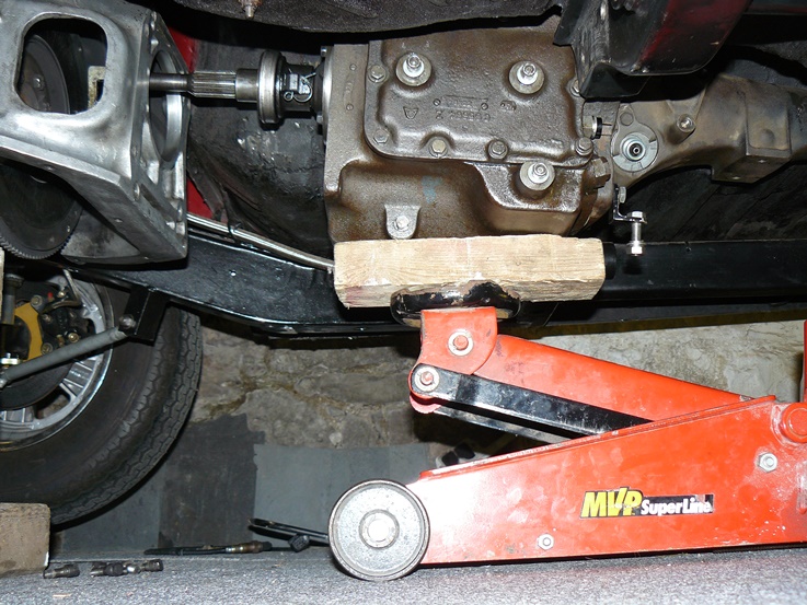

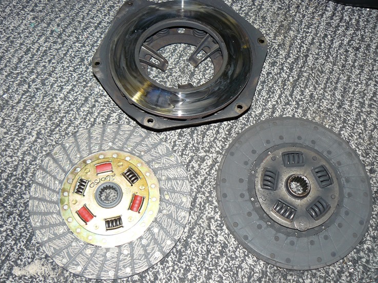

Big thanks to Mike (Mad Machs) for a replacement fuel bowl, I also picked up some Teflon seal strips so my 750dp is back on the car, no leaks so far and the car starts fine. All ready for the next tuning sesh... :thumbright:
NEW CLUTCH ARRIVED! Gearbox out and clutch off last night.
The old clutch and the flywheel are already showing signs of abuse.. Santa Pod may well destroy them :shock: :D
Clutch plates 03.jpg (232.48 KiB) Viewed 1084 times
Flywheel 02.jpg (206.1 KiB) Viewed 1084 times
Gearbox pulled back 01.jpg (214.05 KiB) Viewed 1084 times

That flywheel looks kippered to me, but I am sure you are going to re-use it ;)
Welcome to the world of swore-speed transmissions.............
The flywheel is fine, rough it up with some emery and git 'er done. I'd be more worried about that aloominum bellhousing if anything did let go, do you like your feet?

Post by correct direction »
Four speeds are great if you use a good quality clutch,used a centre force diaphram cover on my Satellite never missed a gear,even in anger.plus not as heavy as the spring type units.
