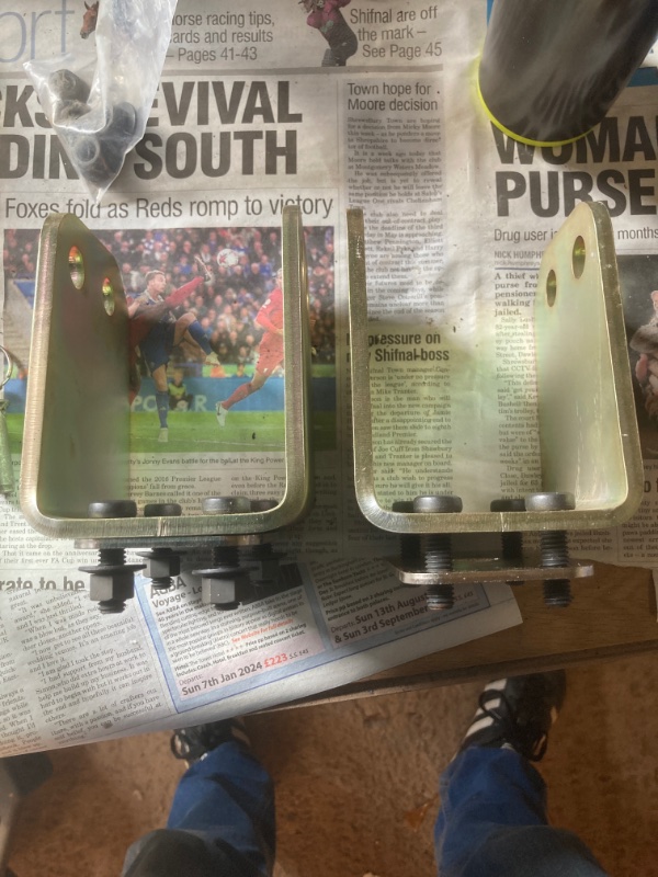

Fair do’s. They came in one box and look identical on the face of it. I’ll see what tomorrow brings for a mock up if I can make some time to get to it.
Yea the bolt pattern looks equal but is isn’t.

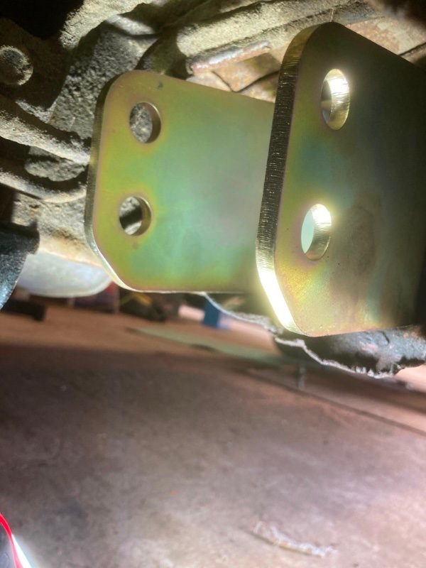

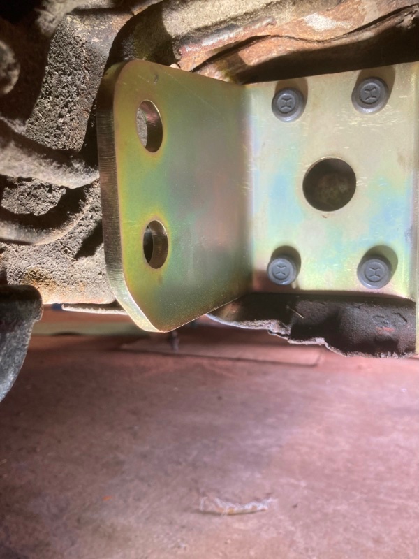

Well, you are absolutely correct, the front hangers are a different hole distance at the top, so happy days, passenger side spring out and quick mock up check. Only to find it won’t go on, as it fouls the pipes…
- IMG_9570.jpeg (120.56 KiB) Viewed 15584 times
- IMG_9571.jpeg (143.88 KiB) Viewed 15584 times
Just carefully bend the pipes out of the way, normal sort of thing you come across when fitting anything aftermarket.

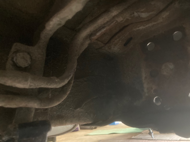

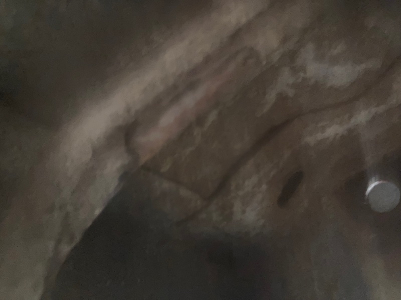

Before I go and snap or rupture pipes, this is what I’m looking at. I’ve gently prised at these and they are not going anywhere from what I can feel, not sure how I’m meant to bend these out of the way? You can also see where the old hanger was clearly up against one of the pipes, where it’s not covered in nearly as much grot as the rest of it.
Still can’t quite see how you tell the difference in the sides for the front hangers either, they look identical to me!

Undo the pipe retaining clip and see if you can get more movement.
- Stu
- Posts: 7111
Been trying to do that, but it’s rounder than Big Jack McRound at a Round Convention.
Options:
Hammer a 6 point Metric equivalent socket on the retaining bolt and hope for the best, understanding that you may wring its neck (not all bad...).
Use something like a wooden handle to try to bend the pipes out of the way for clearance.
Notch the Hanger Bracket for clearance - there is plenty of meat on those.
Bite the bullet and rip the pipes out and re-pipe....
Go to the Pub....
Go to the Pub....
Can you grind the bolt head away to release the pipes? Bit of wood against the pipes and carefully tap them out of the way with a hammer.
