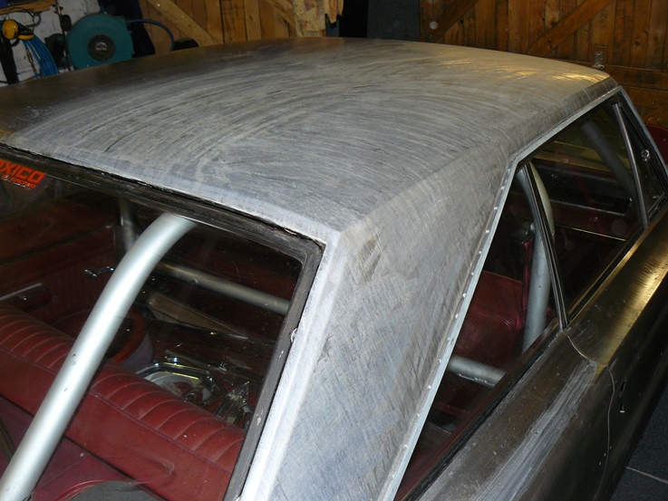

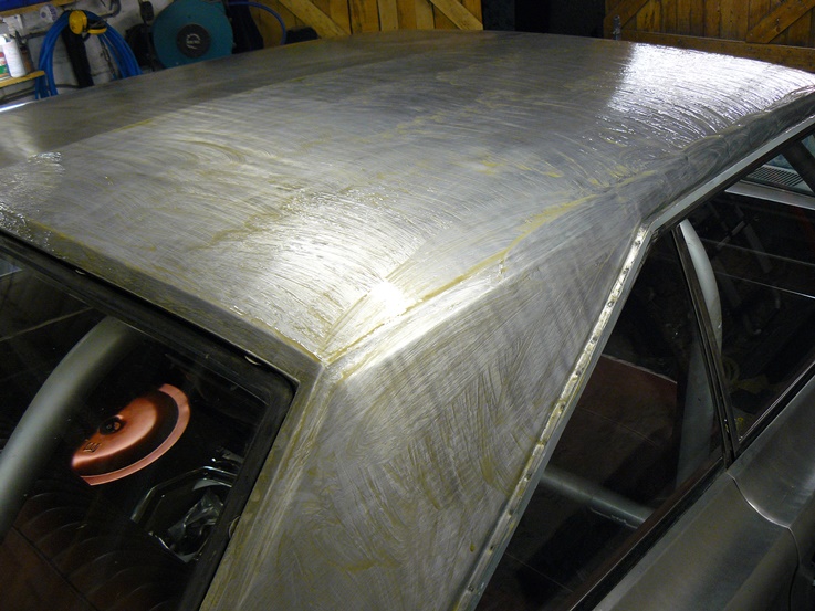

Diverted off the repairs for a day and started on the rust-killing.
I hit half the roof with De-ox for an hour or so, then drenched it in Por 15 for another hour. This thing ain't gonna rust for about 150 years :P
Roof 02.jpg (185.4 KiB) Viewed 855 times
Roof 01.jpg (171.31 KiB) Viewed 855 times

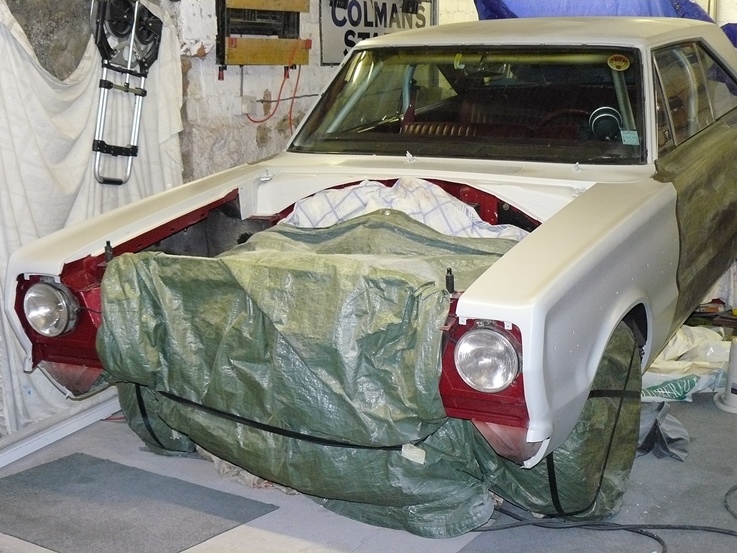

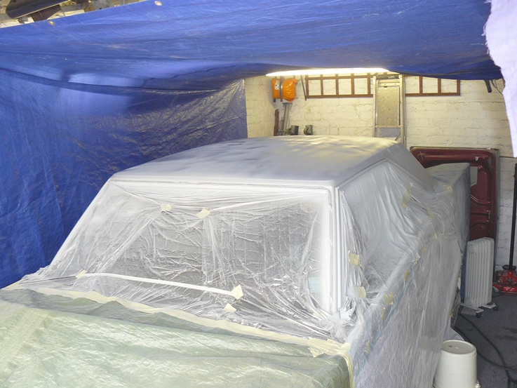

Roof primered!
Belve roof primered.jpg (204.27 KiB) Viewed 1050 times

Cool spray booth :thumbright:

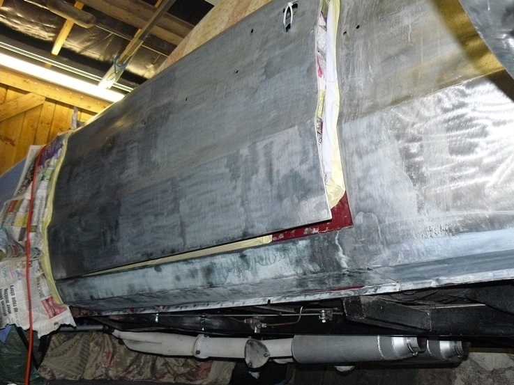

Proud of my little repair to the passenger door and fender :D
Pass door and fender leaded 4.jpg (191.85 KiB) Viewed 989 times

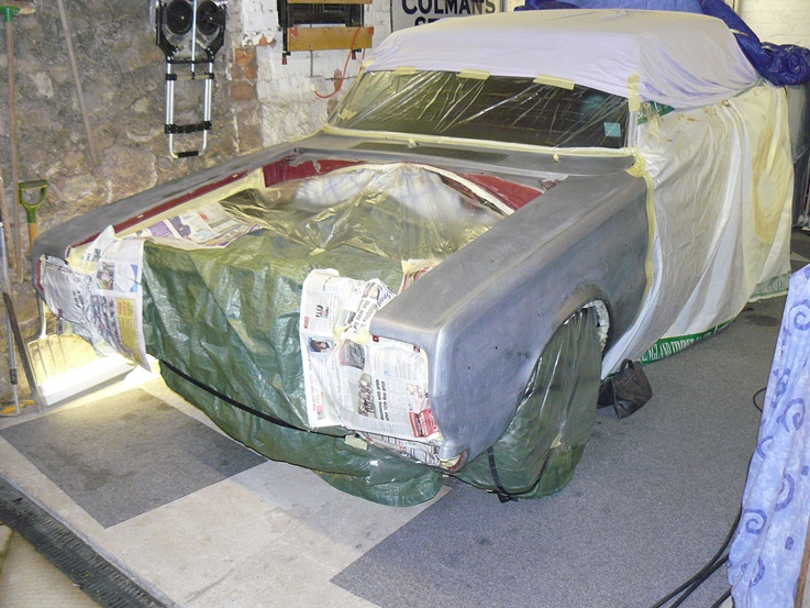

Front end now prepped and ready for primer
Front end ready for primer 5.jpg (212.14 KiB) Viewed 988 times

Front end primered.
4 coats on and it's come out a lot smoother than the roof!! Practice makes perf... well, slightly better :thumbright:
Lots of suicide bugs though :?

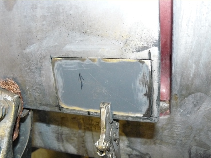

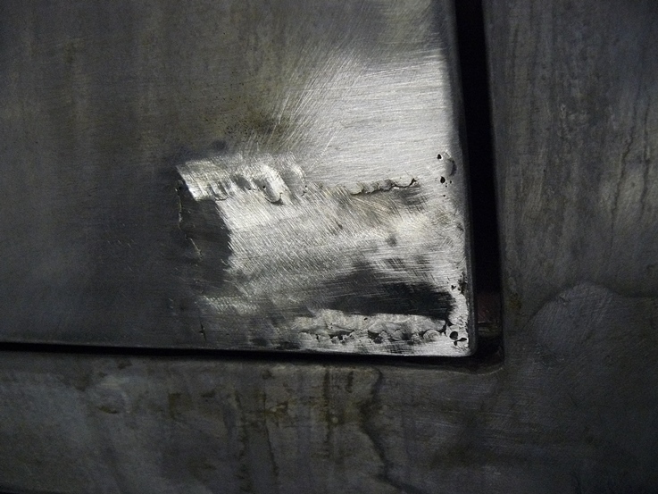

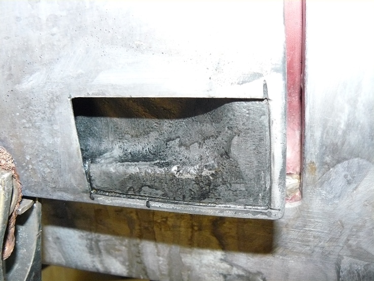

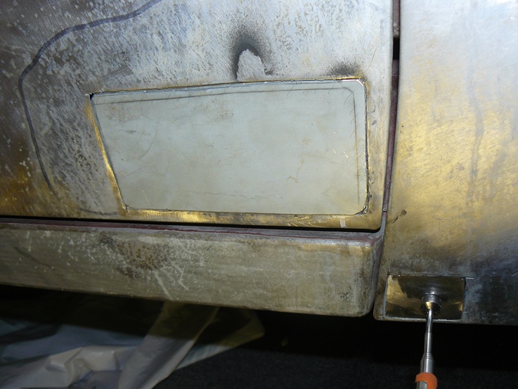

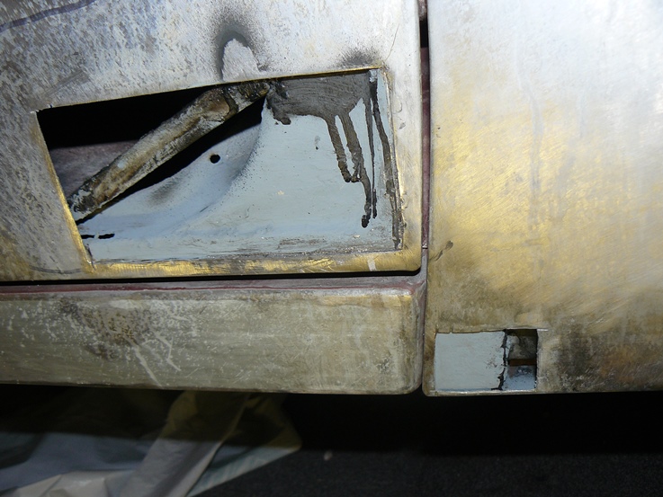

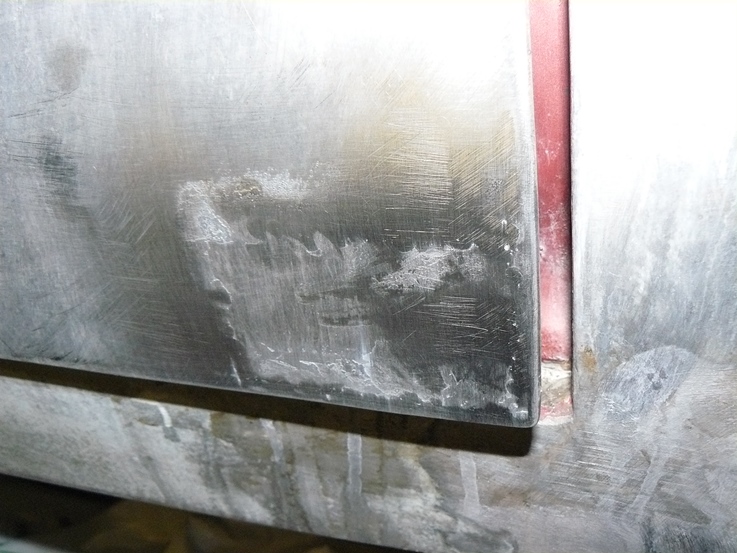

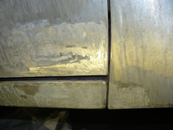

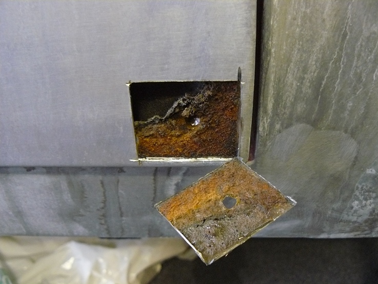

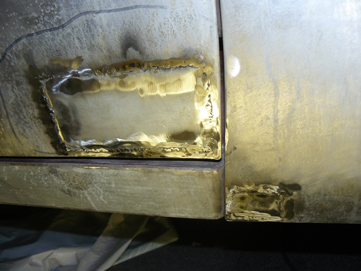

Been tackling the drivers door the last couple of days. I poked at a pinhole in the bottom rear corner and a hole opened up! Good thing I'm poking my Dremel into ever speck of rust on the whole car!!
Driver door patch made.jpg (198.74 KiB) Viewed 901 times
Driver door rust gone.jpg (200.48 KiB) Viewed 901 times
Driver door cut out.jpg (187.68 KiB) Viewed 901 times
I'd masked it ready to primer then decided to hit the sill at the same time.
My patch-making, welding & leading are definitely improving, this is all good practice for the rear arches :thumbright:
Driver door & sill zinced and ready for primer.jpg (227.55 KiB) Viewed 896 times
Driver door leaded.jpg (194.81 KiB) Viewed 896 times
Driver door welded.jpg (208.79 KiB) Viewed 896 times
Brill work as always.
Keep the pictures coming love it :thumbright:
Cheers Will!

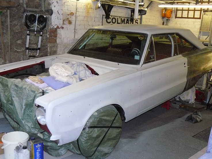

Got another panel finished :D
Learnt a lesson in spraygun hygiene- The primer was coming in spurts (no sniggering!) for the 1st coat.
I stripped the gun, poured out the primer into a jug and put it back in the pot through a sieve. The next coat went on smooth as anything!
Driver door primered.jpg (224.5 KiB) Viewed 849 times
Looking great Paul.
BUT ....... I'm gonna miss the bare metal look ! :cry:
Me too mate but I won't miss scrubbing the rust off!!
