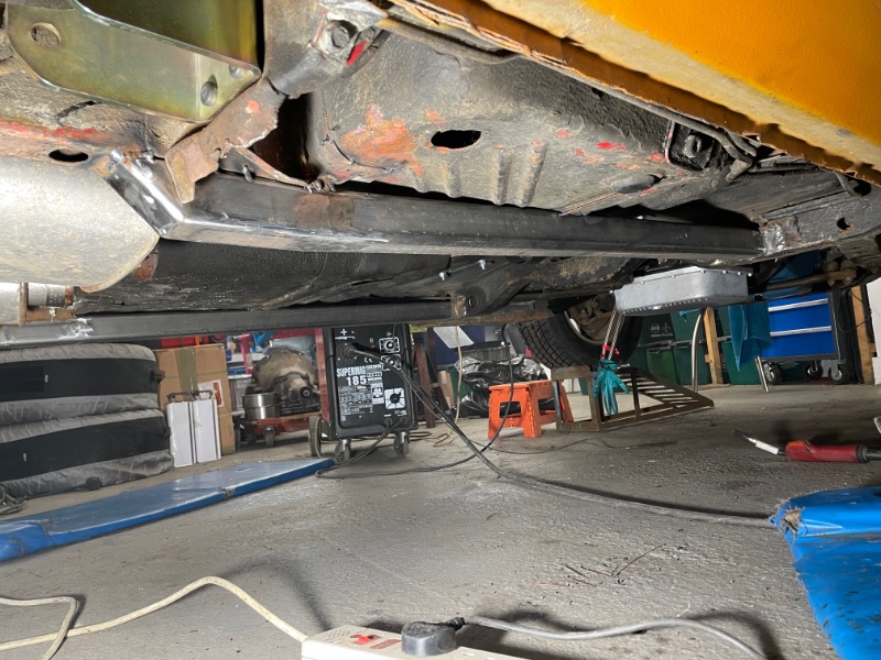

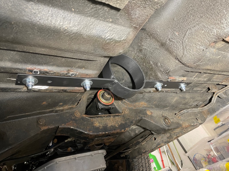

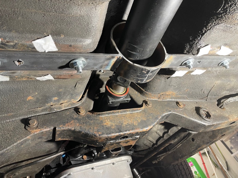

Prop loop made and fitted, bolts are tacked in from the top for easy removal. I consider this an essential if you are going down the track, certainly saved some damage when my yoke let go.
Posts: 6740
Good idea on welding the bolts, saves struggling when trying to take it off in your own :thumbright:

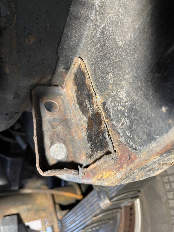

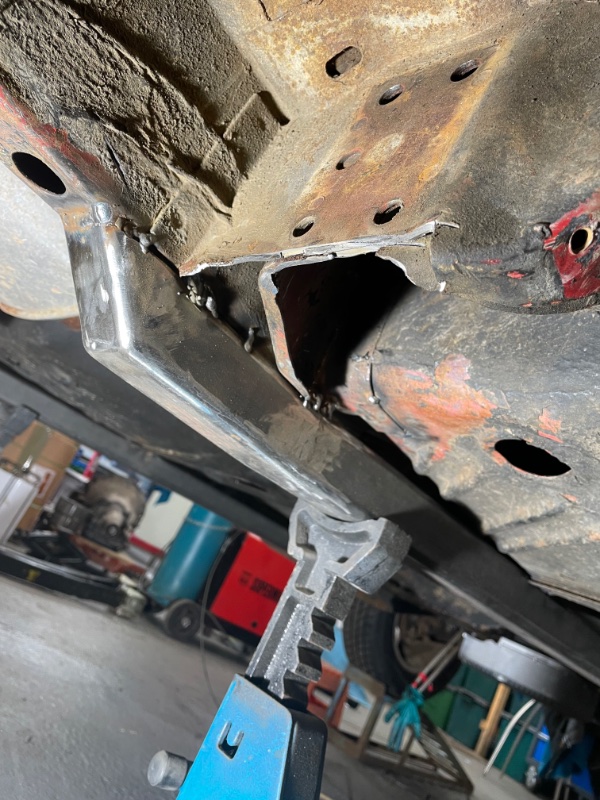

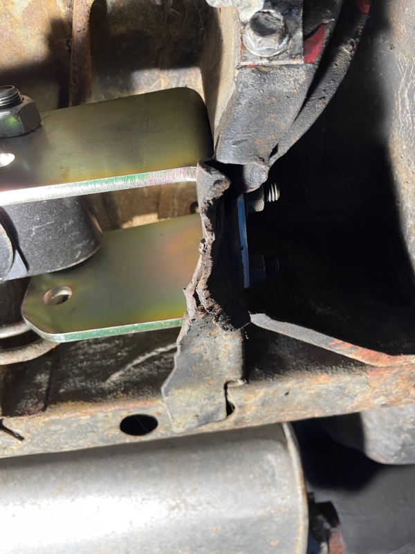

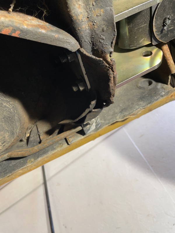

It’s a nice rust free car but it has been in the wars as it turns out. Rear drivers chassis rail had taken a hit and was properly mangled. Section cut out reworked and welded back in, still looks a bit Frankenstein until I properly Bananarama!.

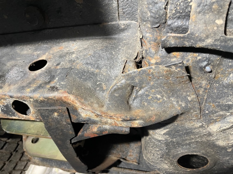

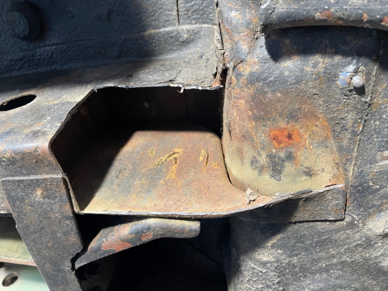

Floor pan and handbrake cable mount both split..

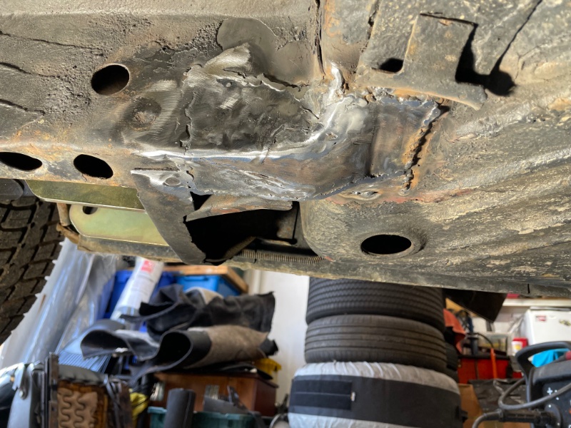

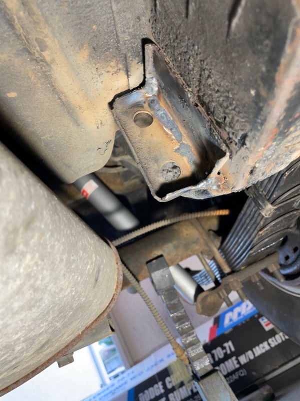

Passenger side spring mount has also taken a hit so that will be attended to in due course.

Chassis ties in, spring mount damage to fix next.

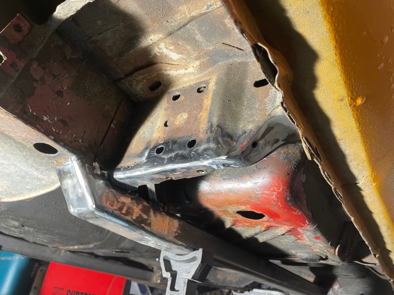

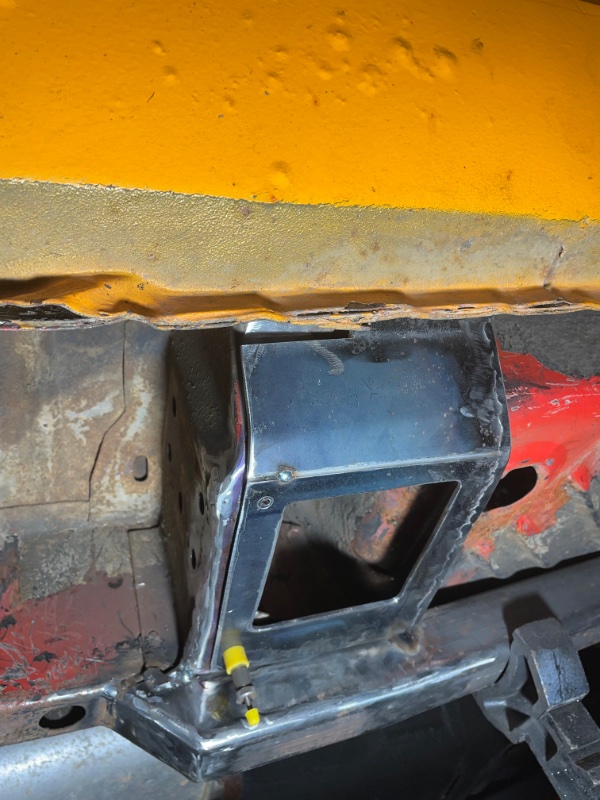

Damage chopped out, bashed straight and welded back in. One Torque box made, just needs final trimming before welding in.

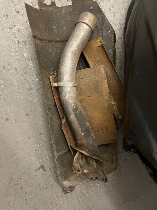

Removed a bit of dead weight…
