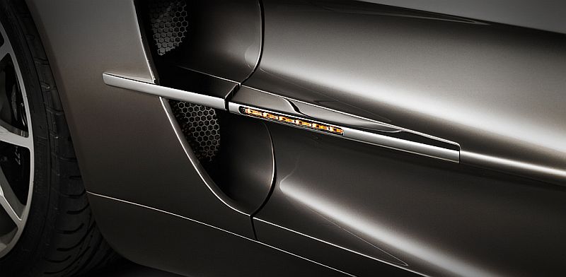

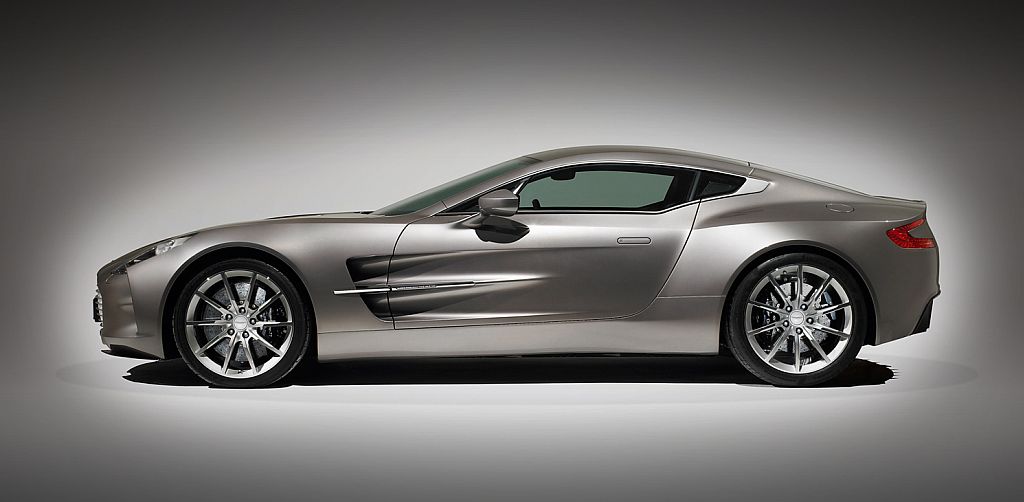

Aston Martin's £1.2M version of the Corvette. :lol:
:lol:
