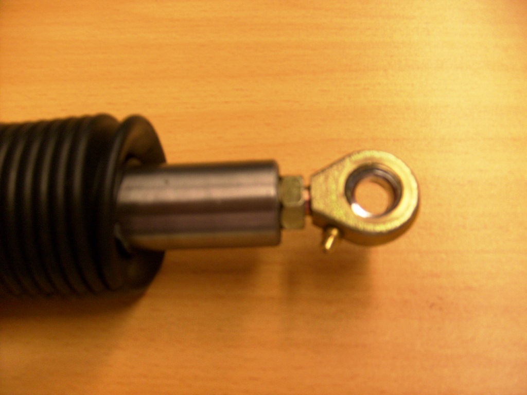

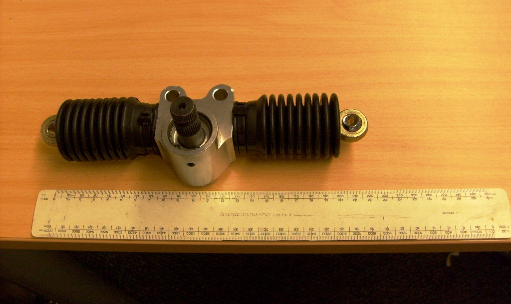

New steering rack
Only 9 inches long and weighs less than 1 KG
Will drill and tap billet to take new 3/8 male rod ends.
Tie rods will be home made from tube with female nut inserts for each end.
Steering arms will be super short from hub centres to get amount of wheel movement required.
Aiming for 3 KG for tie rods / steering rack / support brackets / steering colomn / UJ ( compare that to your std Mopar weights )

That's just incredible...just need some really long track rods now! :D
Jon Connolly wrote:............Only 9 inches long and weighs less than 1 KG
In your dreams!!!
I bet that is lock to lock in about 1 turn!

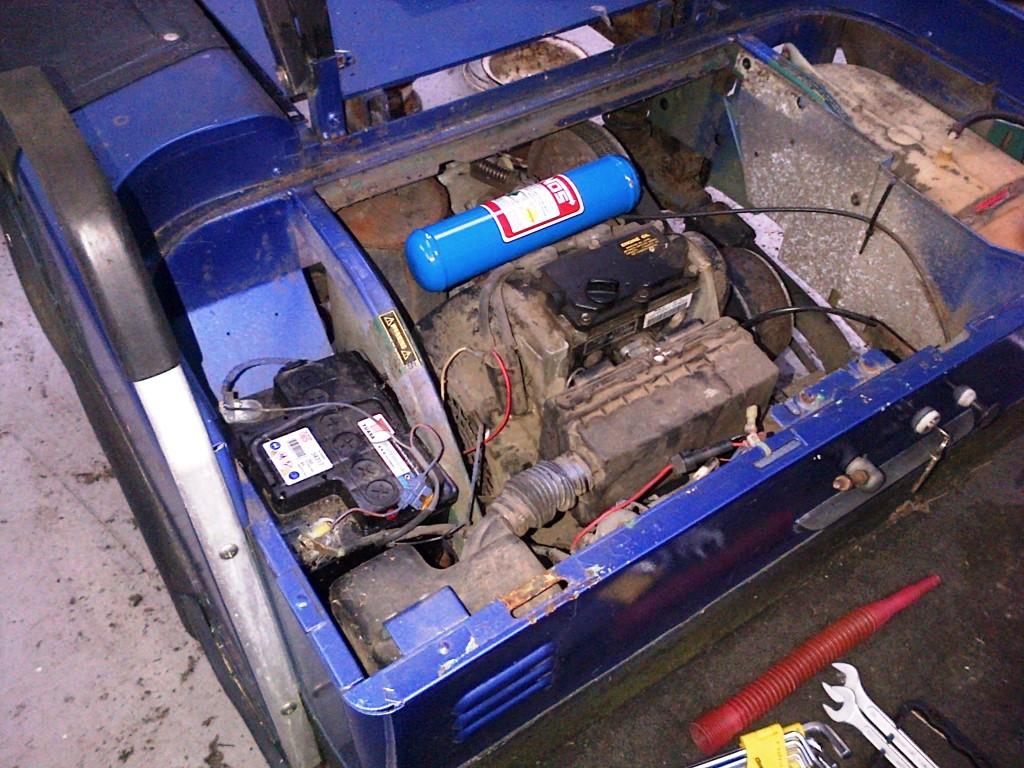

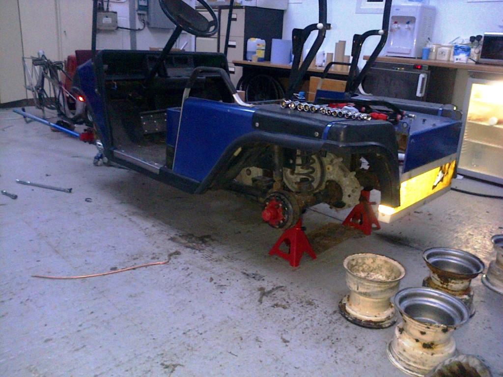

Just finishing off the tow cart for the car ( will never have to walk to the bar again ;) )
New wheels / tyres / tubes / seats etc and a bit of engine work
