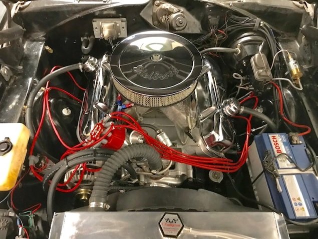

So - Pic1 shows the current state of play.
In a nutshell, it runs and drives. Sorting the niggles list but there are one or two other bits that need more thought. Most of all she needs some MILES. I have to do carfest north in a couple of weeks and I dont want it going 'phut' on track !
'Areas for attention' that I will sort over the coming days. I dont want to do ANYTHING that causes more big hassle !
- Steering box almost there. Very light now and *minor* pull but SO close. Fiddling...
- Throttle cable and lokar. I am running a fairly flimsy bracket and the throttle cable is from the orig 318 - too short for this high manifold.
- Adjust lokar once throttle sorted.
- Heater matrix - I just looped the coolant. Its fine, I dont care, but a neat flow return ubend on the water pump or something.
- Paint on the inner wing - brake fluid leaks show the orig car gold ! oops...
- Nicer rad hoses.
- Trim the plug leads properly. Also replace the remaining straights with 90deg plug boots. Why do BB mopars have straight leads ? They rub and pull off. Unless you want them off, in which case they are welded to the plug, obvs.
- Fuel lines - I run them out the front (deliberately, I made the fittings) due to rear facing pipes being miles from fuel pump. I actually think I want to run it backward now and onto the wing back to the fuel pump.
- Fuel tank and bigger fuel pipe. She is still running 5/16 fuel pipe. Should be 3/8 min maybe even 1/2. So this needs doing, but I need to change the sender with it. So I may as well change the tank (go new one from Will to go in) etc etc. Not pre carfest.
- Trans cooler - I have a separate cooler and I HATE my trans pipes - I need to get some flexis made up with appropriate fittings. I may do this before carfest.
- Headers need even more clouting with the persuader. I dont THINK they are touching torsion bars now, but then I have not given this motor the beans yet and I have not fitted a strap.
- Earthing. Needs to be a bit manlier really - need to find a bolt into the block rather than through the rocker bolt. It runs, but not ideal.
Fettling. Hopefully.
More extensive road trials this week... pics will follow as I tick this stuff off and it all looks a bit better/neater.

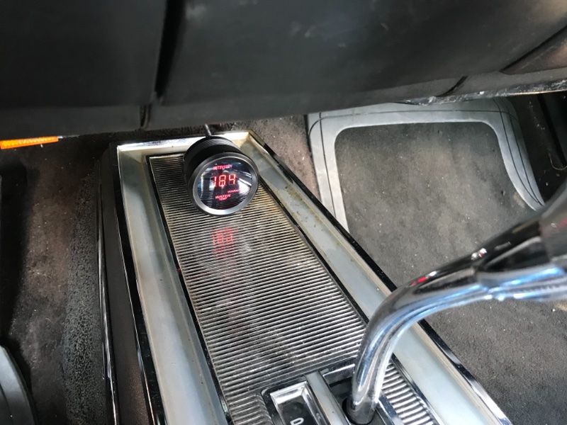

Didnt like the readings new sender and old guage were giving so decided to retro fit electronic.
Obviously i will hide it soon, but for now...
seems to hold ok. 185 ish cruise. 205 traffic. I need to do the ‘standing for 30 mins’ test...
