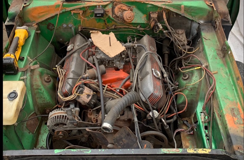

Okay guys now I’m asking for a little help! Is there anyone around Dartford that could help me work out a few things with the engine on my car? Or even advise here on this thread?
I am completely new to carbs and a few words of advice here would be great….
The charger was originally a 2BB car but it seems someone has installed a 4BB carb on it at some stage. I have now installed the fuel system. I heard the car running when I purchased the car but have not done anything with the engine amd drive train since Iv owned it. It has all new plugs on it except one which I will get too. When I heard it running it was backfiring but otherwise sounded quite healthy to be fair. I I’m hoping the backfire was to do with the plug that needs changing. There was also a fair amount of oil leaking.
I need to work out how to hook up the carb and get her running so I can figure where I stand with it. What’s good, what’s bad etc. I can even see a brand on the carb so if anyone is familiar with or please advise what I have.
A picture of the engine bay attached. I will take any advice, recommendations or views at this point. I’m completely new to the mechanics on these cars, so go easy
