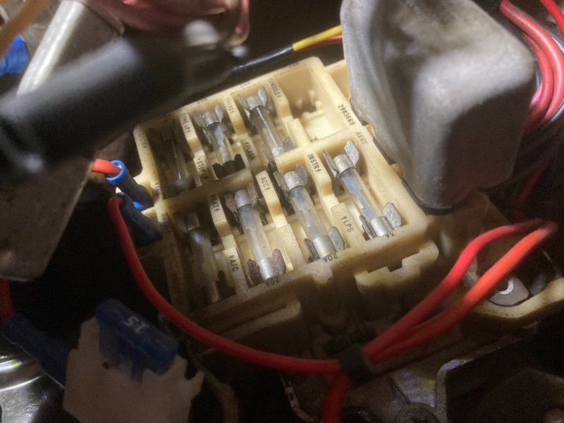

Assuming top right is the instrument cluster, fuse is intact.

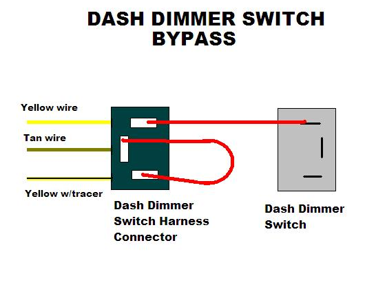

if you want to just not have a dimmer
try below. just link two sections on the connector that hopefully you find lying in the bottom of the dash
dash lights will be full on. when lights are on from now on....
and miss off connection to dimmer switch.
can't think it does anything other than activate dome when wound to 1 end...
instead of taking it to you none exsitant dimmer take it to a standard 2 conector switch with the other switch connector connected to earth i.e its mounting
i belive earthing this cable via a switch will switch on the dome light
hence you keep the ability swich off and on dome light when you need to read a map, on a dark night and have not got your phone
all you will then be lacking is the ability to set dome light to an "atmospheric level" when entertaining
or we can come up with a dimmer from maplins/rs/farnell that will only act on the dome light just need a potentiometer to fill the hole in the dash.

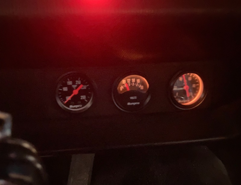

After a real Bananarama! of a week, I needed a bit of success, so pleased to say that after another morning of lying upside down on my neck, we have success. A gentle glow from the gauges and voltmeter now working.
Colour wiring diagram should arrive during the week, as will my tach dash mount and cup, so hopefully next weekend will be out for a cruise.
I’ll hopefully get time to digest all the above and get the rest of the panel lights working in the next couple of weeks too, thanks Chaps. :read2:
