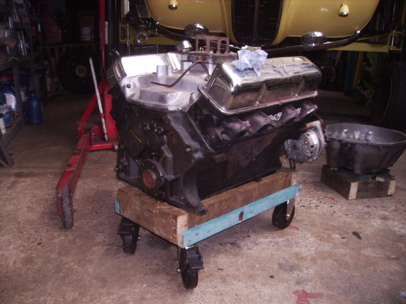

though not as heavy as most this fe engine is still too heavy to drag across the floor. so to get it out of the way of this pop ute so that rover can be lifted out today we knocked up a dolly from 4x2, 2x1 and some butch 4" castors. the engine sits in the 'box' on it's sump rail so can't move about and it'll probably fit most other v8's i'm likely to need it for in the future.
neil.

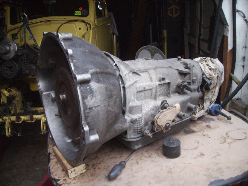

and there it is finally. the convertor goes all the way in 'til it bottoms in the pump and it still clears inside the bellhousing, woohoo!
neil.

today some measuring and calculating took place. i know the convertor 'nose' is smaller on the 4r70w than the fe, in fact all ford's are 1.375" while just the fe is 1.850". so i knew a spacer ring needed to be made up on the lathe, no problem. what i didn't know until now was what if any spacers would be needed between the flexplate and convertor. it measures at 5mm only so the studs on the convertor are long enough for that no problem. that's with the convertor 'pulled' 3mm out of the pump so it's not bottomed out. so, only 4x5mm spacers/washers and a spacer ring for the nose and it can all bolt together for the last time.
neil.
