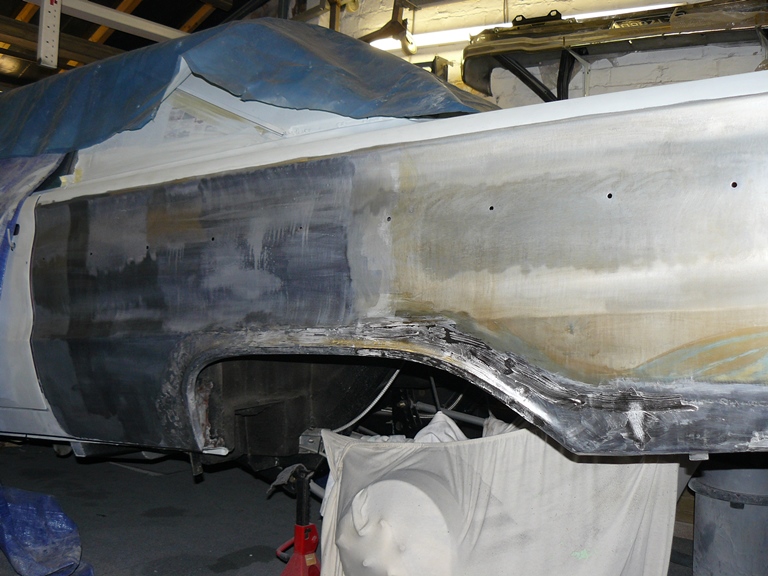

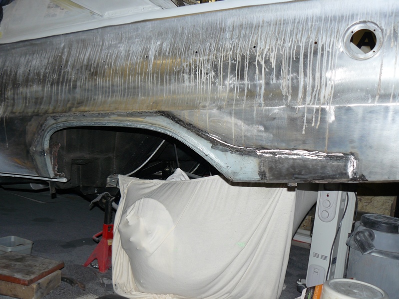

I've finished welding the outer skin now. I've zinc sprayed it too.
More pics to follow once I've persuaded my camera to let them go...
Welding finished.jpg (218.63 KiB) Viewed 957 times

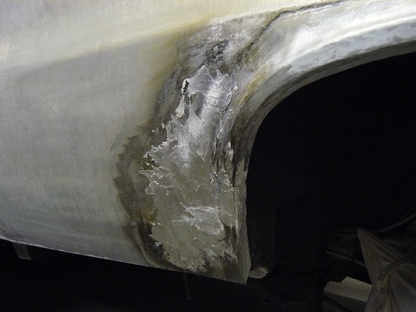

I had to weld in this little slice of metal to correct a minor cock-up :roll: But I'm happy to report you can't even see the join now :thumbright:

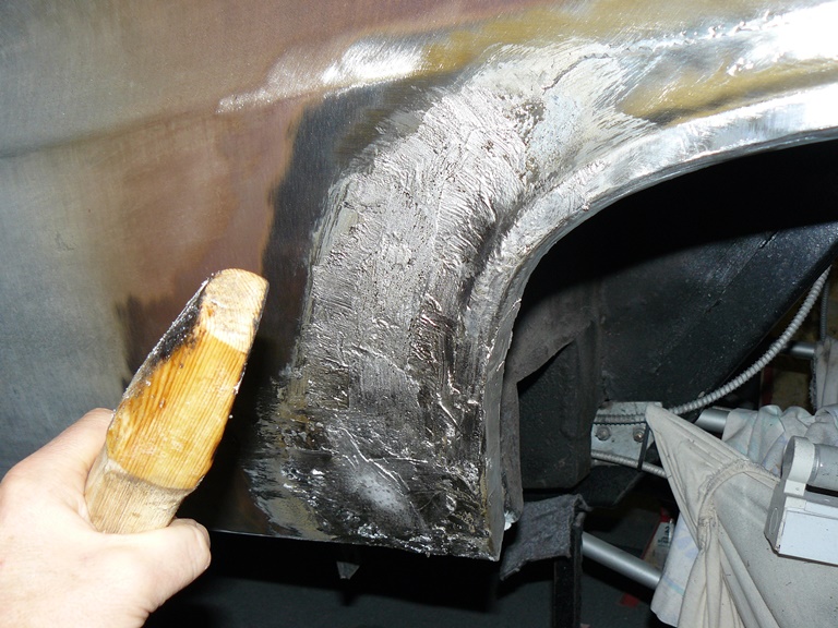

I've laid on the first bit of lead this evening, very satisfying :D
Wheel arch. 1st bit of lead.jpg (217.45 KiB) Viewed 852 times
Wheel arch correction.jpg (223.65 KiB) Viewed 852 times
So, that was a fine example of how NOT to do leading...
I wasn't happy about the way it went on so I poked the edge with a chisel and a strip of lead peeled right off :?
I eventually sussed it was because the new panel section is zinc coated and lead DOES NOT LIKE ZINC!!
I melted all the lead off again and ground all the zinc coating off.

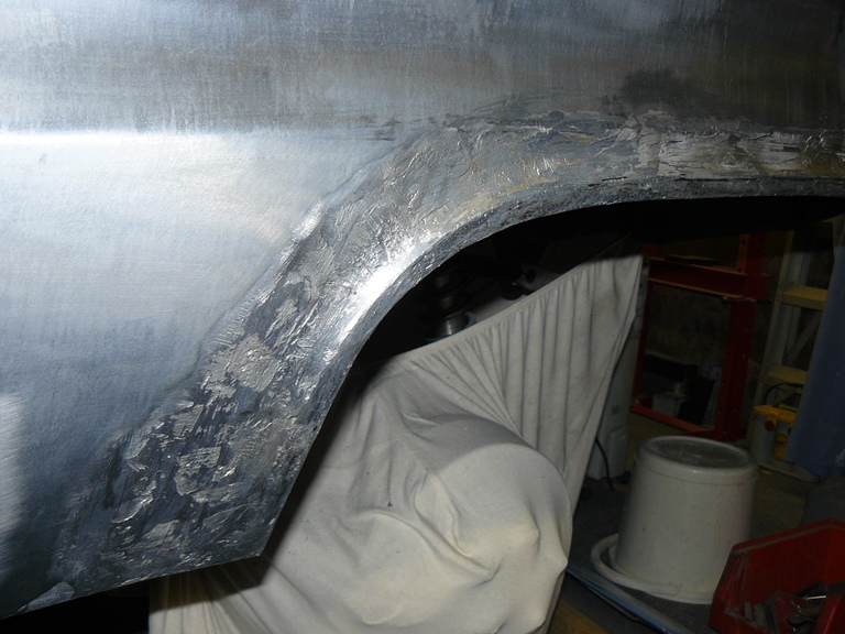

My 2nd attempt was a bit more successful :thumbright:
I also made a much better wooden paddle which made shaping the lead easier.
If a had a proper body file and a lot more lead, time and patience I reckon I could get this good enough to virtually eliminate filler but I don't and I ain't so I wont :P
3rd pic is after filing off the high spots and is virtually ready for filler!
Wheel arch, leading, nearly there.jpg (176.74 KiB) Viewed 798 times
Wheel arch, leading, I'm winning!.jpg (206.16 KiB) Viewed 798 times
Wheel arch, leading 2nd attempt.jpg (198.9 KiB) Viewed 798 times

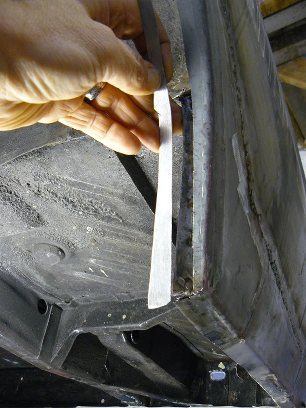

Last bit of weld covered up and the edge is all built up nicely now. I may fill it in some more but I don't NEED to put any more on this side, just the high spots to file down then a skim of filler!
