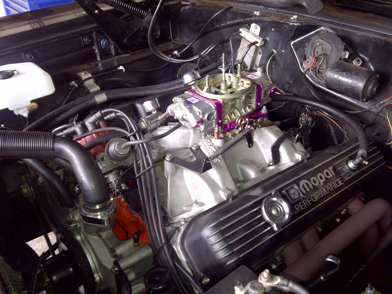

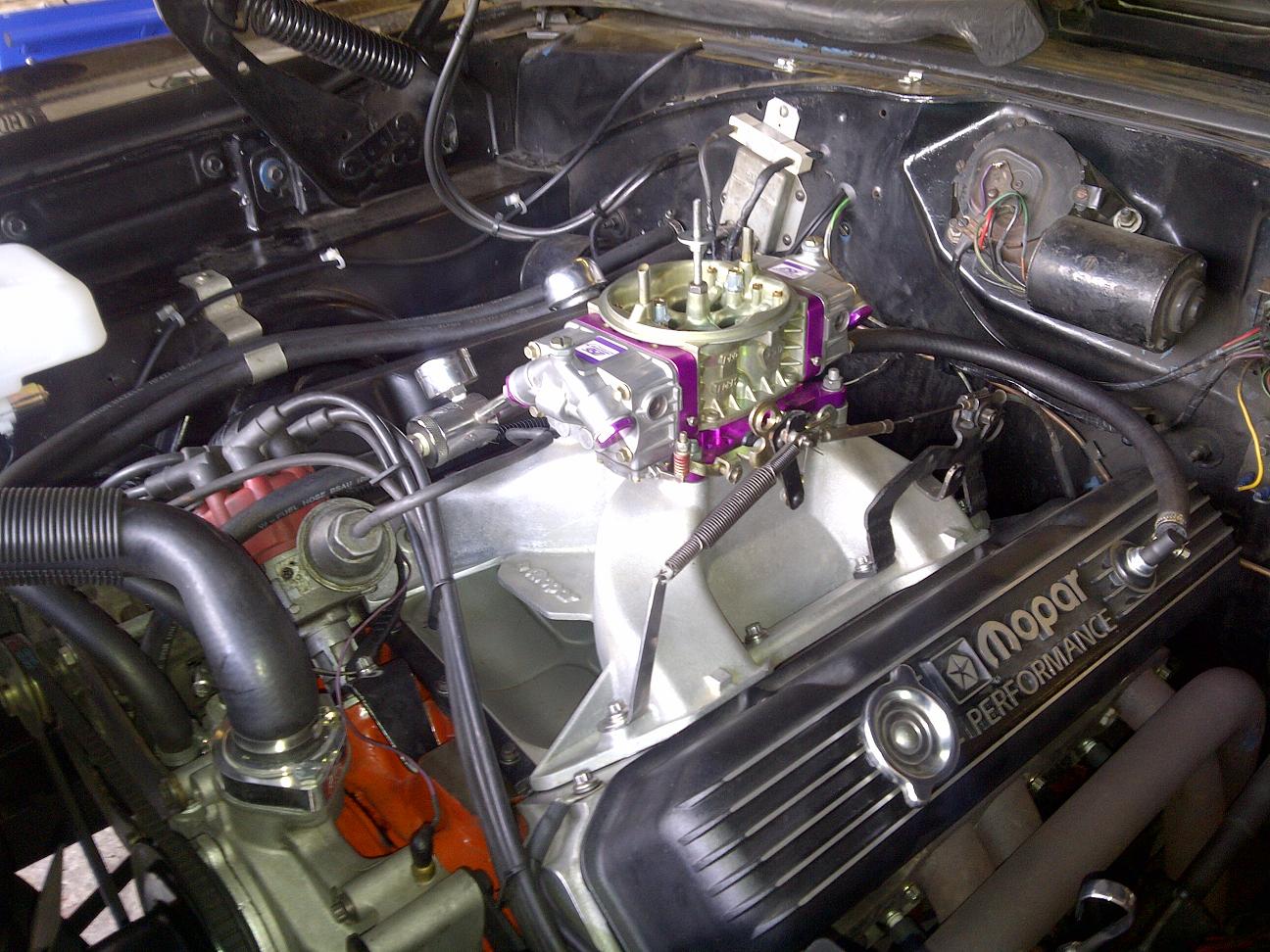

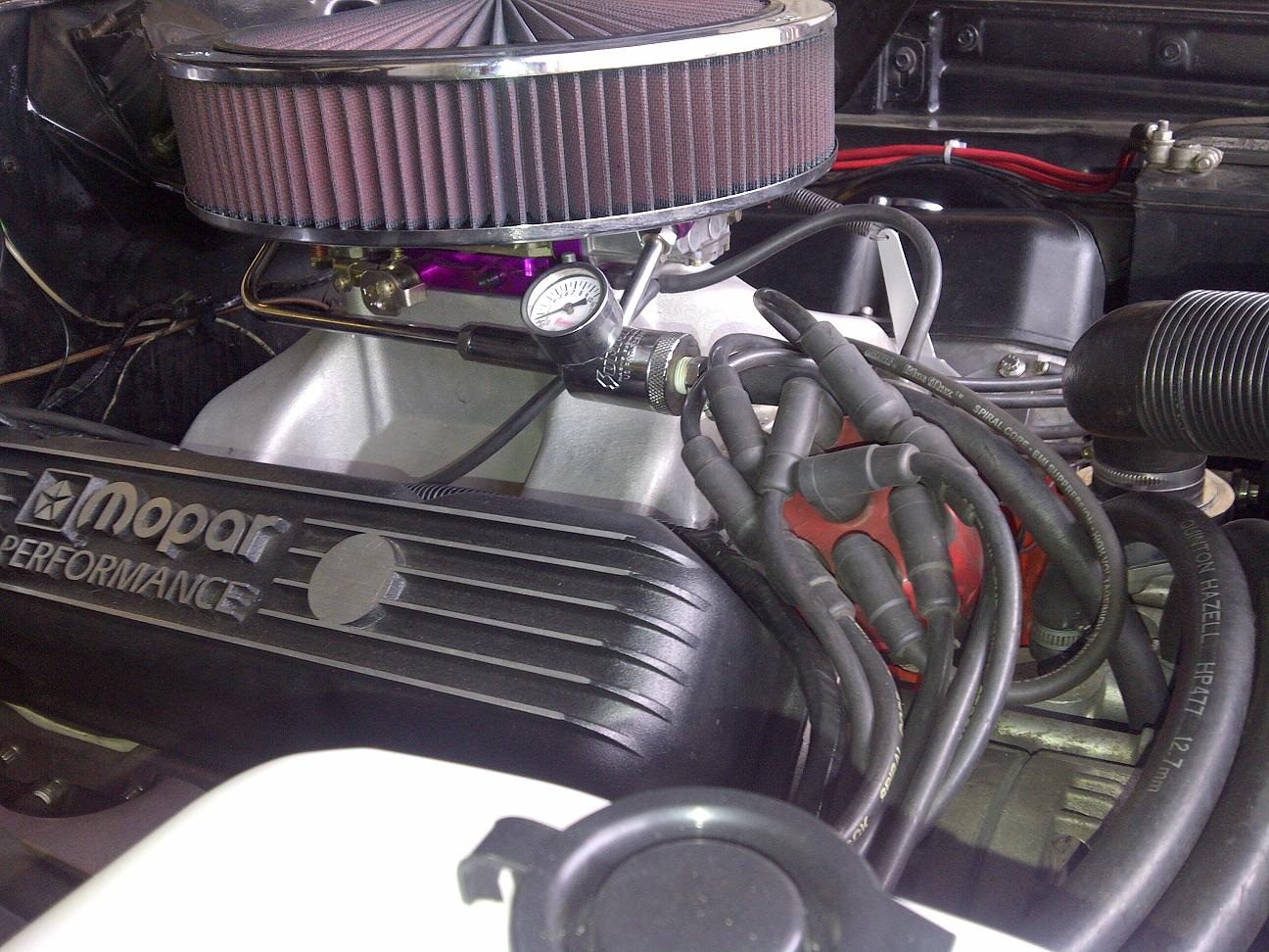

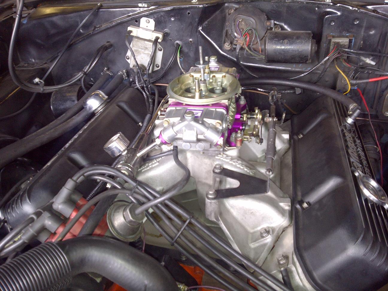

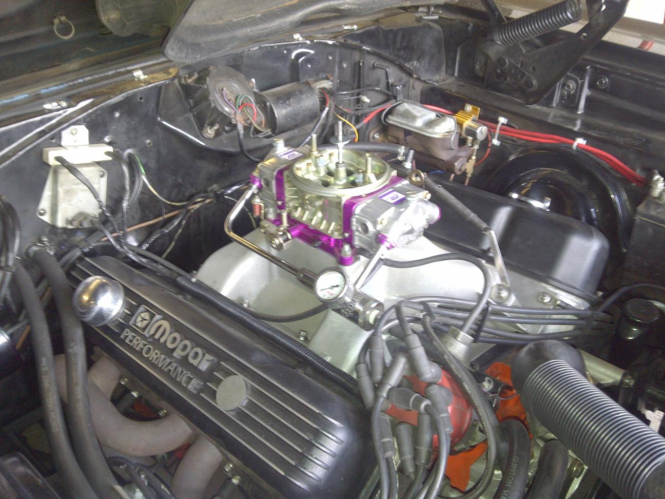

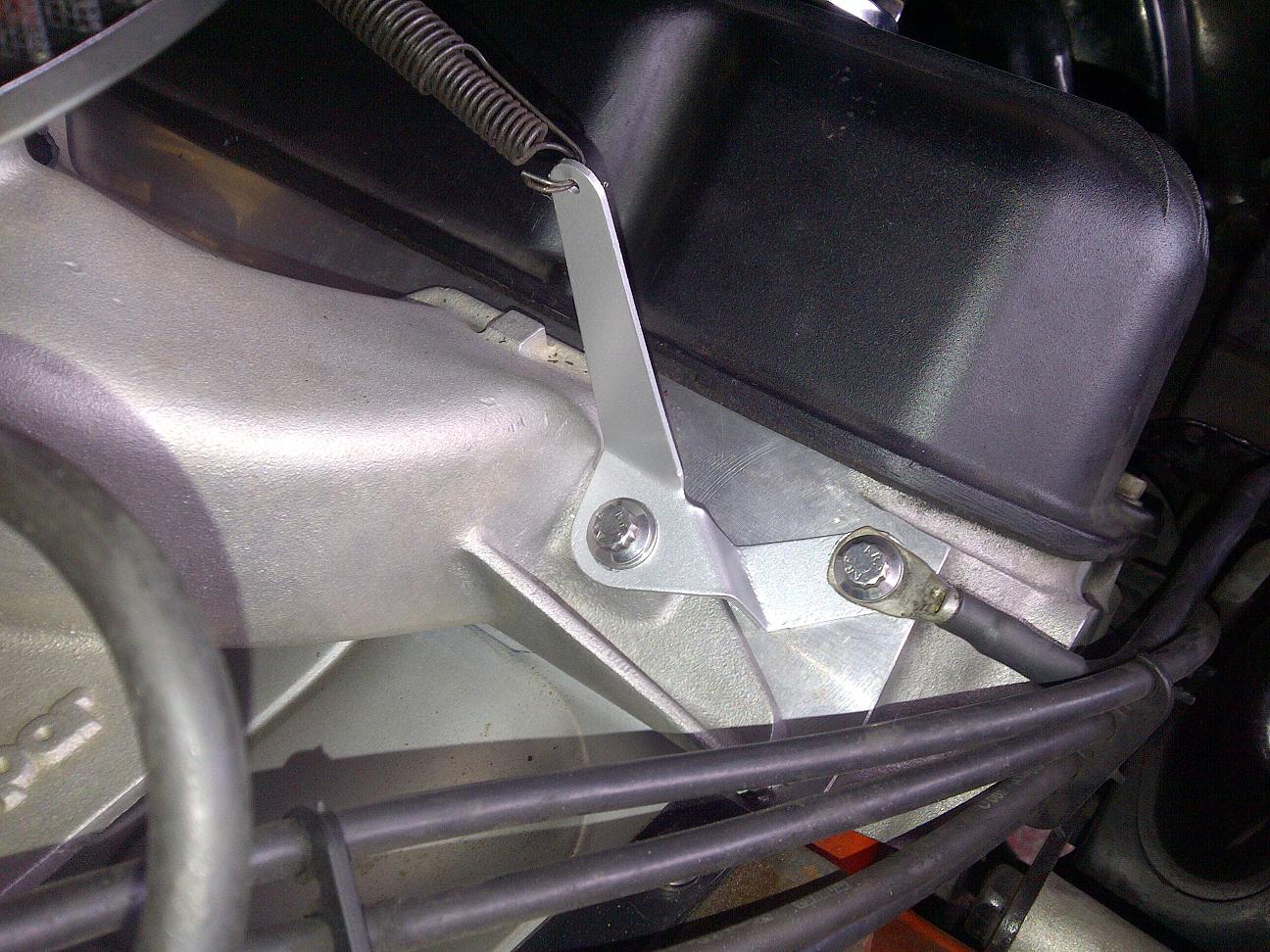

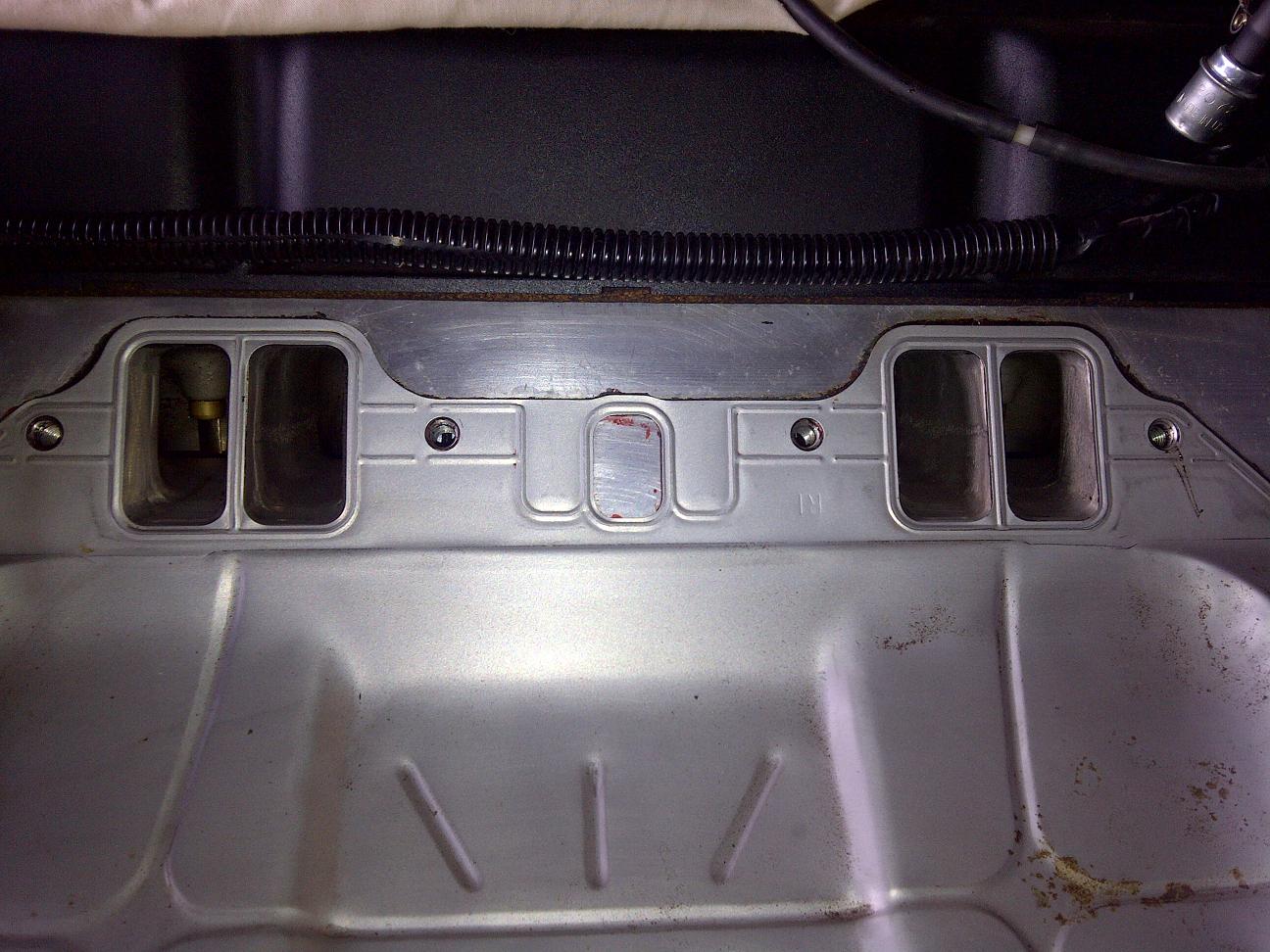

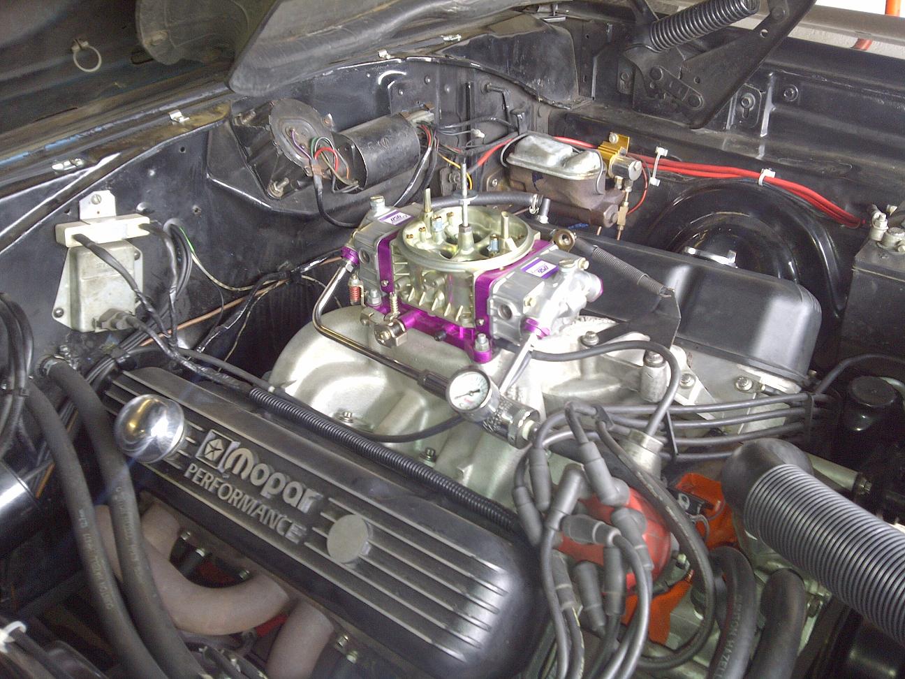

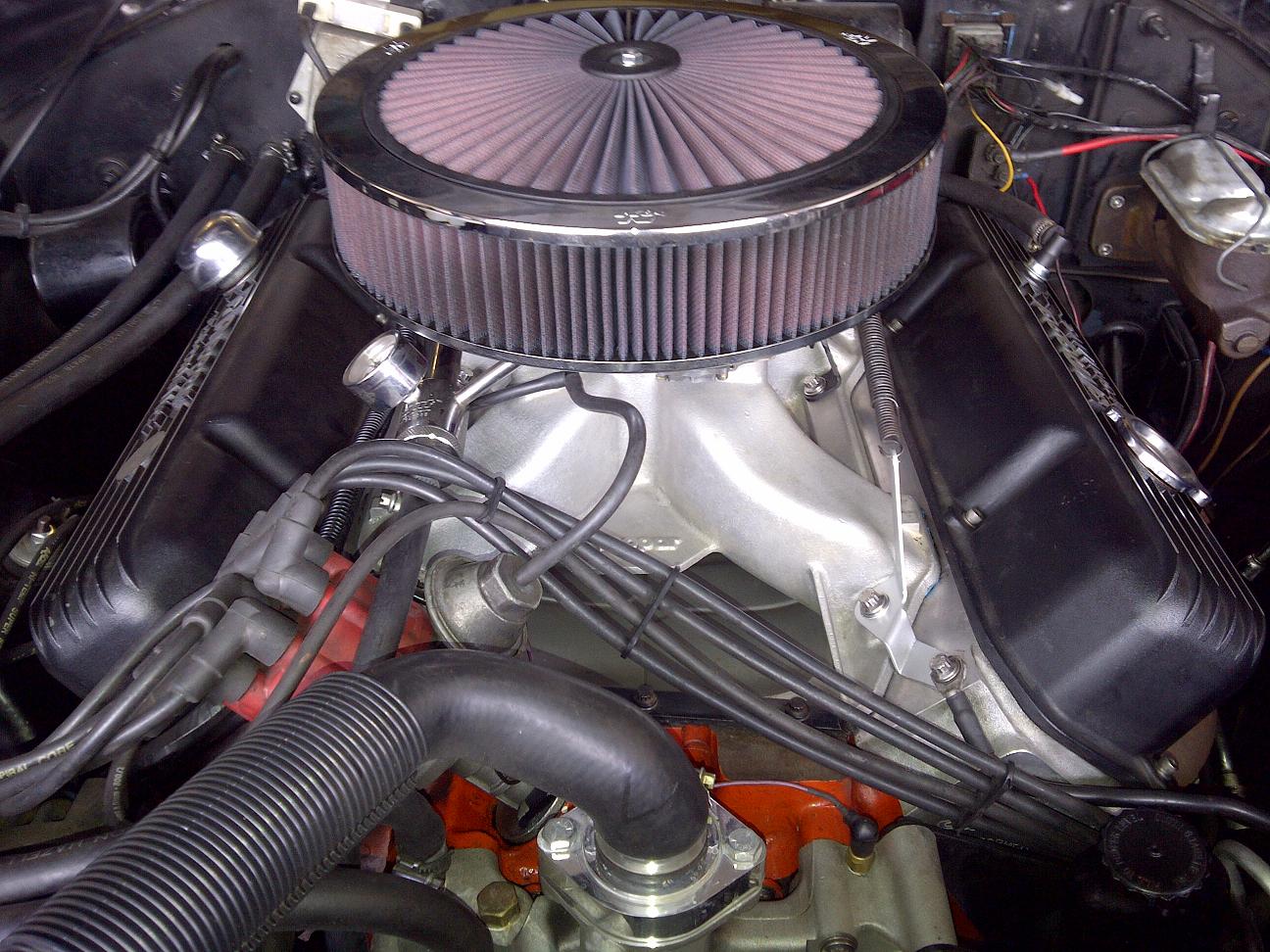

Thought I'd post some phone pics I took yesterday. Decided to fit the M1 intake again. Tried it last year and liked it on the street although it did lose some low rpm torque compared to the Performer RPM. Didn't make any difference at the drag strip at all. Got a different cam fitted now so decided to give it another try. I noticed the front ports didn't line up very well with the heads, I could see the marks left by the valley pan. So decided to gasket match it using a spare valley pan as a template and also did some work in the plenum, radiused the top of the ports and removed some casting flash. Also removed the coil mounting posts because they interfere with the fuel pipe and it looks much nicer without them.
M1 1 s.JPG (196.99 KiB) Viewed 423 times

Few more.
Home made bracket s.JPG (220.03 KiB) Viewed 416 times
M1 4 s.JPG (221.83 KiB) Viewed 416 times

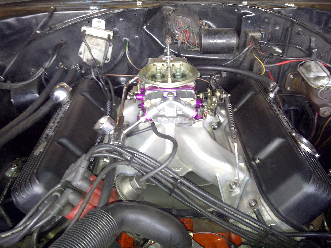

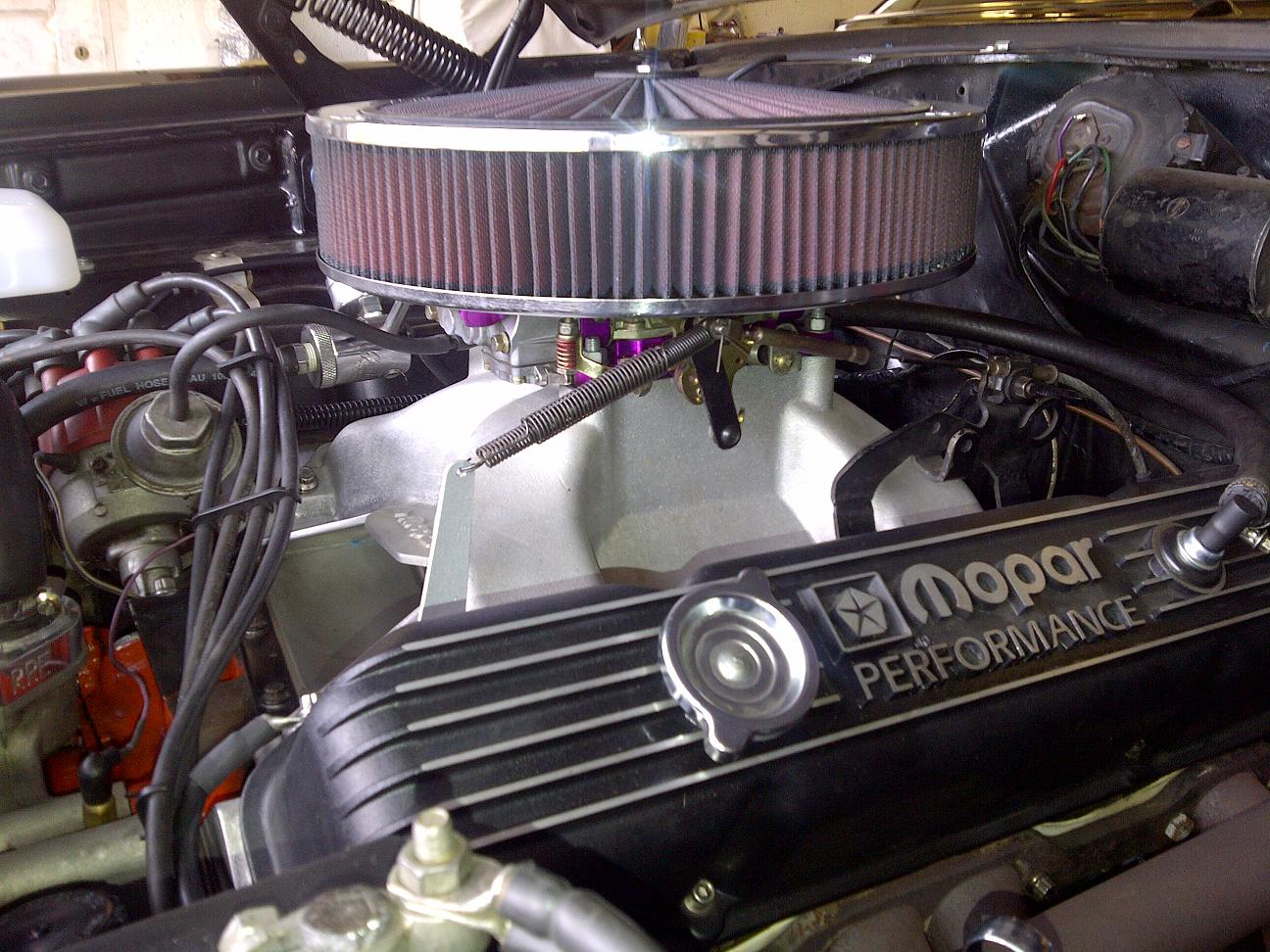

More.
RPM port matched by Edelbrock s.JPG (172.49 KiB) Viewed 411 times
M1 6 s.JPG (205.76 KiB) Viewed 411 times
M1 5 s.JPG (216.71 KiB) Viewed 411 times
