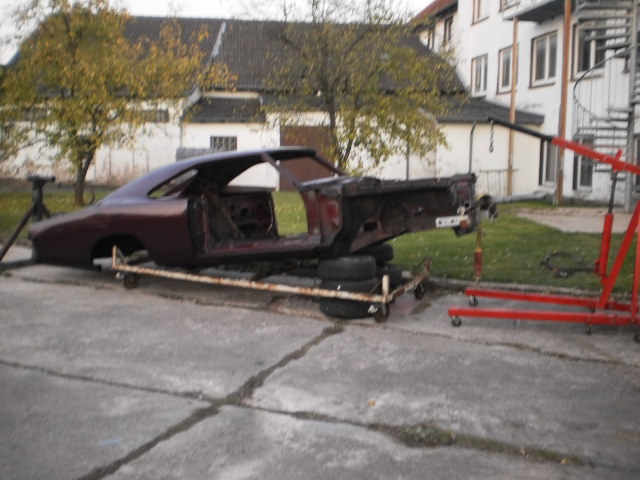

So last night was more of a pain than work.
As my garage is in the cellar i had to build a frame to move the car.
I got it out side and on the rotisserie again.
When i first looked at the under seal it was like concrete but now its had 13L of diesel sprayed at it its really getting softer
I gave it another coat of Diesel last night but was losing the light to pressure wash.

I did wonder how you got it up to rotating height on the rotisserie ?
Infact ive always wondered how its best to do this with out damaging or twisting the body or roof ??

Allkiller = Jack a bit here and a bit there then get some old wheel or stones under. Car is pretty strong as not to much rust. Still a tense moment the first time it flips upside down
