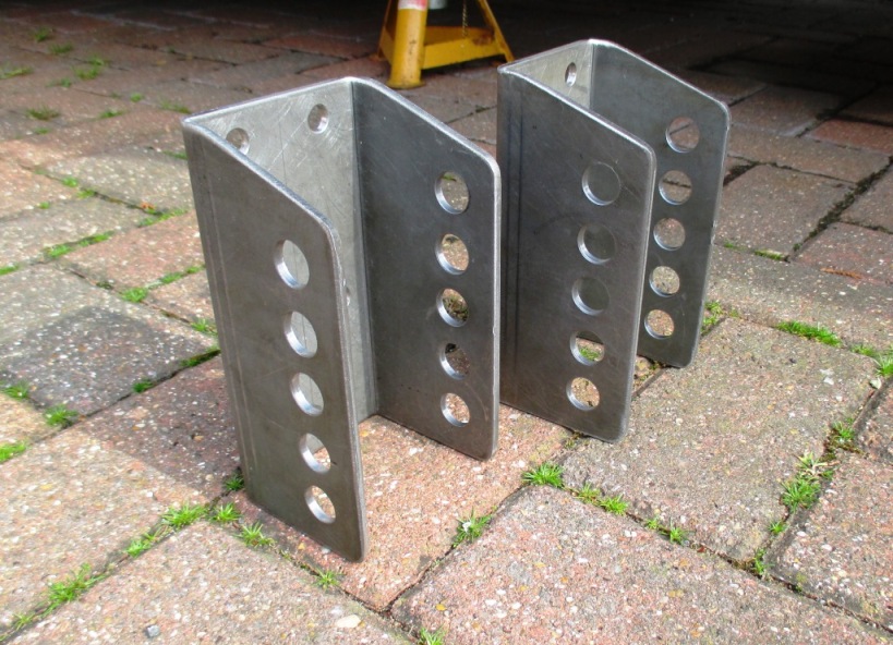

I just want to test the water to see if there is a market for custom front leaf spring brackets to lower and raise the height of the rear end.
Option 1 will offer 2 inch lower position and 1 inch higher position.
Option 2 will offer 2 inch lower position and 2 inch higher position.
Can people let me know if there is any interest a I can get a better price having multiples water jet.
They will be around £80 a pair to your door.

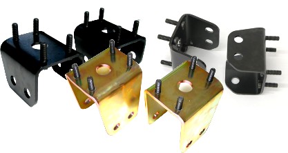

For that price that is a good deal , they do make those but they only have 2 adjustments, and yours has more options,
I wonder why nobody has made these after all these years :-k

Its already out there Anton :thumbright:

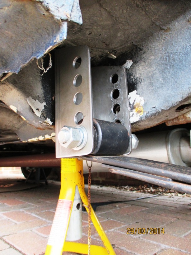

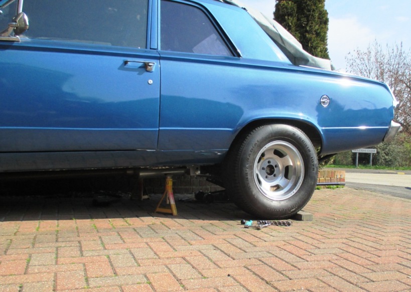

To get around my ride height issue and to mock-up preparation for a axle swop, I had contacted Anton to get a pair of hangers made.
They are very well made and are an exact fit. There is plenty of adjustment so has allowed me to set the height I want - thanks Anton :thumbright:
