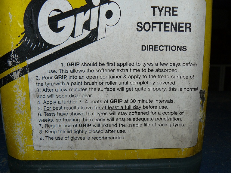

That has helped out a lot in terms of understanding. However, I still think it is predominantly down to the Slicks. I seem to remember that you can buy a product that "rejuvinates" Slicks; is this an old wive's tale???

tyre softener ? in a yellow can
If so Mr Hauser sells it

I knew I had this somewhere but all my books are in a pile in the loft due to me decorating the upstairs rooms. But I just had a good look and found this diagram which I remembered from a book I was given by the old fella that used to own Rodley Motors some 30-odd years ago.
Dave-B made me remember it with his post.
Grip 02.jpg (235.13 KiB) Viewed 1824 times
Grip 01.jpg (202.48 KiB) Viewed 1824 times

Does it work, though?? ;)
Posts: 14459
Yea we always used to use stuff like that back in the 80's, gorilla snot we called it, yes it works.

Used to use grip juice to, the stuff you had to pour on the track after you'd done a burnout then a quick spin of the tyres as you roll through it. Then you ended up with the back end of the car covered in glue!
Oh those were the days!!!
Gorilla snot is something different to tyre softner. It is more like the stuff they prep the track with.
